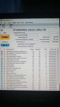

    On the abovementioned disk, when checking Smart using HDDScan 3.3, an error appeared.
    Here is the screen:
    ADATA SP900 SSD: Soft ECC Correction Rate Error in HDDScan 3.3 vs Crystal Disk Info20171117_2..928.jpg (304.27 kB)You must be logged in to download this attachment.
    When checking a disk with Crystal Disk Info, the error does not show:
    ADATA SP900 SSD: Soft ECC Correction Rate Error in HDDScan 3.3 vs Crystal Disk Infocdi.jpg (268.87 kB)You must be logged in to download this attachment.
    Which program to believe more? What is this error?

    There is nothing to check, everything is OK, SMART parameters are normal. If I were a colleague, I would be more interested in the second disc (E, F), which has problems.

    As far as I'm not mistaken, these drives run on Sandforce controllers (the most failing). I suggest not to keep any important data on it, because it will probably fall sooner or later.

    Exactly as a colleague mentioned. A disk with a failure working in parallel in the system may, and probably will, cause problems in the system operation. The failed drive must be repaired or disconnected.

    Sectors are relocated. Can it be repaired or replaced?

    Such sectors cannot be repaired. This is information that they are no longer used. If there are few of them, then such a disk can be used, but it is worth monitoring its health (mainly paying attention to whether the RAW values of parameters 05 and c5 go up, but of course the rest of the parameters cannot be ignored).

    There are 13 of them right now.

    Show the rest of SMART of this disk.

    The disk is not under warranty, because it is an OEM disk (e.g. from a disk bay or from a ready-made computer set). Generally, you can use it, but it's worth watching if its SMART parameters are not deteriorating (especially an increase in RAW 05 and c5 values should be a signal that something is wrong). Of course, it is advisable to make copies of any important data, such a disk should already be treated with a certain degree of distrust (which does not have to mean that it is intended for grinding).
    According to the current data, theoretically, every sector on the disk should be readable.
