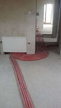

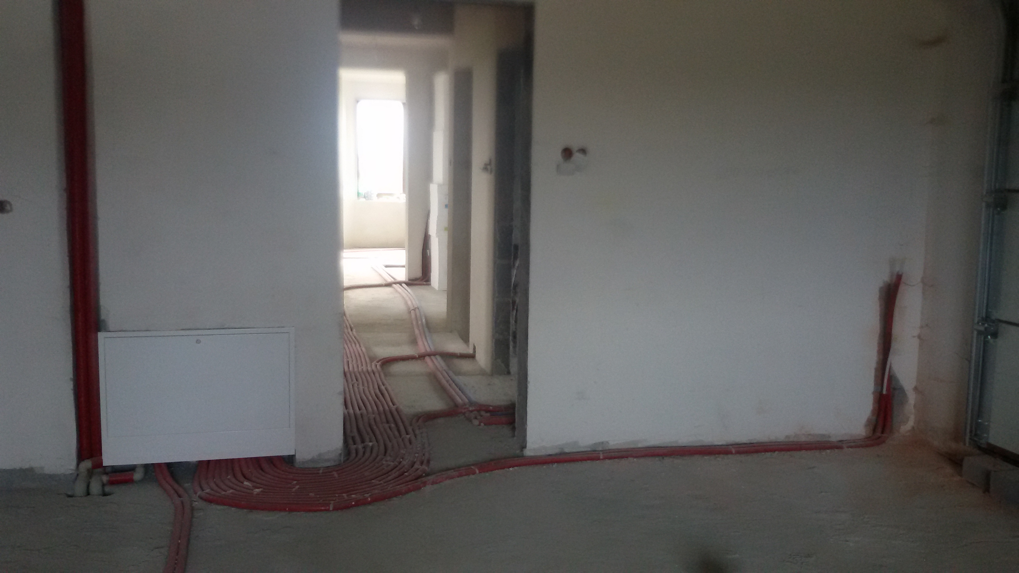

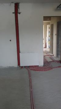

    This is more or less what it looks like from manifolds, it is well distributed only why they gave this plastic and not copper to manifolds and if there is a 4 way valve at the furnace, can something also happen? I don't know how to work abroad and plumbers I recommend that good specialists had to be well done, they let the pipes out of the manifolds into the basement and there is about 2.5 m to the furnace they haven't done this piece yet because they are waiting for the stove
    Added after 4 [minutes]:
    I have it all spilled
    Added after 3 [minutes]:
    Aluminum vs Steel Radiator: Best Company & Compatibility with PEX, Open Installation Furnace
    Added after 7 [minutes]:
    And now what to fight with them that they are badly done and they tell me that it is good and that on the Internet they write stupid things because they do so in all homes and they have no complaints. I don't even know if it can be changed now, but I think the walls are not plastered where the pipes go. I do not know myself and how the furnace will be all copper and only on risers plastic for manifolds is also bad
    I'd rather not touch it

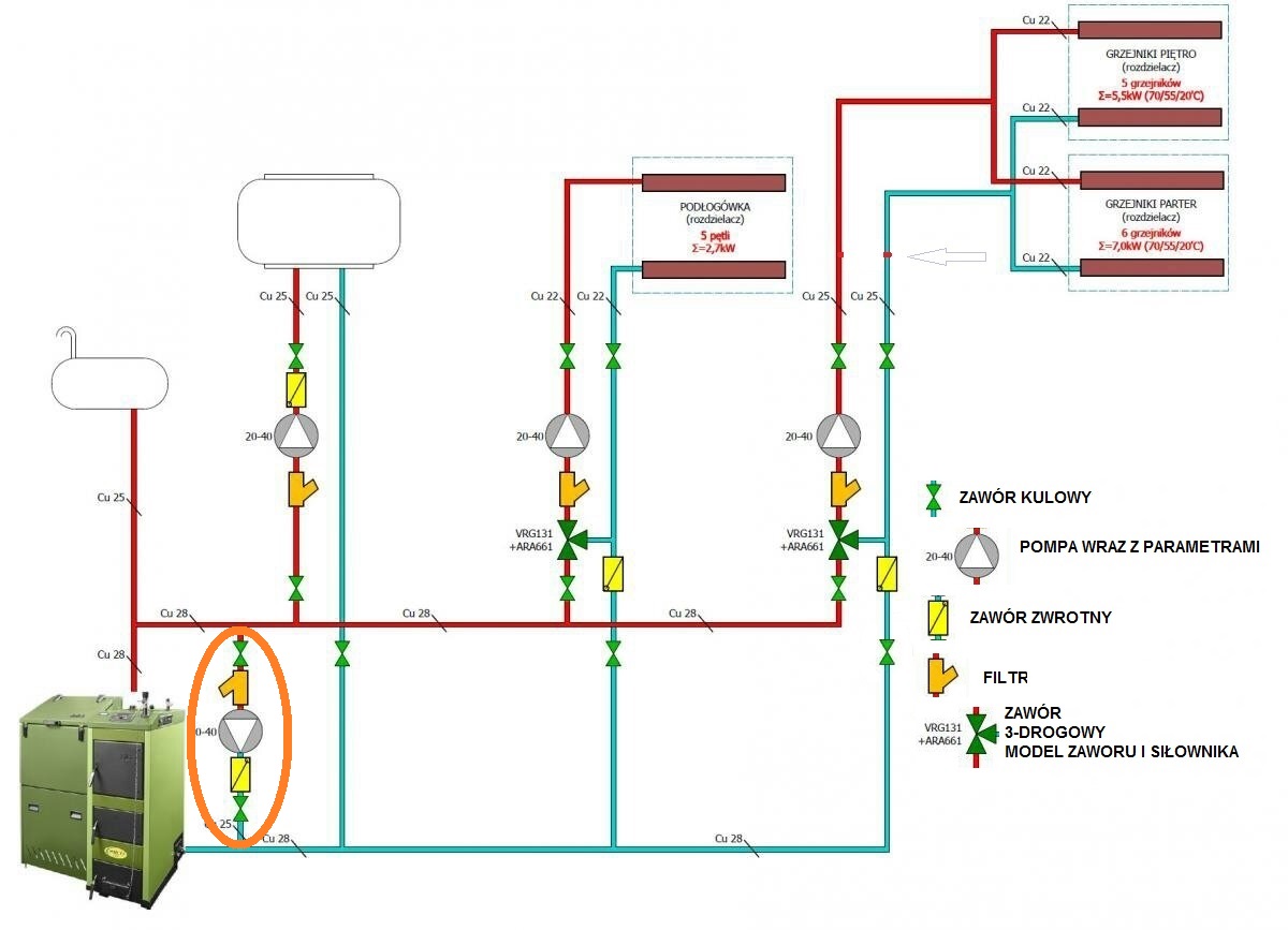

    First of all, you pay, so in my opinion they have nothing to say, since you do not have a boiler room done yet, ask them to do everything in the boiler room on steel / copper around the furnace and only switch to PP, that they say that they write stupidity on the Internet shows about their ignorance and ignorance because I wonder if even one of them finished school in this direction and was able to calculate hydraulic flows and resistances etc. and surely each of them boasts that he has done so much and there were no complaints !!!
    And give photos of the boiler room so that they do not cause baboli there, and 4D is not a protection, it only regulates the temperature of heating / return, personally I would not install it, it's a pity, like everyone requires it in the DTR, but this is about protecting the return of the boiler and you can do it differently.
    An overview diagram in the attachment
