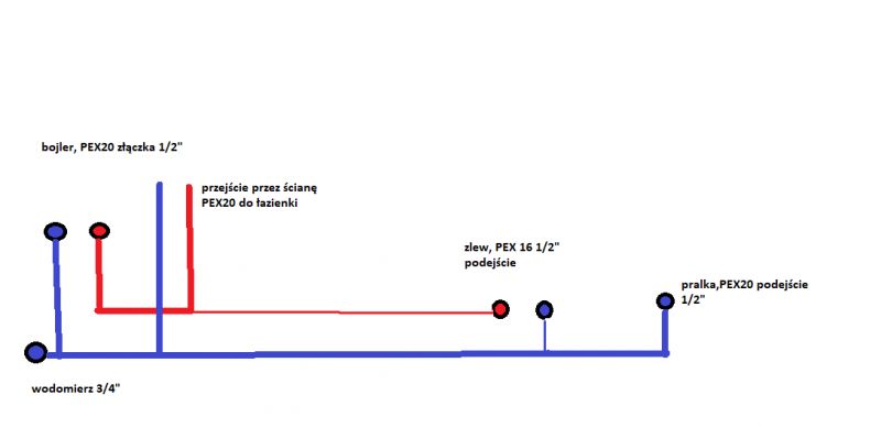

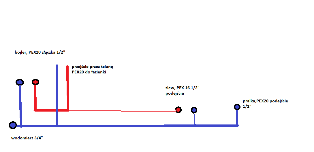

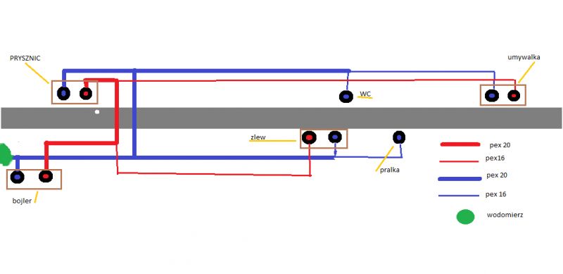

    Hello, I have a small water installation to do in a small bathroom and kitchen. As in the picture, the length of the wall is about 3 meters.
    So I want to do this installation in PEX / AL / PEX on U-type pressed fittings. Please give me your opinion if it is possible to do it as in the diagram below :)
    The main pipe from the water meter 3/4 "and here I want to enter with a pex 20 pipe, and a tee to the boiler for the kitchen and bathroom. In the kitchen, water is further on the tee 20/16/16 for the washing machine and tap. In the bathroom I want to give a pex 20 pipe for the shower and then a reduction for a washbasin and a pex 16 toilet.
    Can you do it like this? And will it work ok, or can it be done on pex 20 everywhere?

    I'm thinking about approaching the washing machine or not doing pex 20, and pex 16 for the shower

    It should work. In the toilet, of course, there is a cistern type cistern (the automatic drain would require a PEX20 pipe under the automatic device). PEX16 for the shower and PEX 20 for the washing machine? I think it's better as pictured. The washing machine does not require a PEX20 approach, and the shower - better if it has.

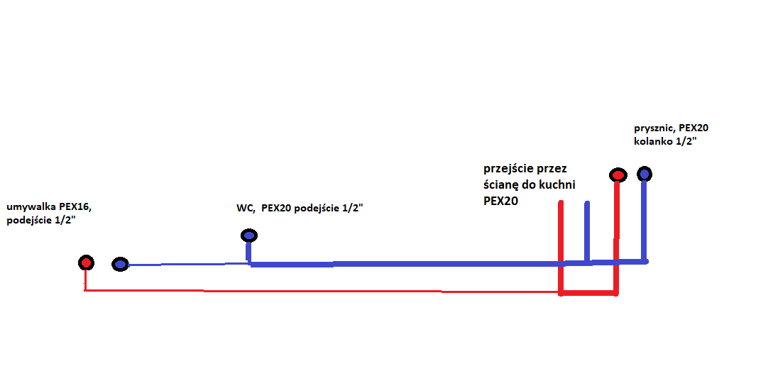

    I understand that the "project" I drew is OK and will work as it should. I bought a press, so the costs are probably behind me ;)
    The approach to the WC and WASHING MACHINEs on PEX20 requires changes. Is there a 1/2" connection to each device? e.g. PEX20 and 1/2" output PEX16 and 1/2"?
    I drew this BATHROOM and KITCHEN scheme, is it correct now?

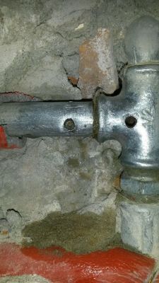

    So I'm going to give you one typical example of pipe drilling that I've dealt with. The tiler only had to install a toilet paper holder by the lavatory. Unfortunately, he did not remember how the pipes ran. Unfortunately, he didn't have a metal detector, but he drilled until he found it. He drilled the first hole without drilling through the pipe. The second one has already drilled successfully.
    Small Bathroom & Kitchen Water Installation: PEX/AL/PEX, U-type Fittings, Boiler, Taps
    To show you what it looked like, I'm posting a photo with drawn elements that were there. Unfortunately, I don't have the original photo after forging these tiles.
    As you can see, a galvanized steel pipe, drilled in two places.
    The woman reached me through a mutual friend. Crying, she begged me to help her, as she and the tiler had previously called 11 plumbers who refused to do the repair, either right away on the phone, or looking at photos sent via MMS, or after seeing it on site.
    An additional problem was that behind this wall was a kitchen that had been renovated. This elbow at the top was connected to the new kitchen installation made of PP pipes and it was not possible to turn it.
    Fortunately, we managed to cut the tee and unscrew a fragment of the tee from this elbow. Cramming deeper to grab the pipe with a wrench was out of the question, because there was a possibility of damaging the glass on this wall located behind the renovated kitchen.
    So now suggest how you would fix it. After all, you think it's a trivial job.
    In my opinion, this is not an easy job, which I undertook to repair as the first of twelve professionals.
    For all 1/2" taps and valves
    PEX 16 is enough for the washing machine and toilet

    So the first "project" is ok?
    So thanks for the information...
    I'm going to add a 3/4" filter after the water meter..
    Basically it's fine.
    Is this an apartment, a single family home?
    What's your network pressure? Maybe it's worth installing a self-cleaning filter with a pressure reducer
    This will extend the life of the boiler.
    If you can bend it, bend it. The fewer connectors, the cheaper. Press connectors have no chance of unsealing.
    Just don't buy PEX fittings and pipes in supermarkets.
    The best type of pipe is PEXc-Al-PEXc
    In supermarkets they sell pipes with lower strength. These are usually PERT-Al-PERT, PEXb-Al-PERT or PEXb-Al-PEXb pipes

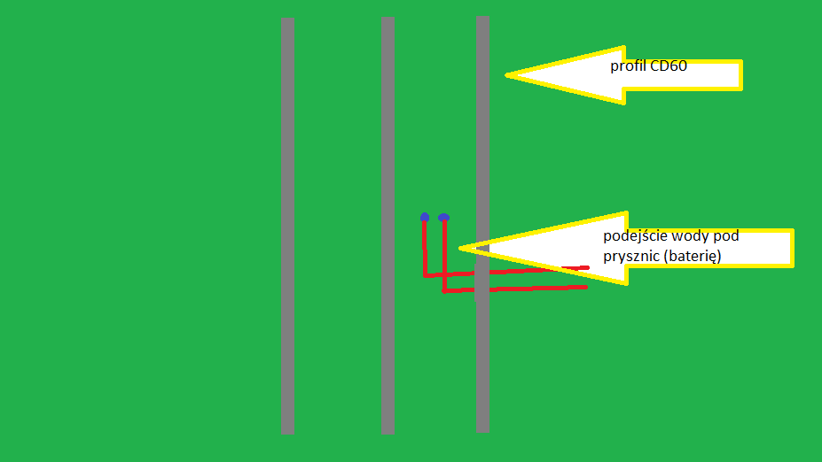

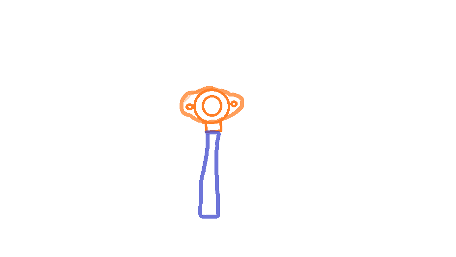

    Hello again.
    how to fix the approaches in the wall, gypsum cardboard, e.g. for the shower, to make it solid?
    the approaches will be a PEX 1/2" elbow with 2 mounting holes, how to make them protrude from the wall under the tiles properly ...
    or just when it comes out, tighten the appropriate extension, etc ...

    It doesn't work as it comes out. Approaches must be made rigidly so that the battery does not "fly".

Can I plumb a small bathroom and kitchen with PEX‑AL‑PEX and press U‑fittings?
Yes. The layout shown in the thread works for a short, 3 m wall run. Use a PEX 20 mm trunk if you start from a 3/4" meter line, then branch to fixtures. You can oversize to PEX20 everywhere, but it isn’t required for low‑demand points. [Elektroda, Zbigniew Rusek, post #17991031]
What size should the shower line be?
Run the shower on PEX20 for a steadier flow and less pressure drop when other fixtures open. PEX16 can function, but the shower benefits from the larger bore. This matches practical sizing advice given for small bathroom runs. [Elektroda, Zbigniew Rusek, post #17991031]
Do washing machines need a PEX 20 mm feed?
No. A washing machine does not need a PEX20 approach. Use PEX16 and a 1/2" service valve at the outlet. This keeps parts standardized and avoids unnecessary cost while maintaining flow. [Elektroda, Zbigniew Rusek, post #17991031]
What outlet thread size should I plan for taps and valves?
Plan 1/2" outlets for taps and service valves. For the washing machine and WC, PEX16 to 1/2" is sufficient at each point. This pairing simplifies parts and reduces bulk in tight walls. [Elektroda, Plumpi, post #17992803]
Should I use 90° elbows or bend PEX for direction changes?
Bend the pipe where you can. Fewer connectors reduce cost and leak risk, and bending improves flow. Use press fittings only where bends cannot achieve the path or spacing needed. [Elektroda, Plumpi, post #17992861]
How do I route PEX around corners cleanly?
Form gentle arcs toward the corner, add a short straight section in the corner, then arc onto the next wall. When rising from floor to wall, sweep along the floor into the corner, then up with another gentle bend. This avoids tight 90° elbows. [Elektroda, Plumpi, post #17992925]
Is a manifold (home‑run) layout better than tees in a small bathroom?
Yes. Run a separate pipe to each fixture and connect them at a manifold. This improves balance, simplifies isolation, and can reduce pressure dips when multiple taps open. It’s especially helpful in small bathrooms. [Elektroda, wowka, post #17991540]
Are press fittings reliable behind walls?
Yes, when pressed correctly and paired with suitable pipe. As one pro notes, "Press connectors have no chance of unsealing." Minimize fittings by bending where possible, and follow the system’s pressing instructions. [Elektroda, Plumpi, post #17992861]
Can I hide compression (twist) PEX fittings under plaster or floors?
Avoid concealing compression (twist) fittings. Use press fittings for concealed runs, and reserve compression joints for accessible locations. Stores may rent press tools when you buy the system. [Elektroda, Plumpi, post #17992272]
Which PEX‑AL‑PEX type should I choose for durability?
Choose PEXc‑Al‑PEXc pipe for strength and reliability. Avoid supermarket offerings like PERT‑Al‑PERT or mixed PEXb/PERT variants, which are typically lower strength. Buy from trade suppliers with matching press fittings. [Elektroda, Plumpi, post #17992861]
Do I need a filter and pressure reducer after the meter to protect the boiler?
Consider a self‑cleaning filter with an integrated pressure reducer after the meter. Cleaner, pressure‑controlled water extends boiler life and reduces maintenance. Install it ahead of your cold‑water distribution and hot‑water heater feed. [Elektroda, Plumpi, post #17992861]
How do I fix shower mixer outlets in a GK (plasterboard) wall so they’re rigid and sealed?
Use a reinforced cross‑member and seal penetrations. How‑To:
  1. Fix a horizontal metal profile between studs; add timber inside to stiffen.
  2. Screw the clawed elbows through the profile into the timber.
  3. Seal tile penetrations with gasket aprons and liquid rubber. This prevents a “wobbly” mixer and protects against moisture ingress. [Elektroda, Plumpi, post #18026854]

What are the risks if someone drills into a concealed steel pipe?
Repairs can be difficult and invasive. A tiler drilling for a holder pierced a galvanized pipe twice; eleven plumbers refused the job. Limited access and rigid threading made the fix risky near finished surfaces. Concealed plastic runs are typically easier to repair. [Elektroda, Plumpi, post #17992803]
How fast do galvanized pipes clog or corrode?
Expect heavy internal corrosion and scale after about 15 years. Symptoms include clogged filters and taps, frequent fixture damage, and rusty water after supply interruptions. Plastic systems avoid these issues and maintain cleaner flow paths. [Elektroda, Plumpi, post #17992423]
