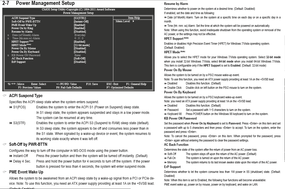

    give the bios version you have. For sure you have the option of powering ports in the bios. Take a picture of how you only go to the bios, which then in the tab power management setup /

    My Bios looks like this: The current for USB after turning off the PC - USB gives voltage even after the The current for USB after turning off the PC - USB gives voltage even after the

    Disable PME EVENT options and save settings. Let the system start, then turn it off and let me know. Tell me what system you have.

    I have Windows 10 64bit. Unfortunately, disabling this feature in the BIOS did not deprive USB power. It still gives you electricity

    Then change this function at the bottom. on dis ...

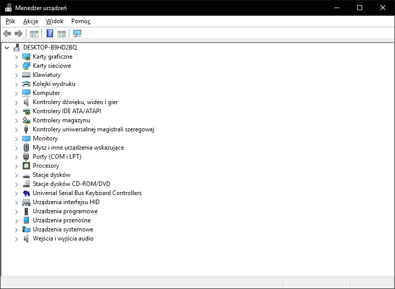

    And yes. Give a screenshot from the device manager. And with the power option (right click on the start button and enter the power options.

    Which function at the bottom? Power on by ring?

    Yes. Exactly

    Did not help. I turned off both and the USB has power after turning off the computer :( . Or maybe there is a program? on the laptop I also had Active USB after turning off but I have a laptop from the company lenovo and in the official program it was possible to do it and the USB has no electricity, I tried this program from the laptop to burn to the computer but it can not be. An error pops up that bad compatibility or something like that.

    EuP / ErP - Read about it in googlech. Maybe you have such options in a bios.

    Set ErP Support to Enabled (the second screen in your BIOS photos).

    no WoW, thank you very much: * dt1 helped when I gave an enabled Erp Support after turning off the computer, none of the devices has power. Again thank you very much. Subject to be closed.

    ErP has some side effects - Wake on LAN and turning on the computer with external devices (mouse, keyboard) does not work. But if these functions are not used then there is no problem.
