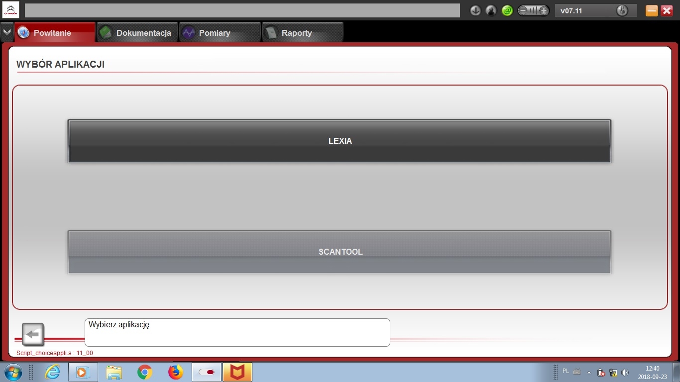

    Diagbox installed according to the instructions. After firing and selecting the car, it reads the VIN. Enter VIN, request OPR. You can select Lexie and scan the tool, but after selecting the first or second, nothing happens. Anyone can help?

    is it confirmed? I have just installed on Win7 64-bit DB 7.01 and updated to 7.24 and I have the same problem, after entering OPR I have applications to choose from, but after selecting nothing happens. If this is really the fault of the 64-bit system, how do you deal with it?

    Install the 32bit system.

    I confirm, I had the same case and installing DiagBox on Windows 7 32bit helped.
