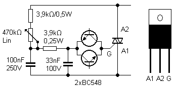

    Hello, I wanted to do this simple layout from the link below
    http://katalogi.pl/uploads/old/6/images2005/20050730131631.gif
    my problem is that I do not have a diac and the nearest store is 19 km away and my question is whether you can replace this diac with something else, e.g. properly connected transistors. Thanks in advance for reply. :D

    No. Look further in that topic for a meaningful substitute diagram in # 14.

    The easiest way is:
    Diac Replacement Options: Alternatives to Diacs in Circuit Layouts (Link Included)
    This was once done in the "Polam" dimmers. The bases are to be unconnected.

    Look at this:

    Marcin7254 wrote:
    At 230V? No, moreover, no deacon at 230V will not work. Most diacs have an operating voltage of 30 to 35V.
    Marcin7254 wrote:
    and you could give a diagram because it doesn't really want to work. :D
    The diagram is in post # 3.

    I suggest you go to a place with electronic waste. Each compact fluorescent lamp has a DB3 or DB4 diac.
    Choose bulbs that are not overheated but have black (dark) electrodes. Electronics should be functional in them.
