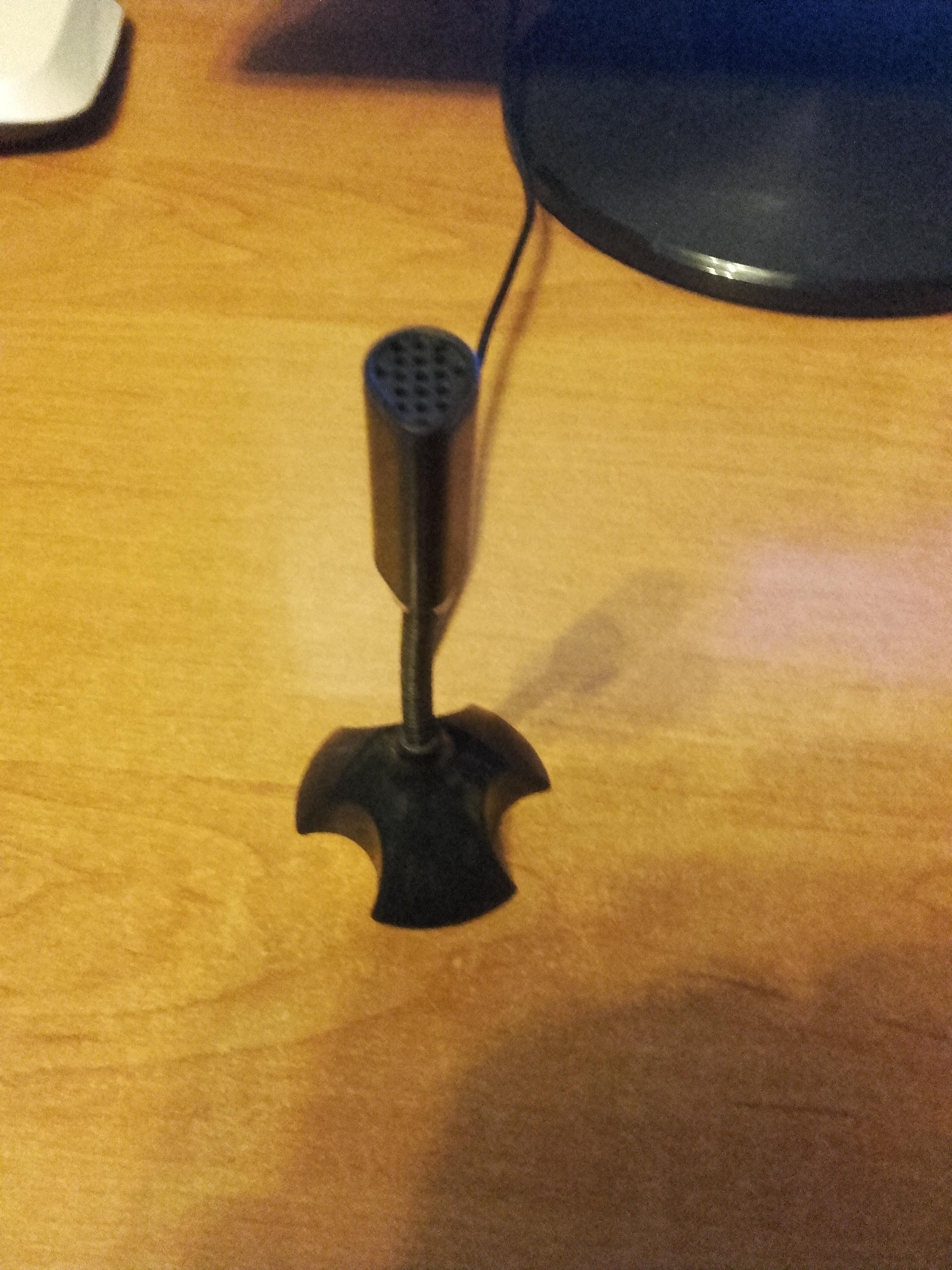

    Do you connect the microphone to the front panel of the PC or to the back directly to the microphone socket on the sound card? Take a picture of this microphone at least we'll see what contraption you have.

    So I plug my microphone into the socket on the back of the computer. I also have a photo of this microphone in the attachment.

    This hum can also be interference from the 50Hz network, for example, I can see that next to you have a lamp on, the cable goes next to the power cables, which can also affect the operation of the microphone. However, I would bet that it is the fault of the microphone and the music card. I have a CREATIVE USB music card and with the already mentioned SONY microphone, the noise is minimal for me, but it does not hum like you.
    Check at yourself after recording the silence to what height the noise comes after the maximum zoom. The greater the sensitivity of the microphone, the greater the noise, check the settings on the minimum and maximum sensitivity.
