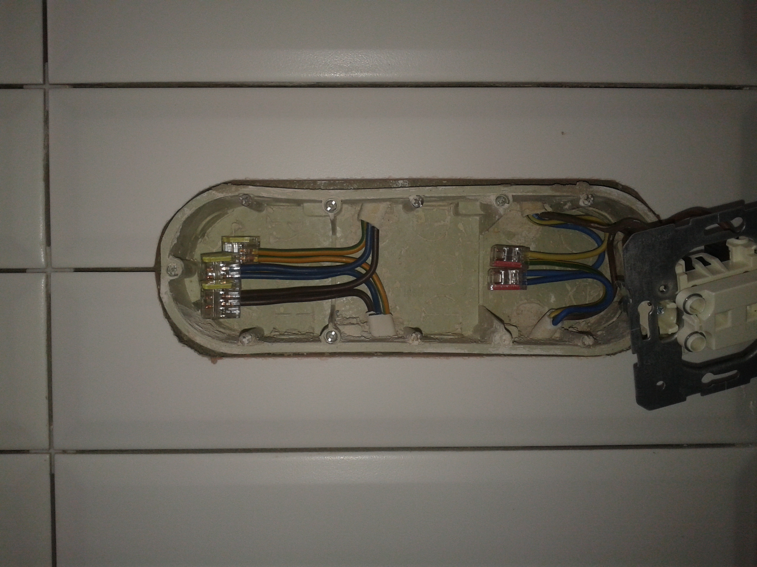

    Probably a trivial matter, but I wonder how it should be professionally connected ..
    It is about pass-through sockets - on one side there are 3 power cords - on the other side there are 3 wires for the next socket. How to connect them to the socket and let the electricity go on (connect 2 wires on the screws in the socket, are there any cubes or other way ...)
    So far, I have always dealt with installations that the main box was above the socket under the ceiling, from where the electricity went on and one wire for each connection was connected in the socket ..)
    In such an arrangement of pass-through sockets, I would not like to lose power on the contacts (the wires are 3x2.5 - if I connect to the socket contacts, then going through the next sockets will not be a big loss - the wire contact on the screws is not too large - if any wire is loosened, it can heat up. on the contacts - it is not even known in which socket ...)

    Of course, on the contacts in the socket. With 2.5 mm cables it will be hard (it also depends on the socket manufacturer).

    I always use socket clamps and after mounting the frame, I tighten the screws before installing the sign and there is a guitar guitar.
    A double screw socket on the plug terminal plate has profiled plates on the sides so that the wire does not stick out from under the head, after tightening I press these plates to the edge of the screw.
    And the self-tightening wires with the appropriate length of the wires according to the manufacturer's requirements, it is not a problem for it to slide out by itself.

    And not better right?
    Pass-through Sockets Wiring: Safely Connecting 3x2.5mm² Wires for Daisy-Chaining
    #9 14234603
    Łukasz-O
    Admin of electroenergetics
    Posts: 21789
    Help: 654
    Rate: 4290
    Or yes:
    Pass-through Sockets Wiring: Safely Connecting 3x2.5mm² Wires for Daisy-Chaining Pass-through Sockets Wiring: Safely Connecting 3x2.5mm² Wires for Daisy-Chaining

    I use x2, x3, x4 boxes, I use 2.5mm? Ly with pressed sleeves between the sockets.
    Of course, in 3 colors

    I don't understand why :?:
    Even with shallow 2x, 3x etc. boxes, everything fits easily (with well-thought-out wiring). There is also no problem with stuffing stiff and flexible six 2.5 when mounting the socket.
    Pass-through Sockets Wiring: Safely Connecting 3x2.5mm² Wires for Daisy-Chaining Pass-through Sockets Wiring: Safely Connecting 3x2.5mm² Wires for Daisy-Chaining Pass-through Sockets Wiring: Safely Connecting 3x2.5mm² Wires for Daisy-Chaining Pass-through Sockets Wiring: Safely Connecting 3x2.5mm² Wires for Daisy-Chaining
    I wonder what colleagues who like to connect directly to the accessories will do, if three 3x2.5mm? wires are connected to the box - this is often the case for technological reasons.
    Most often, problems with circuit continuity occur precisely at the socket terminals.

    shulc wrote:
    Secondly, there is the Otwock and Falenice schools.
    When I have time, I sit and think, if I don't have time, I just sit
    I have heard this saying many times and to be honest I don't know what it was about ...
    I made installations in Otwock and Falenica - I did not see any differences in approach. An interesting fact is that despite Falenica administratively belongs to Warsaw, it is served by the Otwock region.
  • #29 14238627
    pol102
    Posts: 3085
    Help: 163
    Rate: 369
    I noticed shortcuts in the German developer. Not that I have not seen similar solutions in Poland ... but ... Pass-through sockets: arrival and departure cut so short that only the balance is fastened + 1cm of reserve, and the balance is connected to the LG 1.5mm ^ 2 socket. Easy, convenient and supposedly works.
  • #30 14238631
    shulc
    Level 22  
    Posts: 635
    Help: 37
    Rate: 109
    @ Lukasz-O
    Łukasz-O wrote:
    I have heard this saying many times and to be honest I don't know what it was about.
    I also do not know for sure, it is probably older than the good practice of an electrician.
    If there are two schools, there must be two teachers, of which there may be two views, etc.
    Łukasz-O wrote:
    And here the devil is in the details.
    Exactly, I did not say it was a babol and I will not make such a connection, apparently I wrote it wrong. I don't stick to mine, but I have some concerns
    Łukasz-O wrote:
    Nos. 2 and 3 - correct derivation, bending forces are distributed, something like a spring.
    Yes, but if there is play in the joint after folding, there is no room for improvement
    , I do not insist, you have more experience, what I undertake, I try to do exactly
    greetings
