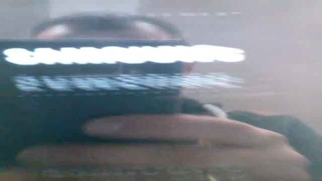

    Hello, I have a problem with the phone, has anyone encountered such damage, is it the display's fault or not?
    [movie: bfe6687d2c] https://filmy.elektroda.pl/84_1489515259.mp4 [/ movie: bfe6687d2c]

    Without disassembling the phone and checking if, for example, the display tape is well plugged in, or if it is not broken somewhere, you will not find out what is wrong.

    It is plugged in, because I checked, I did not only look at the cracks, and could it be the motherboard's fault?

    You may also have a damaged graphics chip on the board, but you can only check this by translating a different display to your board.

    I would rather bet on damage to the display. To be 100% sure, you need to replace and check.

    You can see the damaged display in black and white.
    Has the assembly failed? : /

    Not at all, it's still a factory display.

    Let it dry without touching it and see what happens

    I had a similar case but the tablet was helped by re-uploading the entire ROM. If it does not help you, you will be sure that it is the fault of the display itself. In the phones, in turn, I had a case that there were stripes but vertical and solid ones did not flash like in your case. The phone returned from the service with the display replaced.
