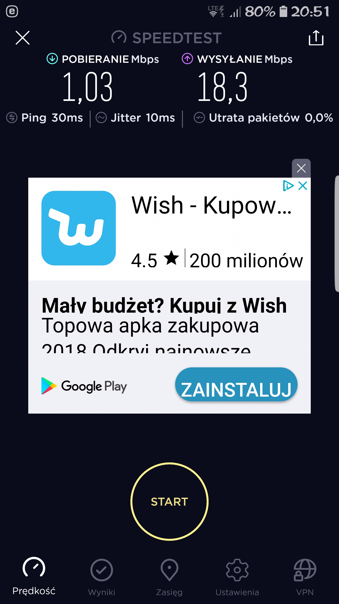

  • #8 17296772

  • #14 17300532
    phubobik
    Posts: 6
    Tragically it looks damn how to change it

  • #15 17300613
    matek451
    Posts: 31254
    Help: 4352
    Rate: 5808
    Bottom and meter of silt, BTS on Kolejowa crowded to the limit. Tomorrow, pack the B529 with a charged battery and go under BTS on Wzgórze Hill with ZWIK on Ząbkowicka, position yourself in your direction about 200m from him and make the same measurement with HManager and speedtest. You need to check how the internet works on LTE800 from this BTS. If it is better to connect with it you will have to force the directional antenna at 800MHz. Now, force 3G on B529 using Hmanager and select UMTS2100 on it, show screen and DL / UL. It has a BTS UMTS2100 HSPA + DC from DL to 43.2Mb / s. It is possible that it is less burdened because everyone uses LTE800 on it.

  • #18 17300724
    matek451
    Posts: 31254
    Help: 4352
    Rate: 5808
    Well, everything is clear, the problem is solved. You're using 3G on UMTS2100. The parameters of the OK signal, good speed and UL almost the maximum to obtain in this technology. For curiosity check out LTE800 from this BTS on the hill.
