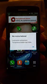

    that's the message on my phone. The phone was soaked (you can call it flooded) so here I would look for a problem, but before I undress it I would like to ask for advice. What could go wrong? The message looks like this:
    Galax A5 2016 - Charging paused. Battery temperature too low.

    If it was flooded and you are going to undress it (not easy) then look for traces of liquid on the disc and remove them with the help of iso, it would be a good solution to have a bath in an ultrasonic bath.

    Hey. There is a damaged / corroded resistor responsible for charging control. It is on the bottom right next to the charging socket. The exchange will help if there are no other faults. Have you put these phones out? (Galaxy Ax). If not, you will beat this lcd and the phone will be rubbish.

    If someone has the skill to undress this phone, there is no need for a separator. As for the battery temperature, you have one thermistor on the tape with the USB connector and the other on the PCB. I bet that replacing the tape with the connector should do the job.

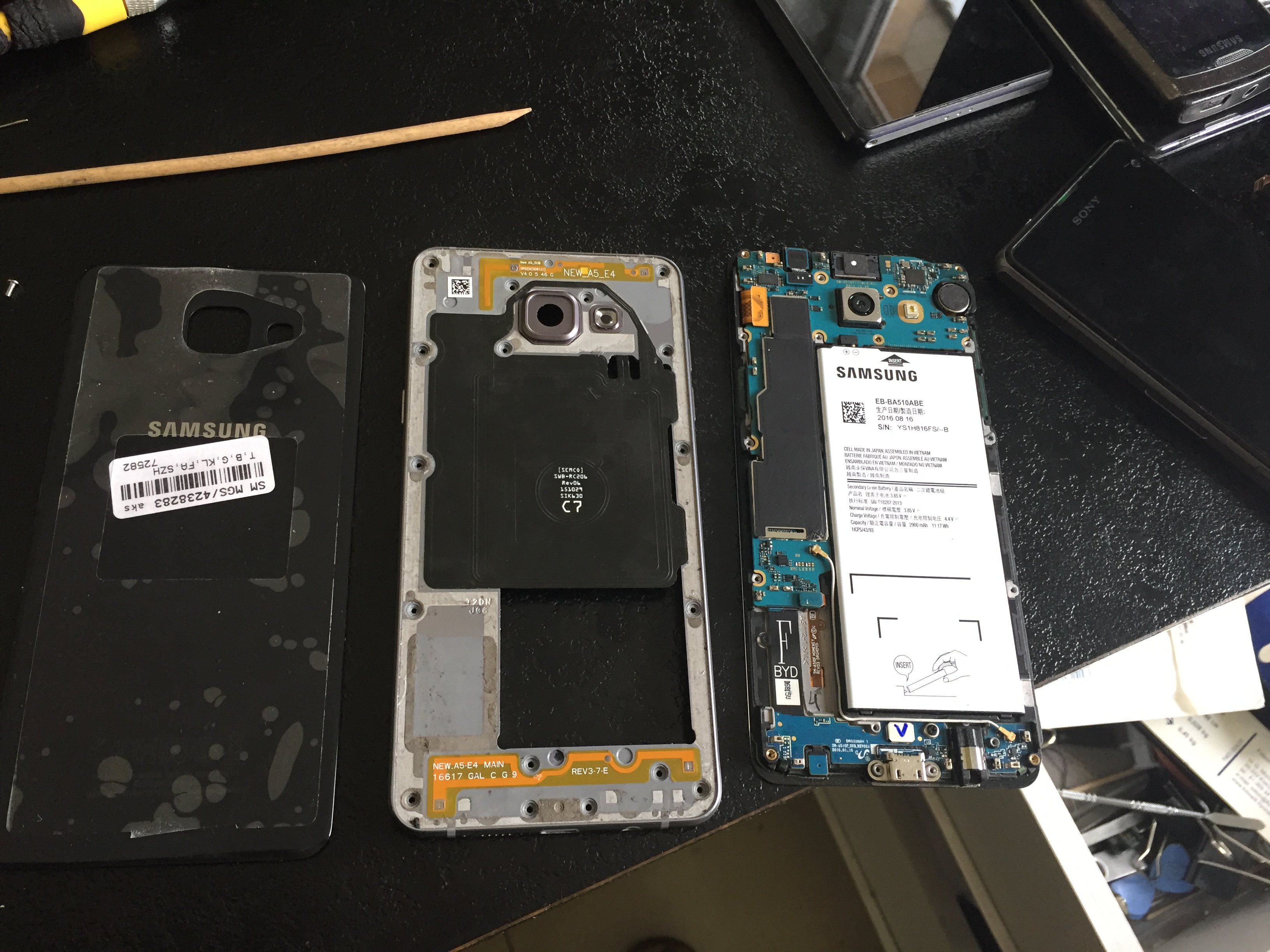

    We get to him from the side of the back, the display was raised in the usual a5
    You can only do well so that the service has an ultrasonic cleaner.

    A5 2016 :)
    These are fucking, the worst is to solder the sockets, here is the need for an expert and not to start a sardifobe.
