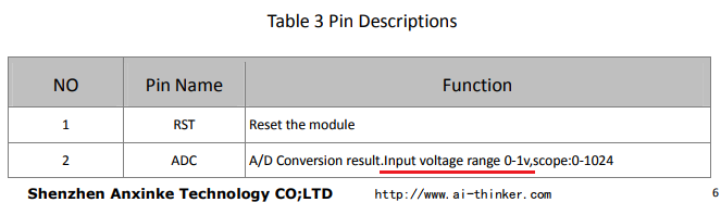

    I am running a wemos d1 mini from espeasy connected to a PWM to 0-10v converter purchased on alledrogo. Link .
    I am powering this 12v from 1A meeting the minimum requirements of 12V and >200mA. Unfortunately when manipulating the PWM to its full range I achieve values of 0 - 1.2v instead of 0-10v. Do I have an unlucky module or have I missed something?
    With the above I plan to replace the clunky recuperation controller (AC2800) with something integrable with Domoticz.
    Thanks in advance.
    Ps. Yes, I've been turning that knob, but it doesn't do anything.

    Give it a constant 3.3V on the control , then 5V (simulating 100%) and measure what then happens at the output.
    Do you have the converter output loaded with something?
    And I apologise in advance, but are you measuring on a fixed or variable range voltmeter?
    Check on a known voltage that the meter is working.

    Author, in the link you pasted there is an auction with the title
    "0-10V 0-5V to PWM 0-100% converter", i.e. voltage to PWM conversion
    in the picture it says "PWM input, 0-10V output", i.e. PWM to voltage conversion
    What did you actually buy?
    Well, and paste a photo of what you have so that you can clearly see what IC is sitting there.

    Thanks gentlemen! I couldn't stand it and, assuming the module was faulty, I bought another one, this time from gotronik with the designation BTE-716. Connected in the same way, it runs like a dream.
    Ps. @jarekgol admittedly I was measuring on a constant, but you have estimated well my state of electronic knowledge.
    @jarzabek666 I was changing the jumper getting results even lower by half.
    I was already powering the Wemos with 5V, via USB.

    Giewarro wrote:
    I was already supplying 5V, via USB.
    but they seem to have 3V3 on the I/O pins, set some pin to 1
    Code: Arduino
    and measure with a voltmeter.
