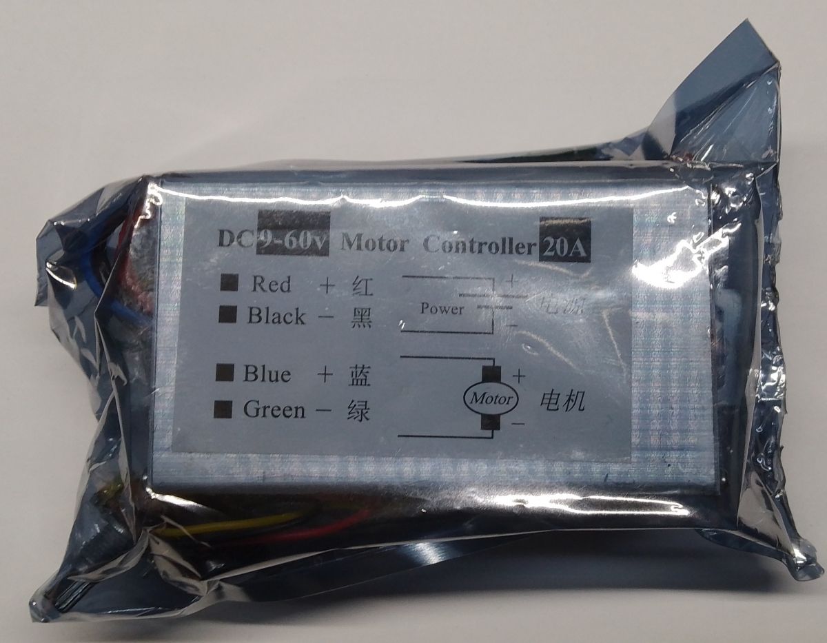

    The described regulator module was given to me by a colleague, who purchased several pieces to regulate the speed of the windscreen wiper motors in his car. The module is packaged in an anti-static foil bag;

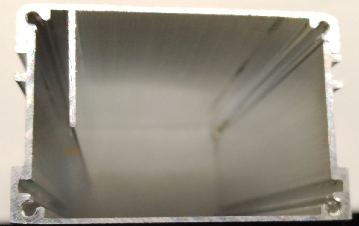

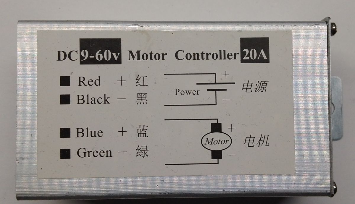

    It gives the impression of being solidly built, the housing made of aluminium profiles with steel end caps also acts as a heat sink (although not really, but more on that later).

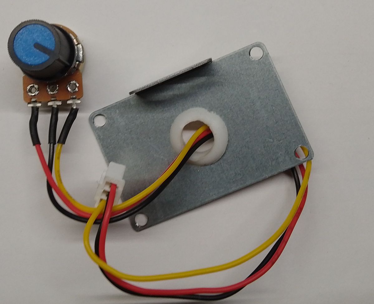

    As it were, "included" we get a potentiometer for adjustment together with a knob, in the photo below I have unscrewed the cap to take a look at the interior.

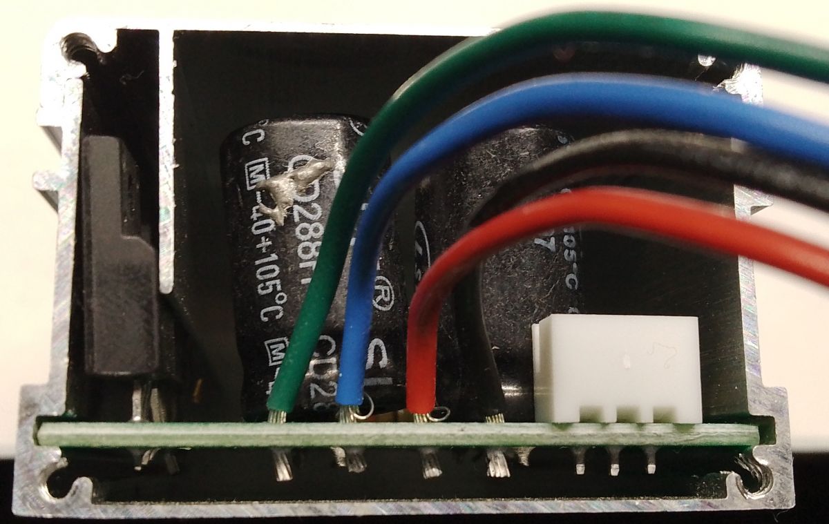

    As I mentioned, the enclosure is intended to act as a heatsink and is mechanically adapted for this, however, the thermopad between the power components and the enclosure wall was missing;
    He gave me a PWM z Alliexpres regulator, max 60V i 20A

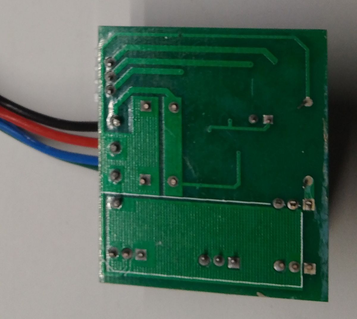

    I rather don't anticipate long operation at higher currents.... The regulator board measures 47x40mm and was made as a double-sided board.

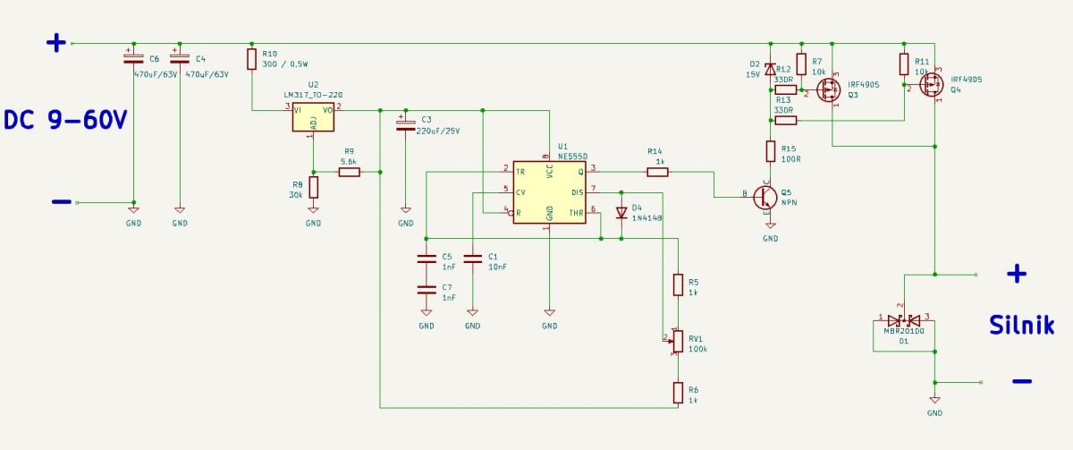

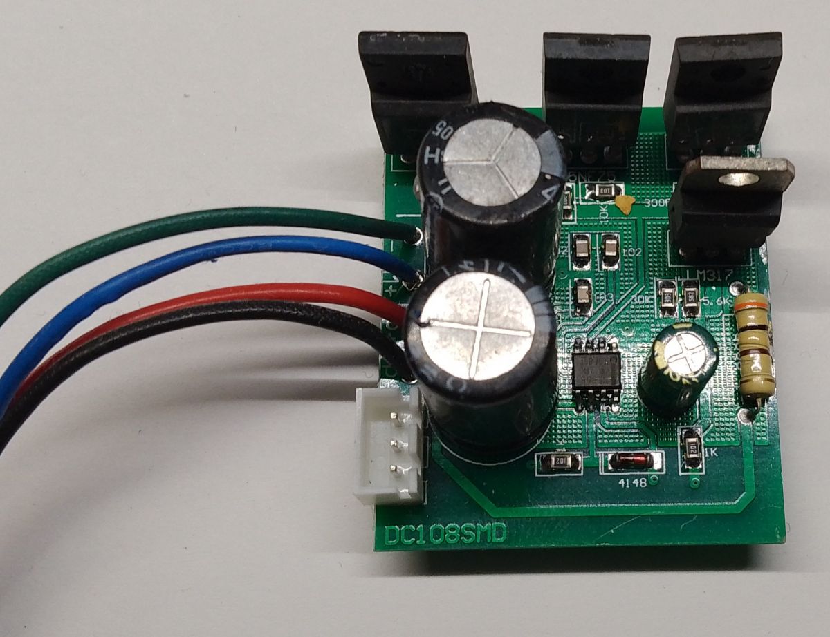

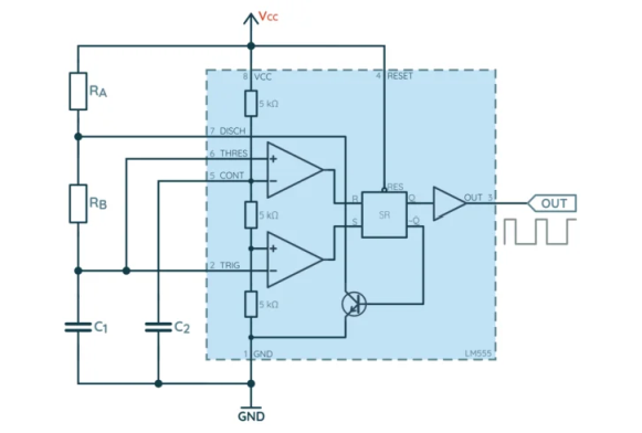

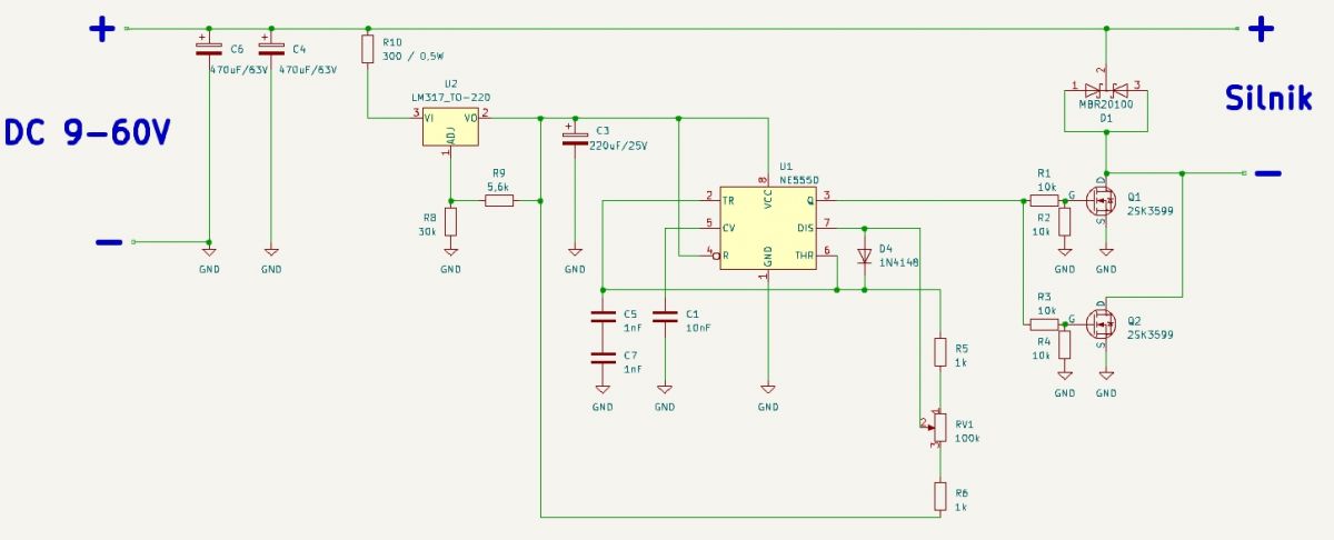

    Basically, the whole regulator consists of a dozen or so components and its main component is.... NE555 precisely! I took a moment and redrew the circuit layout from the board;

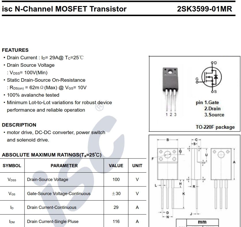

    2SK3599 transistors were used as executive keys although the choice of gate resistors is questionable to me....

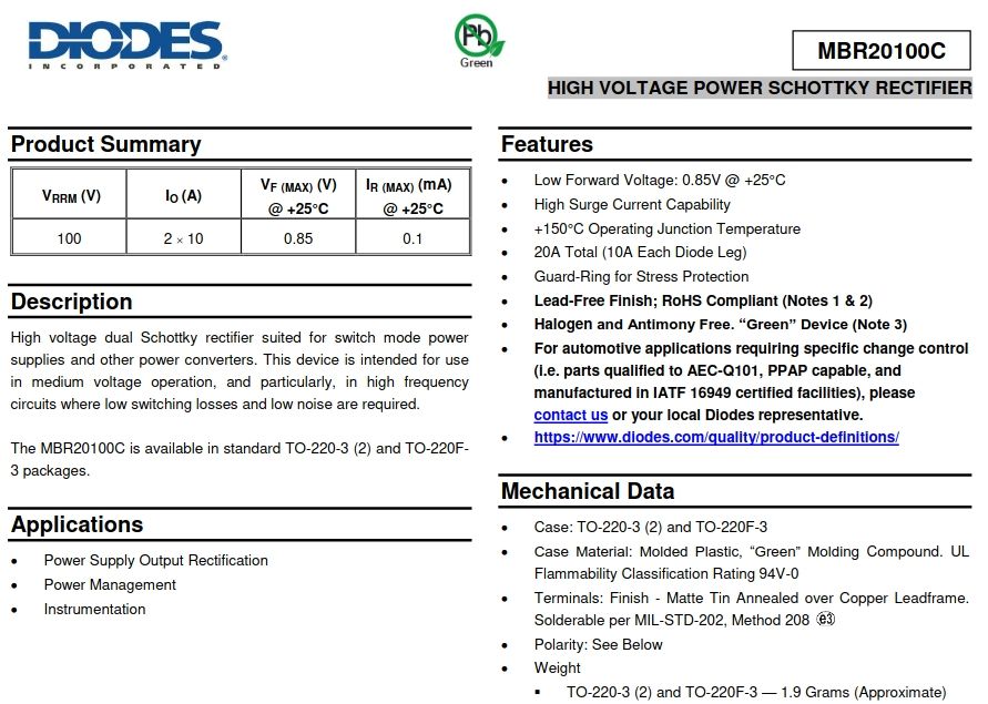

    The MBR20100 duodiode is used as the pin suppressor diode;
    The role of the auxiliary voltage stabiliser for the NE555 is played by an LM317 with somewhat unusually selected resistors fixing the output voltage;

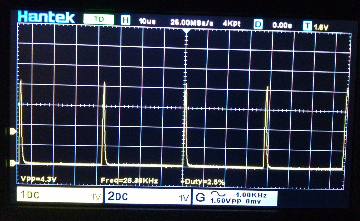

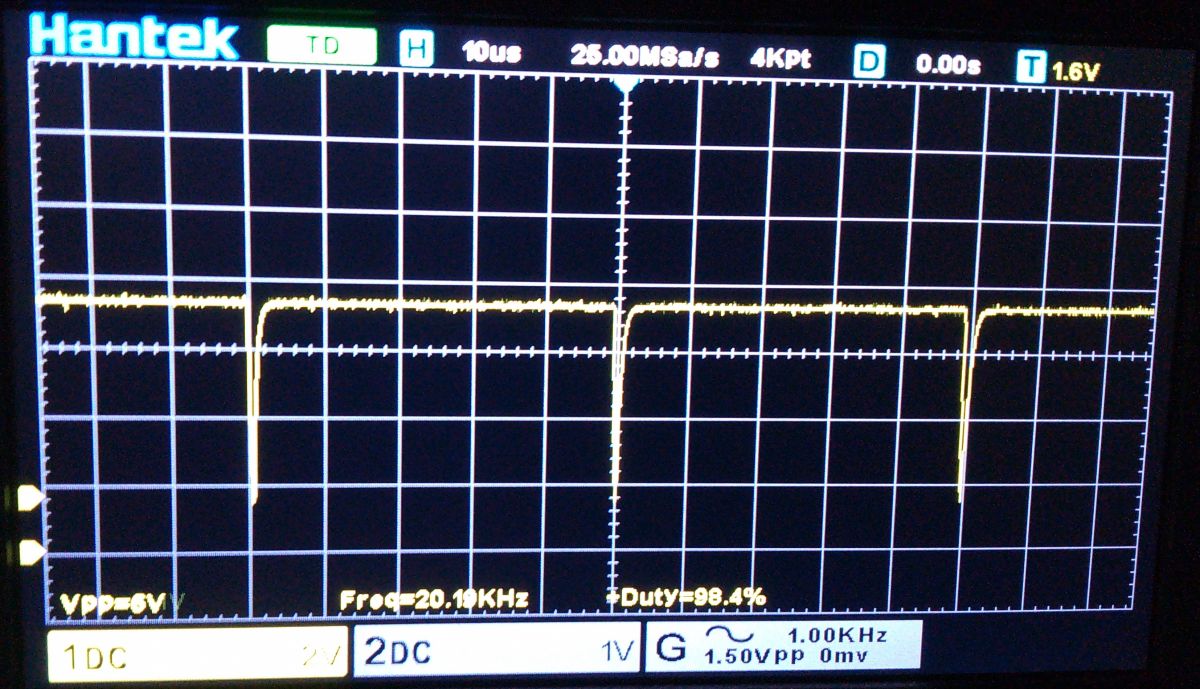

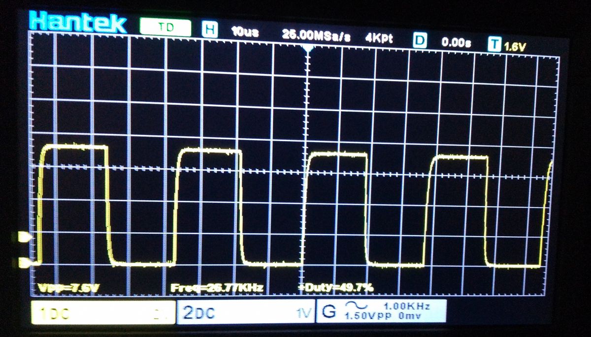

    The PWM 'carrier' frequency is ~20kHz which should not produce audible effects when working with inductive loads, the fill is adjustable from about 2.5% to 98%. Below are some photos showing the minimum, average and maximum settings;

    In truth, if I were to buy this regulator I would prefer to build it myself :D .
    Errata; .
    Gate resistors are not 10k but 300Ω. Sorry for the mistake.

    For 2SK3599 in pdf they give Vgs(th) from min. 3V .. max. 5V, so this dividers R1||R3 and R3||R4 on the gates of the mosfets from the supply voltage of 8V will make 4V!!! Maybe someone made a mistake and it was supposed to be 10Ω instead of 10kΩ? 🤔
    Probably my mistake unfortunately :-( The gate resistors are marked 301 (300R) and from gate to ground 103 (10k), all elements have the values described on the PCB. Sorry for the confusion.

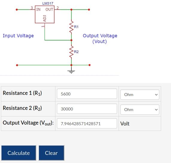

    The role of the auxiliary voltage stabilizer for the NE555 is played by the LM317 with slightly unusually selected resistors that determine the output voltage;
    The LM317 will not give the voltage in the case of a 9V supply voltage, and as it is given in the colleague's diagram.
    There's an error here somewhere.

    Mateusz_konstruktor wrote:
    The LM317 will not provide the voltage of 9V
    And where did I say that?
    Of course, but committed (or maybe not) by the Chinese designer of the regulator. NE555 works properly from ~4.5V, for this LM317 configuration, the output voltage at 9V power supply is 5.7V. Taking into account the voltage drop on the output transistor 555 and Ugs(th) 2SK3699, the whole thing will work.

    @ArturAVS
    Thanks for the insert with the lack of proper pressure on the housing / heat sink, I assemble this regulator to my wife's car because the resistance switch of the airflow force refused to use (one of the spirals burned, luck wanted that the most used one). I dealt with the pressure by tightening the TO220 elements through the ALU strip filling the excessive distance and of course with thermal paste. The conclusion is that it is good to be inquisitive and look from the kitchen how they prepare the dish

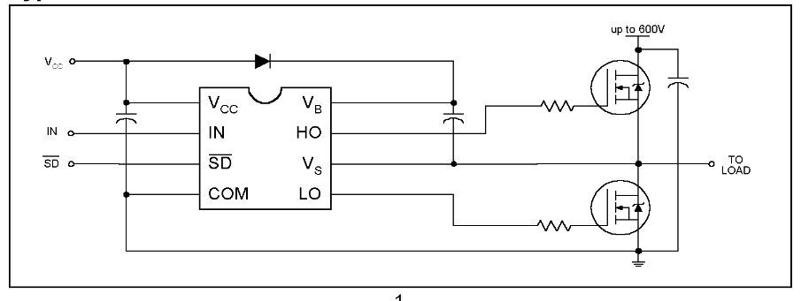

    Przem188 wrote:
    I know that due to other MOSFETs it is more troublesome to design.
    Nothing could be more wrong. You just need to reverse the control logic for the P MOSFETs, e.g.;
    Or use a special driver for N MOSFET. The whole thing is due to the fact that N-channel transistors usually have better parameters than P-channel ones and are cheaper. The drivers are so much better that they allow you to control much higher voltages, such as the IR2104 (which I often use myself);
