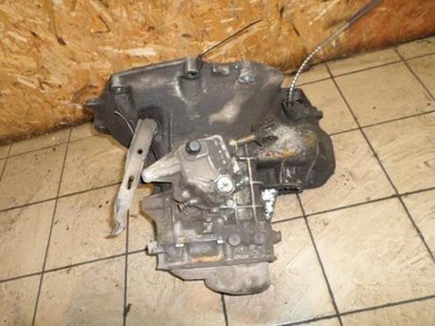

    Hello. I wanted to change the speedometer line. I have already disassembled all the screws at the meter, etc. It only stays on the cord and 2 cubes with wires. I wanted to unscrew the line so that it loosened a little and then the speedometer came out nicely, but I don't know where this line is under the hood and where to unscrew it? 1.4 8 valve 60HP engine, year 97 in the sedan.

    as there is a cable drive, the cable goes to the gearbox below the gear selector. So it falls down vertically

    on the basis of these photos it appears that in this car the meter drive is electric to the left wheel to the hub. Are you sure you unfastened the cable from the clocks. If you unfastened it, ask someone and pull it towards you and it will be visible in the engine compartment. Repairing this may involve replacing the wheel hub

    Faj from 96, all AF, and basically Opel, have an electronic speedometer and the pulser is in the gearbox, 2 years later changed a bit, but also in the gearbox and from 00 from the ABS controller, you go to the factory navi.

    gibn wrote:
    Fać from 96, all AF and basically Opel have an electronic speedometer and the pulser is in the gearbox
    You confuse with the Corsa B, the Astra F always had a line.
    You can see her in the photo.
    Astra F '97 Speedometer Cable Location: How to Access & Remove for 1.4 8-valve 60HP Sedan
    zenon003 wrote:
    1.4 8 valve engine 60HP
    The photos show the X14XE, 90HP, 16 valve engine.
