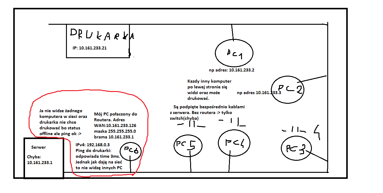

    I warmly welcome,
    I have a question how to connect to a printer, I have a router: tp-link TL-WR841N with lan 192.168.0.1/24
    I have access to the Internet from another network I do not know how to explain it hmm from the second server room: 10.161.233.0/24
    When I connect the cable directly to the computer, I can see computers on the network and a printer.
    When I connect via the router, I can not see a single computer (except mine) and the printer.
    The best part is that I have access to the server and the ping to the printer responds correctly.
    What do I have to do to see everyone on the network through the router and to prevent the printer from being offline?
    greetings
    Gregory

    Please draw a diagram of the network and describe what pings and what does not, it will be easier to help.

    I add an image:
    Connecting to a Printer via TP-Link TL-WR841N Router on Separate LAN Networks
    I would like to add that when I hook up "live" with a cable to my PC, the printer will print what I want and I can see others on the network. But when I connect via a router, not anymore. Therefore, I am asking how to make it go through the router because Wi-Fi from this router is needed in general, and I need access to the printer and the Internet.

    The problem is you are using NAT on your router, meaning the printer cannot see the 192.168.0.0/24 network because it only sees 10.161.233.126.
    The solution is to add a VLAN on the Switch that supports L3 or connect directly to the 10.161.233.0/24 network
    Generally, TP-Link class devices are not used in extensive computer networks, but as an Internet access device in the home network.

    Let the author correct the diagram, place _all_ devices, both ends of _ each_ network wire in the diagram must end at a switch / router / computer, they are not electrical circuits.

    This is only a provisional drawing. The cables come from the server / switch and through the Ethernet cables they go to each computer in the building, connected directly to the computer, I have described so precisely that no drawing is needed to show it. However, my case shows that I cannot see others on the network if I connect via Router.
    Thank you Mr. Sanfran I will try to do this. Other suggestions are welcome.
    Connecting directly to the network doesn't do much for me, that's why I sent this query.
    So I will not get anything done on the router? I need to go to the switch administrator?
    Added after 4 [hours] 20 [minutes]:
    I got it :)
    I made the router work like a switch.
