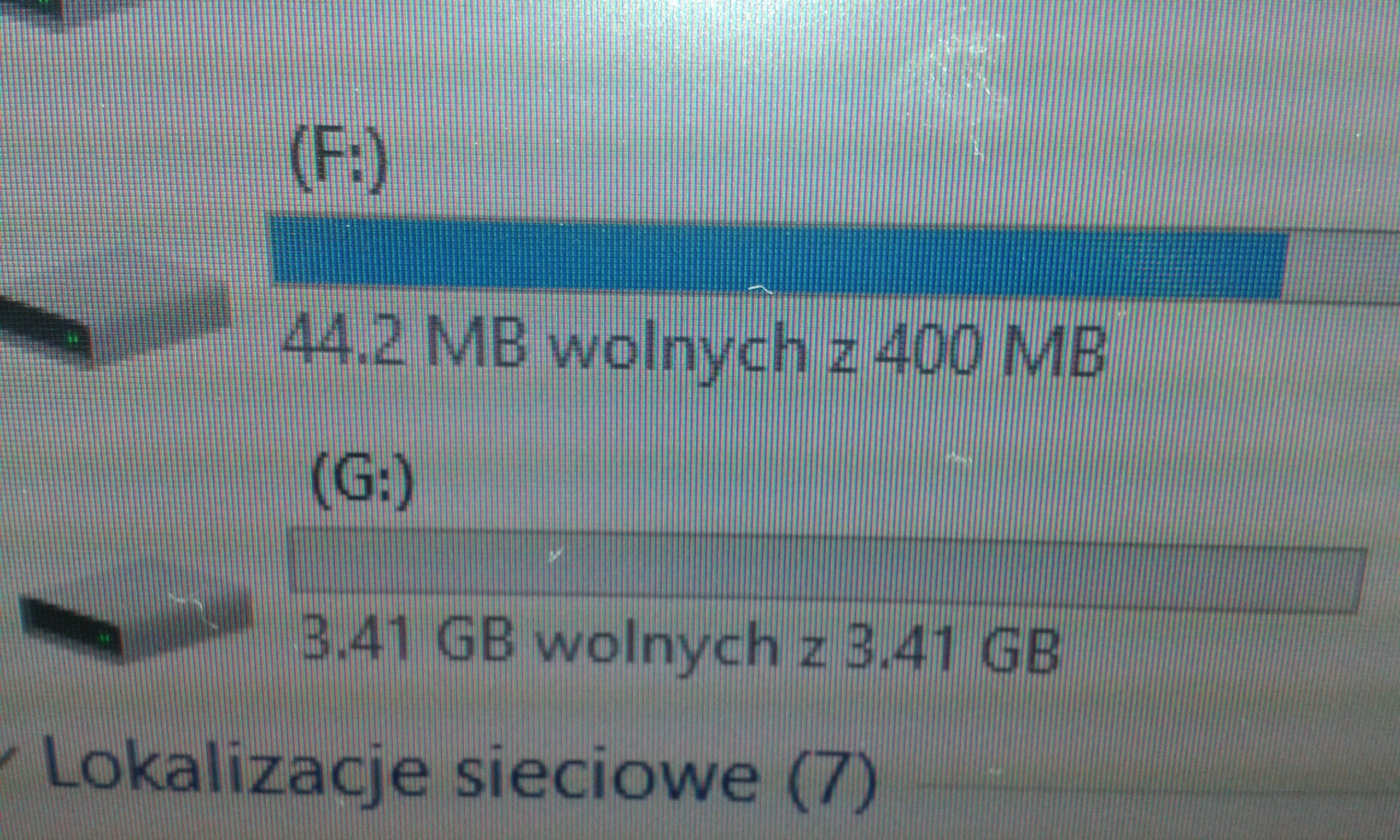

    Hi,
    I flown through a lot of topics and solutions but I can't take any particular step forward.
    I have two flash drives that I got at one training session.
    Both same 4GB.
    The situation applies to each of them separately.
    When I connect the USB flash drive, it shows me two drives:
    - the first 400MB, with the company's advertising presentation, impossible to format
    - the second 3.4GB empty with which "you can do whatever you want"
    I would like to merge it normally, format it so that there was 4GB available without unnecessary files left behind.
    I tried the low level format - it is not overwhelming.
    Photos:
    Pendrive noname 4GB advertising bag - two partitions, how to merge and format? Pendrive noname 4GB advertising bag - two partitions, how to merge and format?
    Can anyone help?

  • #2 16360583
    viayner
    Posts: 10628
    Help: 1563
    Rate: 2051
    Gparted - He has never let me down.
    What disc formats? It is possible that the chip is programmed in this way and only changing the firmware will help something.
    Regards
  • #3 16360585
    Odżi
    Posts: 64
    Rate: 16
    What formats? .. The 400GB one has a FAT file system, the 3.4GB one has a FAT32 file system for that matter.
    Gparted - I'll try in a moment.
  • #4 16360621
    viayner
    Posts: 10628
    Help: 1563
    Rate: 2051
    exactly, and what messages do you have that cannot be formatted?
    Regards
  • #5 16360628
    Odżi
    Posts: 64
    Rate: 16
    ! the disk is write-protected.
    Ah gparted I won't be able to try until the evening.

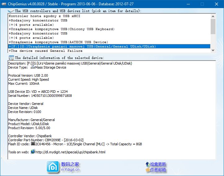

  • #6 16360904
    mbo
    Posts: 19691
    Help: 2333
    Rate: 845
    Paste the picture as seen by the ChipGenius pendrive.
  • #7 16360944
    Odżi
    Posts: 64
    Rate: 16
    I paste the first pendrak pendrive:
    and paste the second pendrak pendrive:
    8GB? :D
  • #8 16360975
    mbo
    Posts: 19691
    Help: 2333
    Rate: 845
    The bone looks like 8 GB, but it may not be fully functional and works properly less.
    At the very bottom of the program there is a link to the utility program - download it and see if it recognizes the flash drive.
    Or check it out Chipsbank umptool209X

  • #13 16363830
    pidar
    Posts: 11363
    Help: 1569
    Rate: 3585
    Odżi wrote:
    Unfortunately, I left the butterfly at home and the new ChipGenius will not be able to be checked until the evening.
    It is important that you save as much "info" about them in advance . :idea:
    http://www.antspec.com/usbflashinfo/
    Before using the software (which I added earlier in the attachment), apply it also DriveCleanup :
    https://www.elektroda.pl/rtvforum/topic3150601.html#15356620
    I am sure {I have a feeling :wink: ) that you "won't fall" * on error if you follow my last instructions. :lol:
    * see on this topic:
    https://www.elektroda.pl/rtvforum/topic3320383.html#16353759
