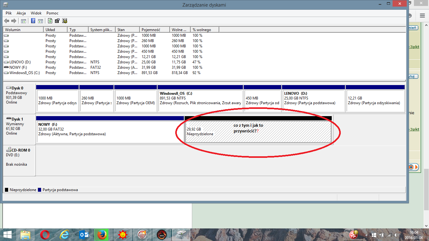

    Does anyone know why after creating the system recovery disk or something like that on the usb in Win 8.1 with a 64GB pendrive only 32 GB was made for me?
    Can it be fixed somehow?
    Aida 64 still sees this flash drive as 64GB.
    I am asking for any help.

    Probably a 32 GB partition was created on it. Look for a partition management program. The rest of the disk should appear as unallocated space.

    You can restore 64GB in Windows from, for example, DMDE.

    If this disk is to be used for what it was created for, then changing the filesystem to ntfs - now it is FAT32 - will eliminate this possibility. If you want the flash drive to fulfill its current function, you must use an external tool * or create another partition (for other data) from the disk management level.
    If you only care about the capacity, you can change the partition and file system with the system commands.
    * Since Windows 2000, the partitioning tool implemented on the system allows the creation of FAT32 partitions of a limited size. For larger than this limit, as exemplified here, the default filesystem is ntfs.

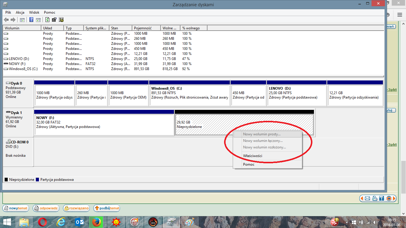

  • #10 15306943
    delphin78
    Posts: 33
    64GB Samsung Pendrive - Change the capacity from 64GB to 32GB.
    and what next ?? You can see that two partitions have been created.

  • #13 15307063
    delphin78
    Posts: 33
    Unfortunately, these options do not light up.
    Added after 3 [minutes]:
    From what I associate, it was similar even in WinXP with this disk management.
    Better to ask and disgrace yourself than to act as daring and screw up. Whoever asks does not go astray as the old proverb says.
    After all, I wrote that it is impossible, because it treats it as a removable disk, not a local one, so the options will also be unavailable. For pendrives, the options to create partitions and select the size are not available, I have already done this. I have more than one pendrive divided into partitions. On any PC other than my Windows PC, it sees only the first partition, while for me it is all written in the registry, so that it can read the system this specific device (it does not treat it like any other pendrive).
    This 32GB partition is to remain? Do you want one 64GB?

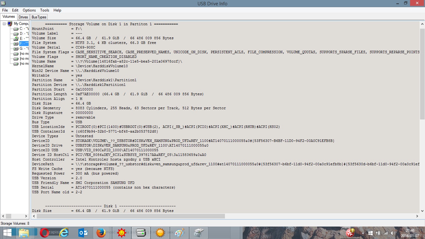

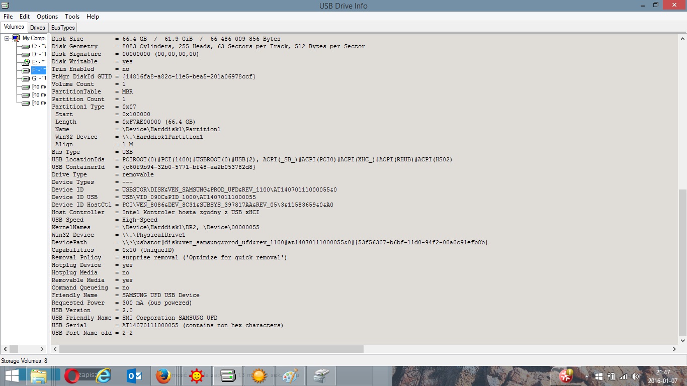

    OK. Thank you for all your help and understanding. I have one more question. I wanted to go back to FAT32 from NTFS but all I can do is some exFAT. Can I do something about it or not?
  • #27 15311651
    delphin78
    Posts: 33

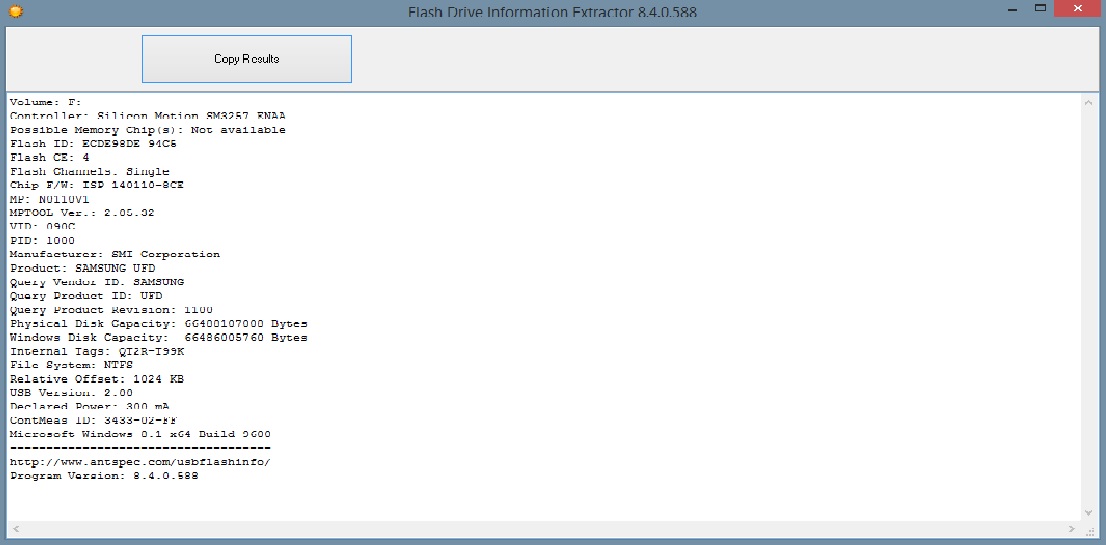

    Hello. The pendrive theoretically works and it returned to its original capacity. I noticed that the ones I have are smaller because 8GB and 16GB are FAT32 and the repaired / restored 64GB somehow is either NTFS or exFAT. In the exFAT file system, unfortunately the car radio does not see the pendrive. Is it possible to restore it to the FAT32 file system ???
  • #29 15311796
    delphin78
    Posts: 33
    Where can I find this ChipEasy program?
