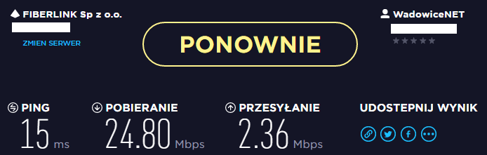

    I have a problem with "silent" internet on my TV as in the subject.
    I can say that when I watch something, e.g. on Ipla, it is fast once and the next time slow. Internet 20 Mbit per second. I have two routers: a ZTE pedestrian and a second one connected to it - Sagemcom. The supplier said that the latter has better coverage. Of course, the TV connected to the router via Wi-Fi.
    I am asking for help from people oriented about my problem.

    longi92
    Posts: 108
    Rate: 22
    In total, no one guaranteed me, but the connection, optical fiber and laptop does not have any problems.
    • LG LED 43LH615V: Inconsistent Internet Speed on Ipla App, 20Mbps, ZTE & Sagemcom Routers Speedtest.png (17.5 KB) You must be logged in to download this attachment.

    longi92
    Posts: 108
    Rate: 22
    I agree that TV is not a computer. But if you explain to me, I watch something fluently, but not the second time. Yes, I do speedtes at this time and everything is ok. I was thinking initially about connecting directly to the router with a TV cable and this will probably be the first step I will take. Well, but first I wanted to ask experts in this field.

    longi92
    Posts: 108
    Rate: 22
    I come back again with the topic. Plugging in the cable resolved the problem, but unfortunately the TV is in the second room separated from the router by a wall. Is there any other solution that could amplify the signal? Is it left to buy the cable and make a hole in the wall?
    PLC - internet via power socket.
    longi92 wrote:
    I watch something smoothly once, but not the second time.
    Since this is a wifi network, there may be dozens of other networks (working on the same channel), or the wifi signal is insufficient.

    KOCUREK1970 wrote:
    If it's a wifi network, there may be dozens of other networks there
    If you mean, apart from my wifi network, is there any other available, then I answer, no. Unless I misunderstood you?
    Based on what do you think so?
    Could be based on a signal search on a laptop. He always searches for one (mine).
    Please try to connect in the mall, I agree that there are many other chains.
    This does not mean that there are no others there - it means that in this place the laptop temporarily finds nothing - if it was otherwise, the wifi would work the same way all the time, not that it works once and not once. Uninterrupted wifi always works the same (because what is the signal to interfere, and the radio in the router always works the same).
    But since the RJ45 cable works - it's either a PLC or a twisted pair cable.

    longi92
    Posts: 108
    Rate: 22
    I chose twisted pair and it solved the problem.
