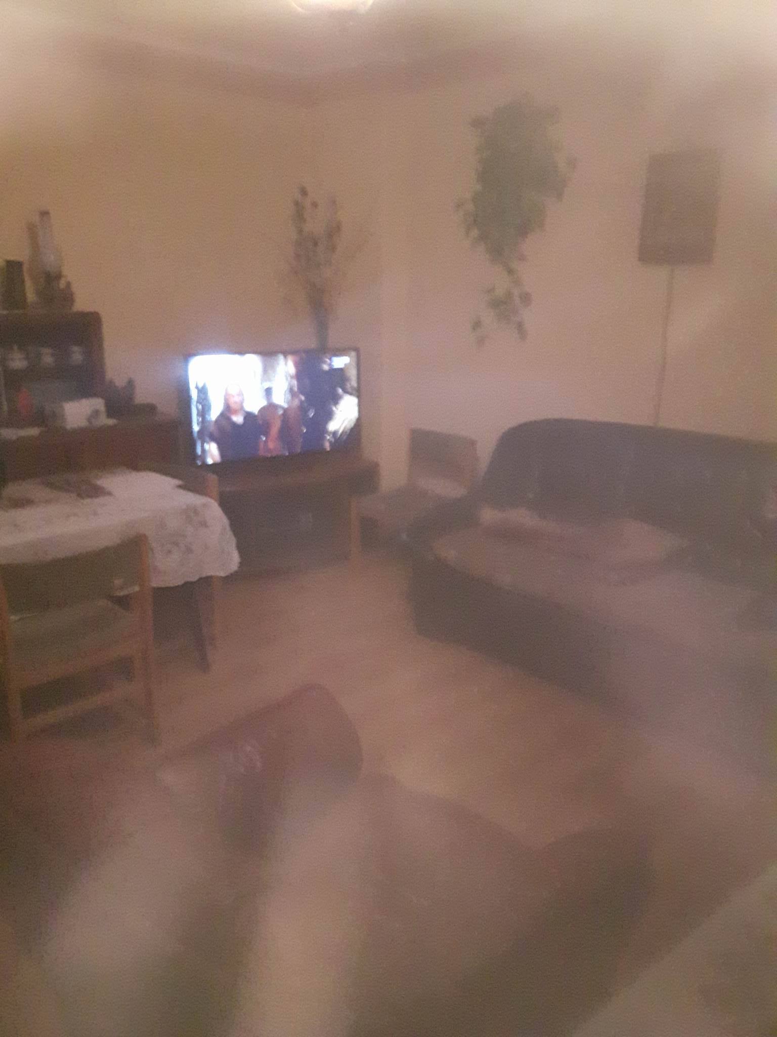

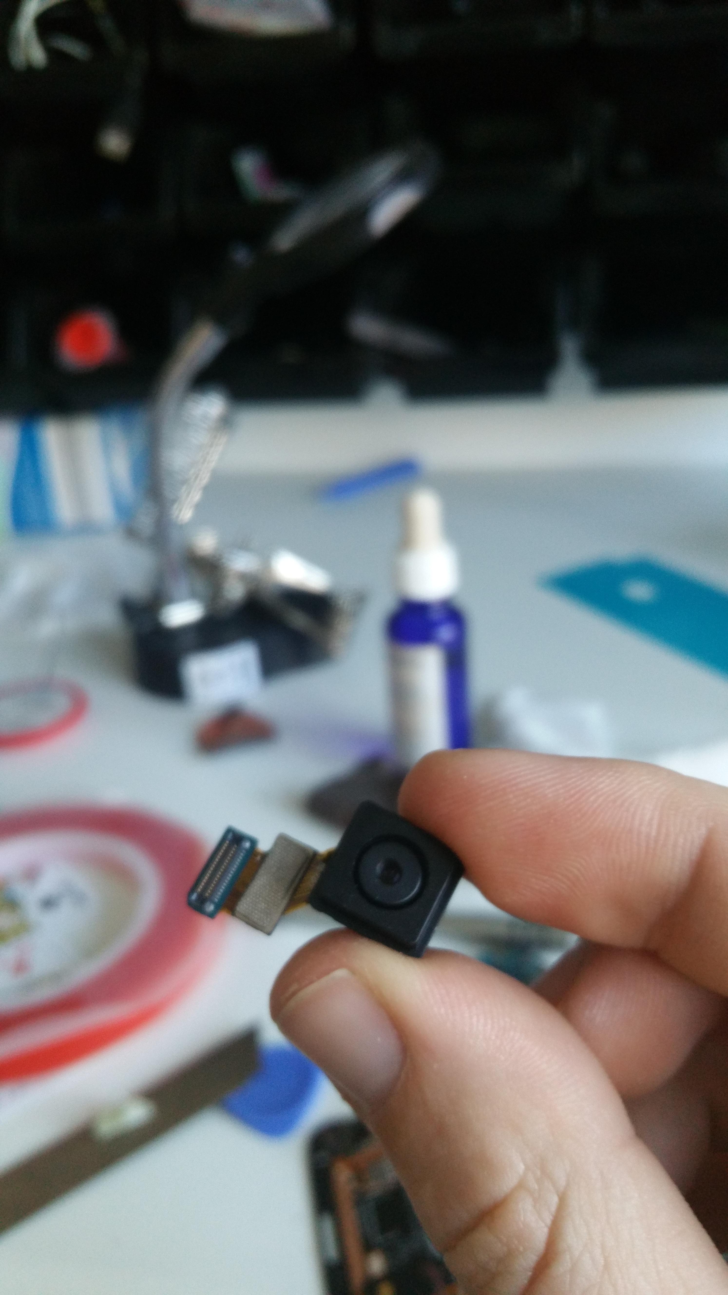

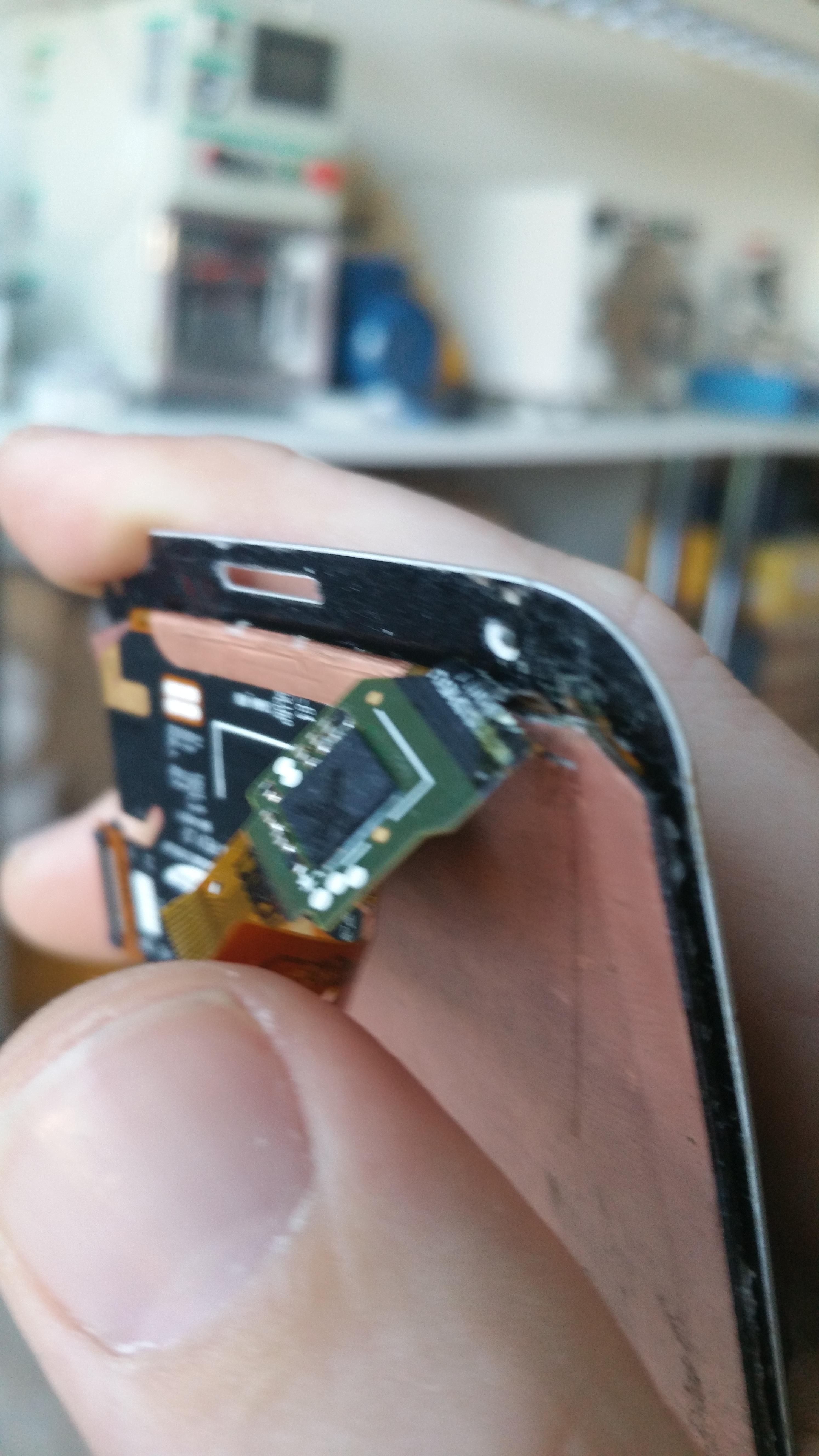

    Hello, I am writing because I have a problem with my phone. I had some action at home today and the glass on the camera (in the back) got a little broken inside. I took out the glass and the frame as it was on the video (yt).
    I tried to clean the remains of the glass with toilet paper. It seems to me that there is no scratch on the camera.
    I took photos with a broken glass and without it after taking it off.
    I am asking for help, because I need a working camera as soon as possible.
    Does the warranty cover something like this?
    How much can the service cost?
    How much can the whole camera cost to replace?
    Can you fix it yourself?

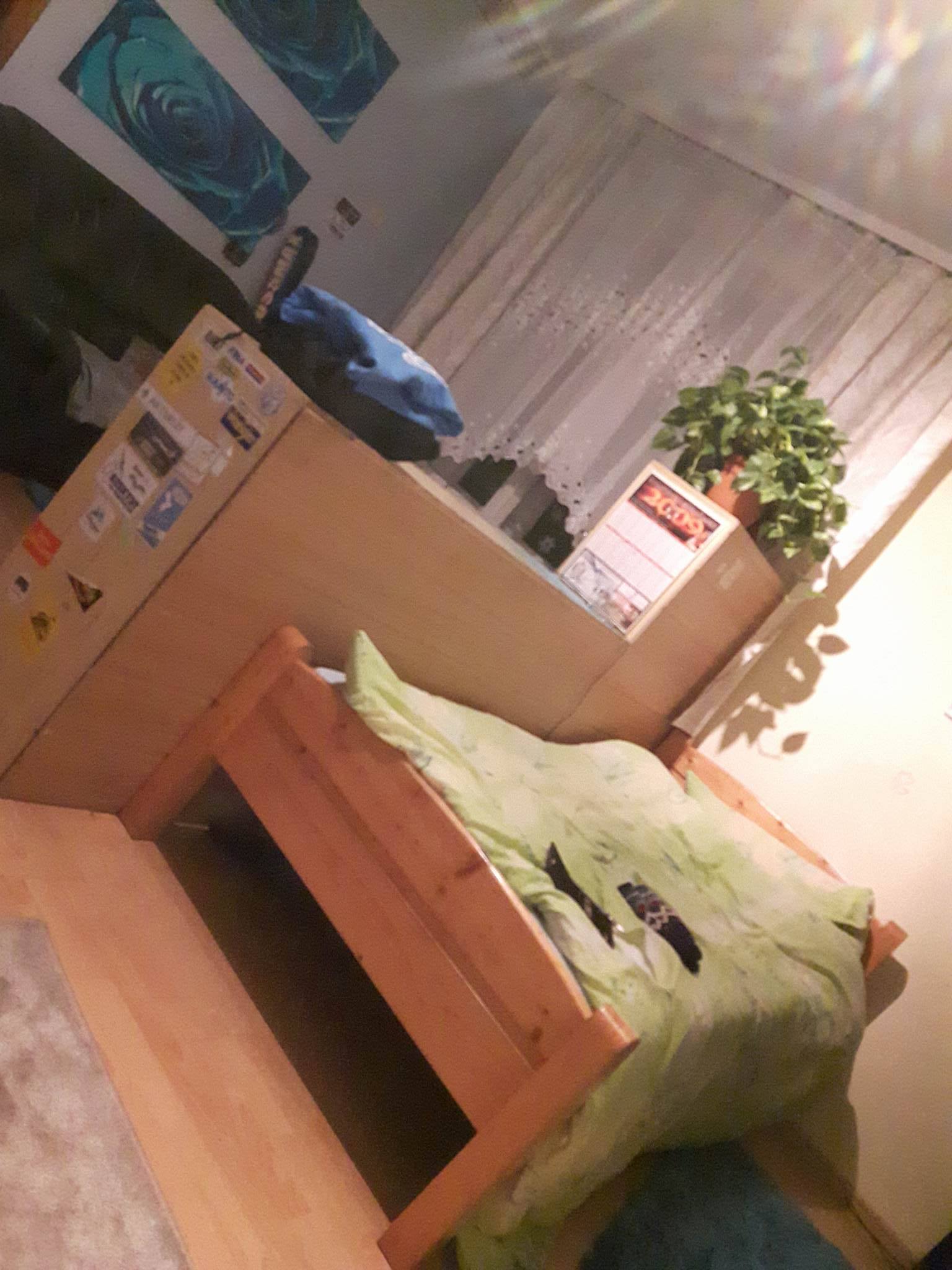

    Ps. I attach photos in the attachment Photograph 1 is still fast: Photograph 2 is no longer fast; picture 3 is taken of course without glass; picture 4 is an attempt to catch the focus up close.

    You need to replace the camera quite possibly damaged. Home exchange is risky. As you have no practice, it is very easy to damage the lcd and costs almost as much as a phone.
    I recommend replacing the camera and the slide. On the forum we do not price repair but it certainly will not be PLN 50
    The warranty does not apply because you broke the glass as you wrote

    Unfortunately, you won't change the s5 yourself, you must first download the display. I do not recommend doing this myself. The display itself probably would not damage, but the tape from touch already. I have several displays from customers who tried to download the display themselves. The camera itself is very easy to replace with a ribbon
