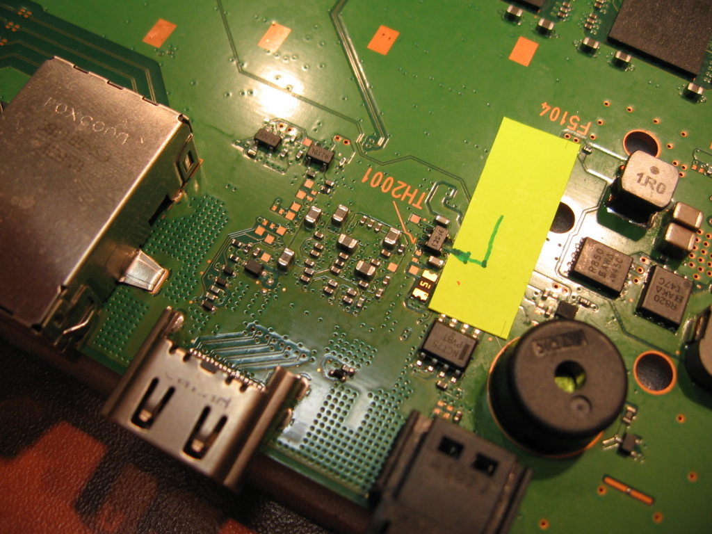

    I got a Ps4 console, the console starts up, white bar but no image on the screen.
    The HDMI port had no visible damage so I replaced the Panasonic MN86471A but it did not work, then I replaced the hdmi socket but it didn't change anything.
    And the question, where to look further?
    best regards

    At the HDMI socket there are ESD protection diodes, did you check them?

    Thanks for the suggestions.
    I have successfully repaired the console.
    The element marked on the photo was damaged (I soldered from another PS4 board).
    Question for the future what is this item and can you buy somewhere?

    How did you check the item? Did you put it to the test or did you make any measurements?
    I probably need to replace the encoder, but I would prefer not to generate unnecessary costs and check other components.
    best regards
    I took measurements (the reference was another functional board), the indicated element and one diode were damaged (if I remember correctly).

    Heats up the topic, I have a similar case someone could give me the values of this element what would I damaged?

    The circuit from the photo is a converter from 5V.
    You have a fuse at its output.
    There must be 5V on it when the console is turned on. If missing, a defective fuse or inverter.
