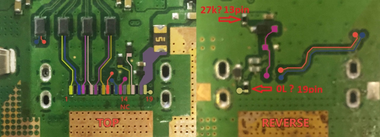

  • #5 17028854
    maqniool
    Posts: 22
    Hello, I suggest you check all connections between the hdmi socket and filters, all masses and the rest of the connections, often only such a small thing can cause problems
    Regards

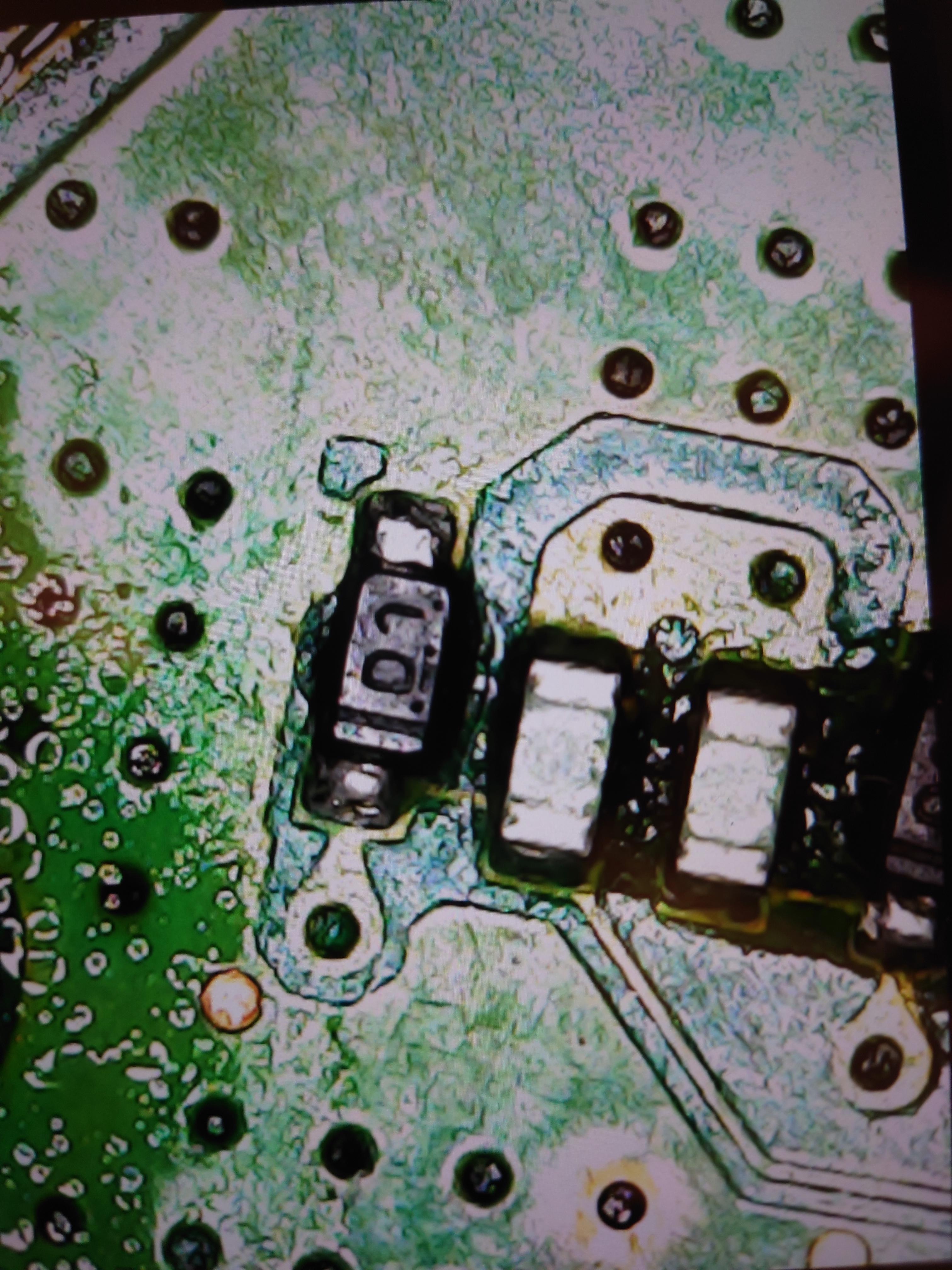

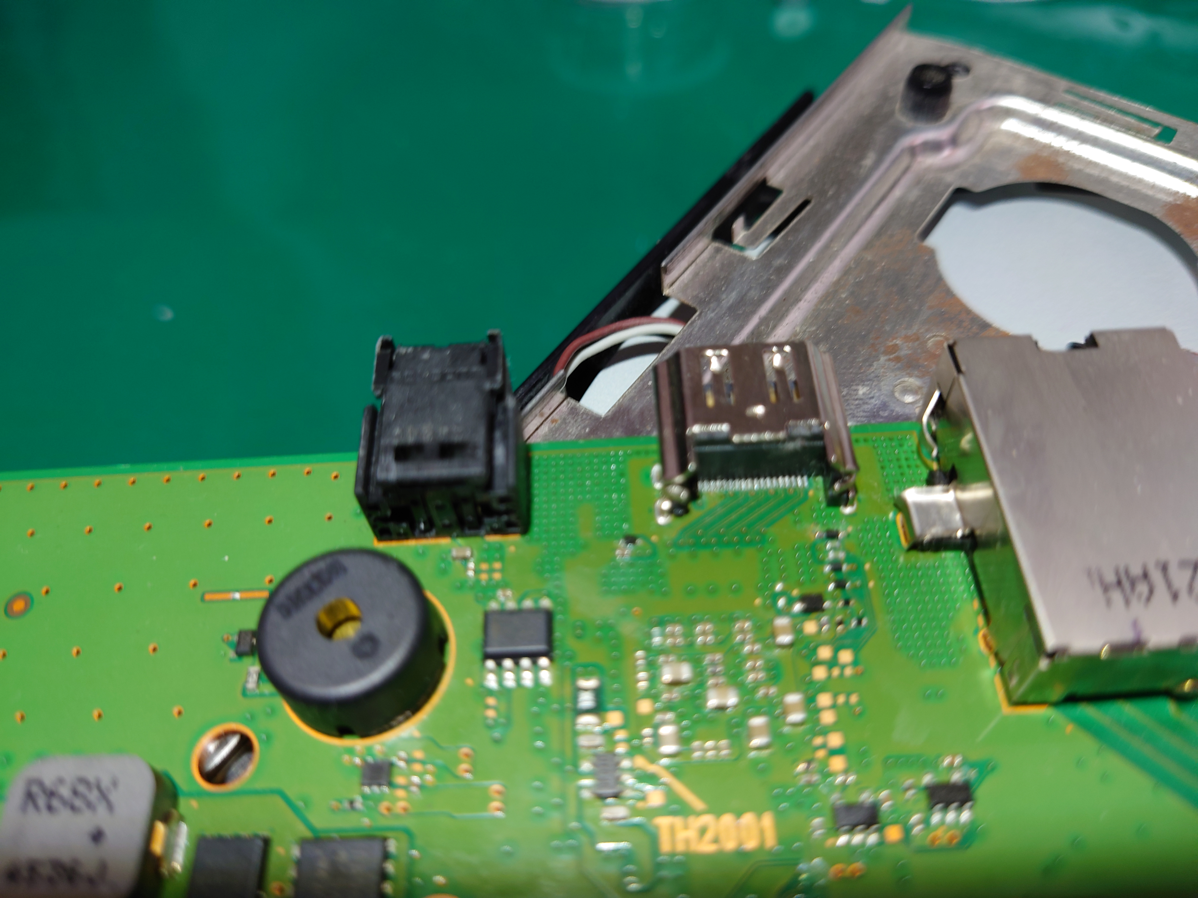

  • #6 19662073
    tomek23ok1
    Hello dear users of elektroda.pl
    Did you fix the No Video issue?
    I have a problem after replacing the socket and measuring all the LEDs, I still have white light without a picture, the filters are also working, the resistance above which would indicate a short circuit in the controller.
    The only thing missing was a small diode on the sab-001 board.
    Anyway, everything looks fine.
