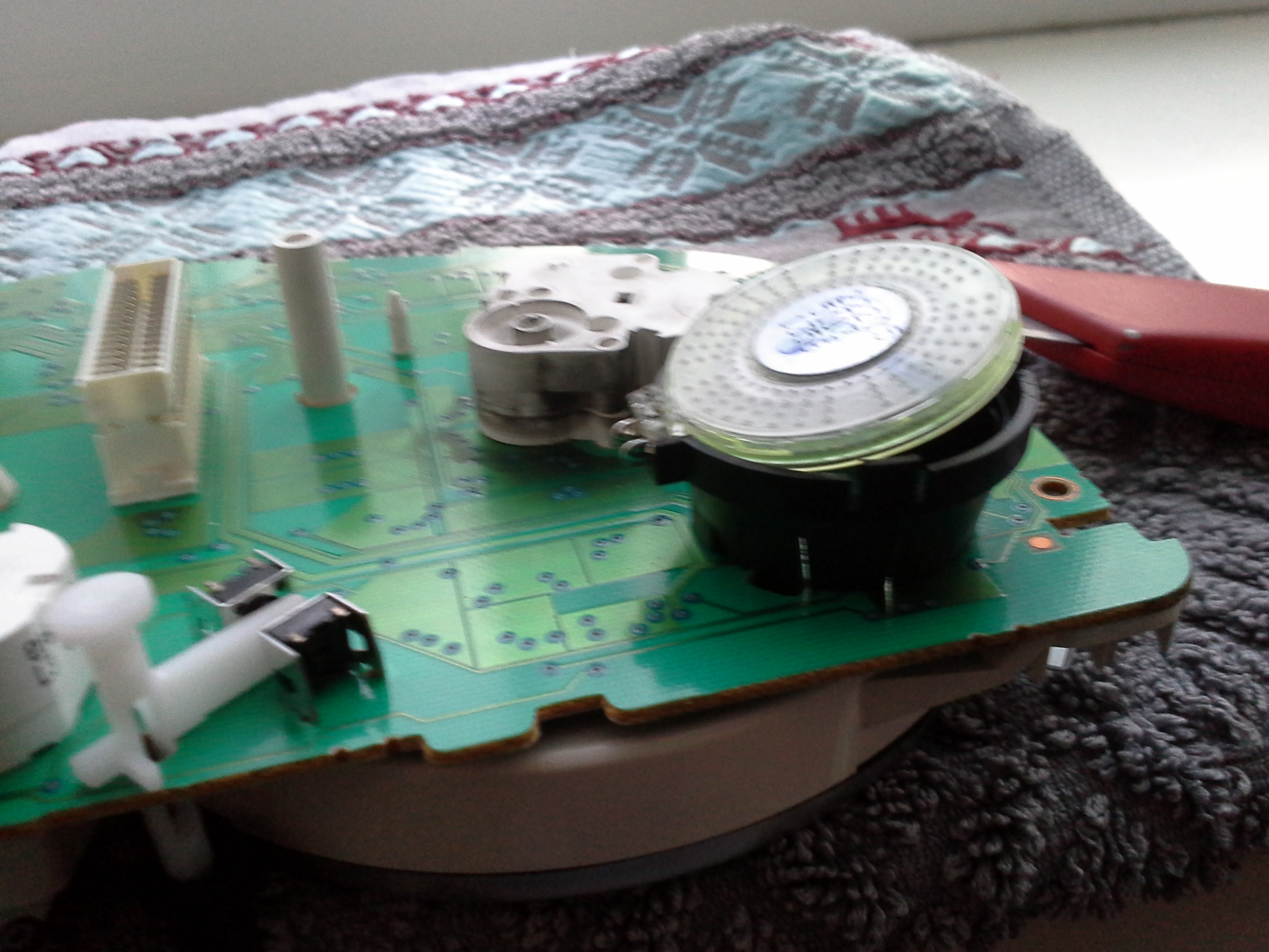

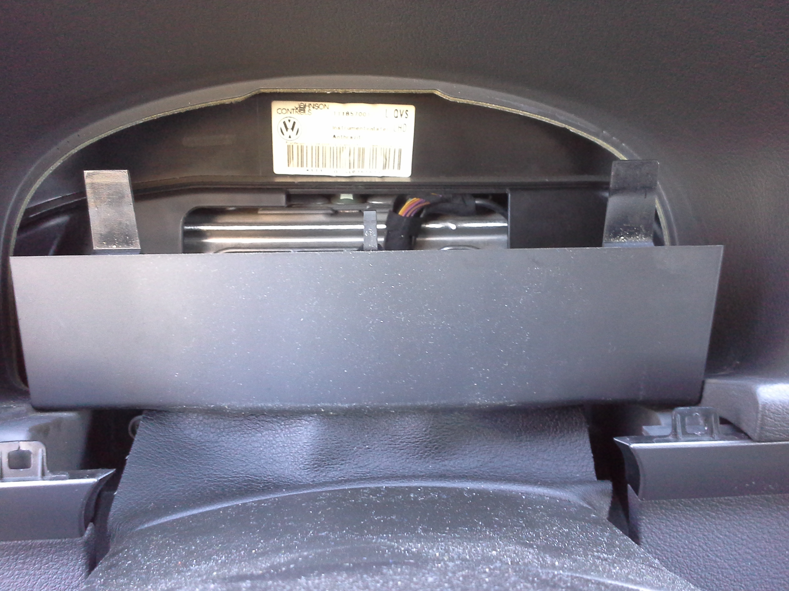

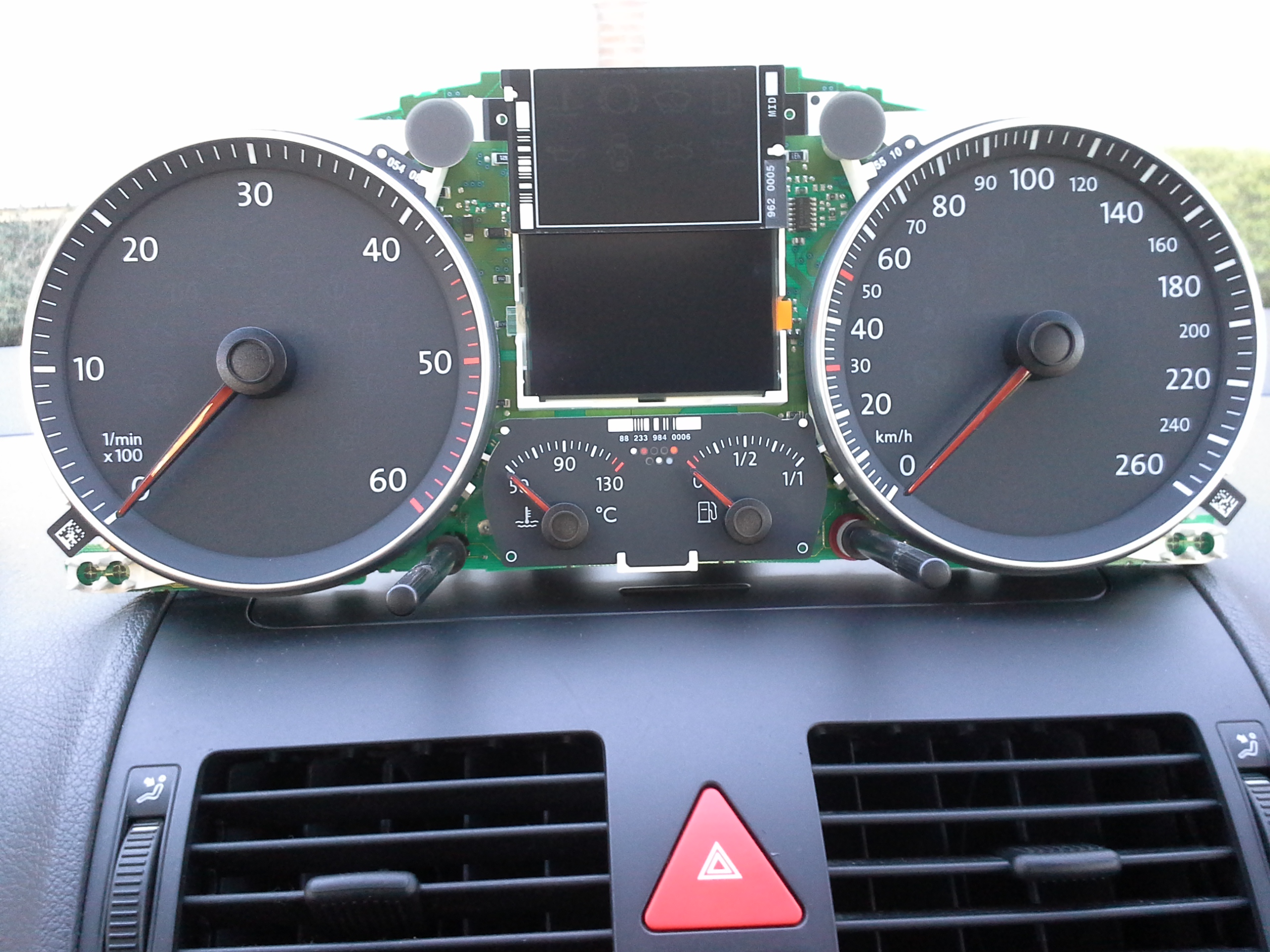

    In my Touran there are no warning signals probably buzzer speaker. Directions work but do not tick. No sound about left lights info about unfastened belts very quietly. I got to the forums that a broken speaker, just how to get it ?! I didn't find enough information. I took care of myself it took me a long time to damage nothing delicate G. I will try to describe it and add a few photos, maybe someone will use it. Extend the steering wheel and pull up - pull the small cover over the steering column together, the protective material is gently glued - unscrew the two BLACK screws on the torx remove carefully and drop down! - take out the meter outside - there are latches 6 pcs around gently pry at least two and split the housing - the clock and display plate is screwed on the back with two "golden" screws unscrew a little and push inwards it is easier to remove the clock plate. the rest in the pictures. The speaker is soldered under the tachometer !!! To get rid of clocks you probably need to get rid of clues I haven't done that anymore. I am asking for info if it was useful to someone. Good luck VW Touran 19 tdi 2005 dismantling of clocks not working buzzer VW Touran 19 tdi 2005 dismantling of clocks not working buzzer VW Touran 19 tdi 2005 dismantling of clocks not working buzzer VW Touran 19 tdi 2005 dismantling of clocks not working buzzer VW Touran 19 tdi 2005 dismantling of clocks not working buzzer VW Touran 19 tdi 2005 dismantling of clocks not working buzzer VW Touran 19 tdi 2005 dismantling of clocks not working buzzer VW Touran 19 tdi 2005 dismantling of clocks not working buzzer VW Touran 19 tdi 2005 dismantling of clocks not working buzzer VW Touran 19 tdi 2005 dismantling of clocks not working buzzer

    Continued speaker repair. I found similar skoda and passat on the scratch can be seen in the pictures. To check if I used a good 1.5V battery, smear the speaker + contacts and - how it reacts, I broken the gently out of the housing and desoldered, I put it in a dash. I put it in the car and EVERYTHING works !!! I don't know how long the used one comes from, but I have one in stock and the next repair is about 30 min VW Touran 19 tdi 2005 dismantling of clocks not working buzzer VW Touran 19 tdi 2005 dismantling of clocks not working buzzer VW Touran 19 tdi 2005 dismantling of clocks not working buzzer
