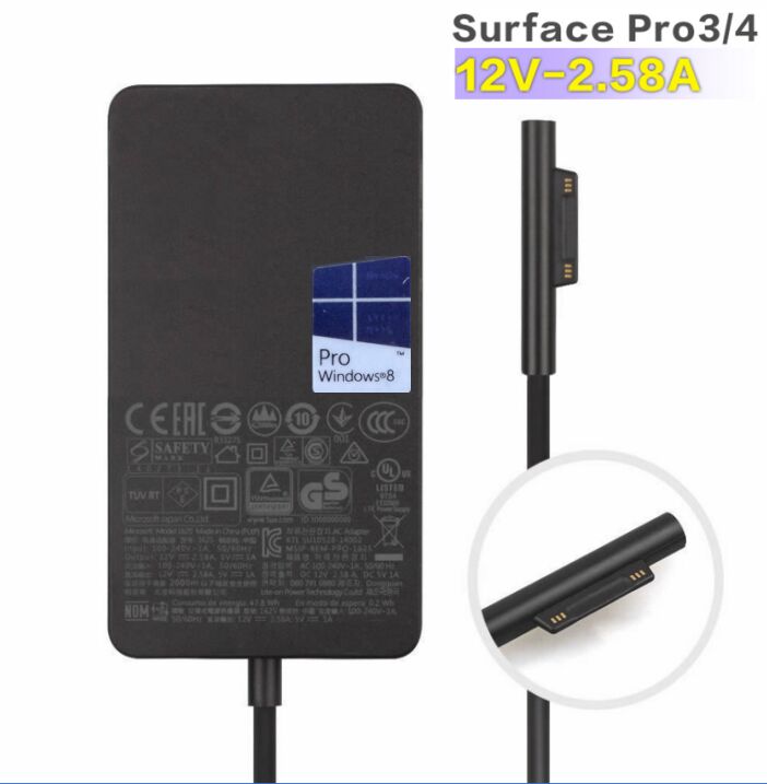

    I am looking for someone who can repair the MS Surface Pro 3.
    The device does not turn on and it does not react to anything, only the diode on the power supply lights up after inserting it into the plug.
    Unfortunately, I have no idea what happened to him and I cut a mine :) it was supposed to be only a broken power supply; /
    Greetings!
    Rafal

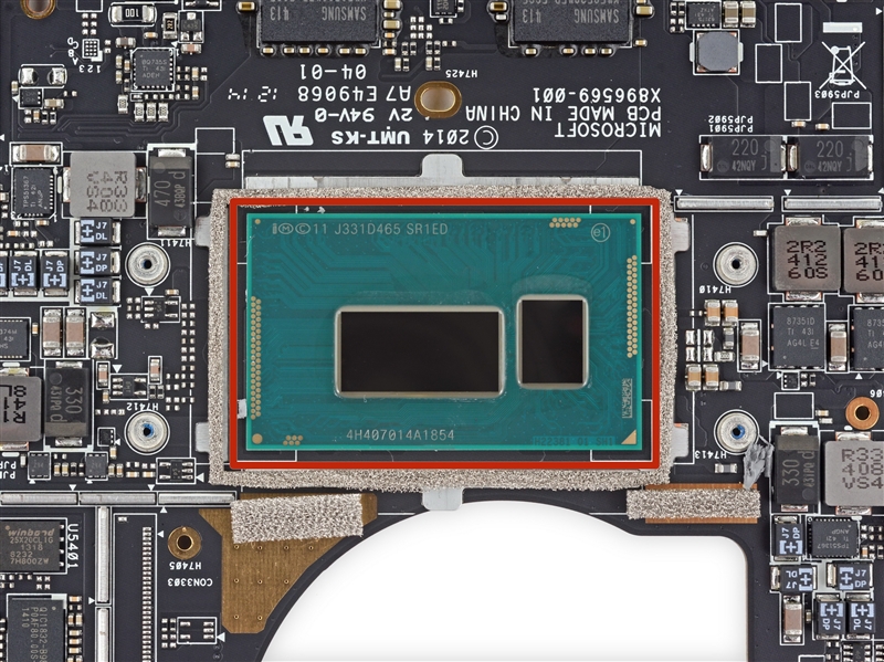

    It will be rather hard to find volunteers ...
    MS product, no schematics, parts, otherwise expensive.
    -most Richtek components, coded
    - they got hot during use! (thickness 10mm)
    I know that in the US they repair not even expensive (only shipping is dying)
    In the UK, look for a service from Indians, or made in China
    Check out the video about pro3 Link

    For those interested, a photo sample from the demolition (approx. 80-90 "screws" and a surprise inside, ver. 10.6 ", HM77, 3rd Gen. cpu (i5-3317U)
    Link_ Surface + Pro_2__ 10.6 "

    Cheapest Argos (GBP 259.99) Pro 3 12 "Windows 8.1 64GB 4GB RAM Intel i5
    Power supply only (Microsoft 1625 AC Adapter for Surface Pro3)
    Output 1: 12V 2.58A, 31W
    Output 2: 5V 1A
    that's over GBP 30

    Thanks fox for the info. And here I don't even ask :) it's hard to find a mechanic here :) I don't even ask for specialists. Bought locally, I will have to take a ride and my friend was supposed to chase everything after replacing the power supply. Unfortunately, man loses his vigilance here because most people can be trusted with a word. We'll see what it will be just a pity those GBP 200.
    Thanks in advance for the info, but I can see that it's probably a waste of time to look for someone to fix it.
    The only thing that works is the power lamp when connected to the device. Do you know if it lights up when the record is broken?

    The charger_switch used was MAX17817, hidden in Aku.
    * from the MAX17806, MAX17808, MAX17812 family, something ala on
    See the MS page about this Pro 3 Link
    Those on this site say Pro3 is "unrecoverable" Link
    * Pl translation Link
