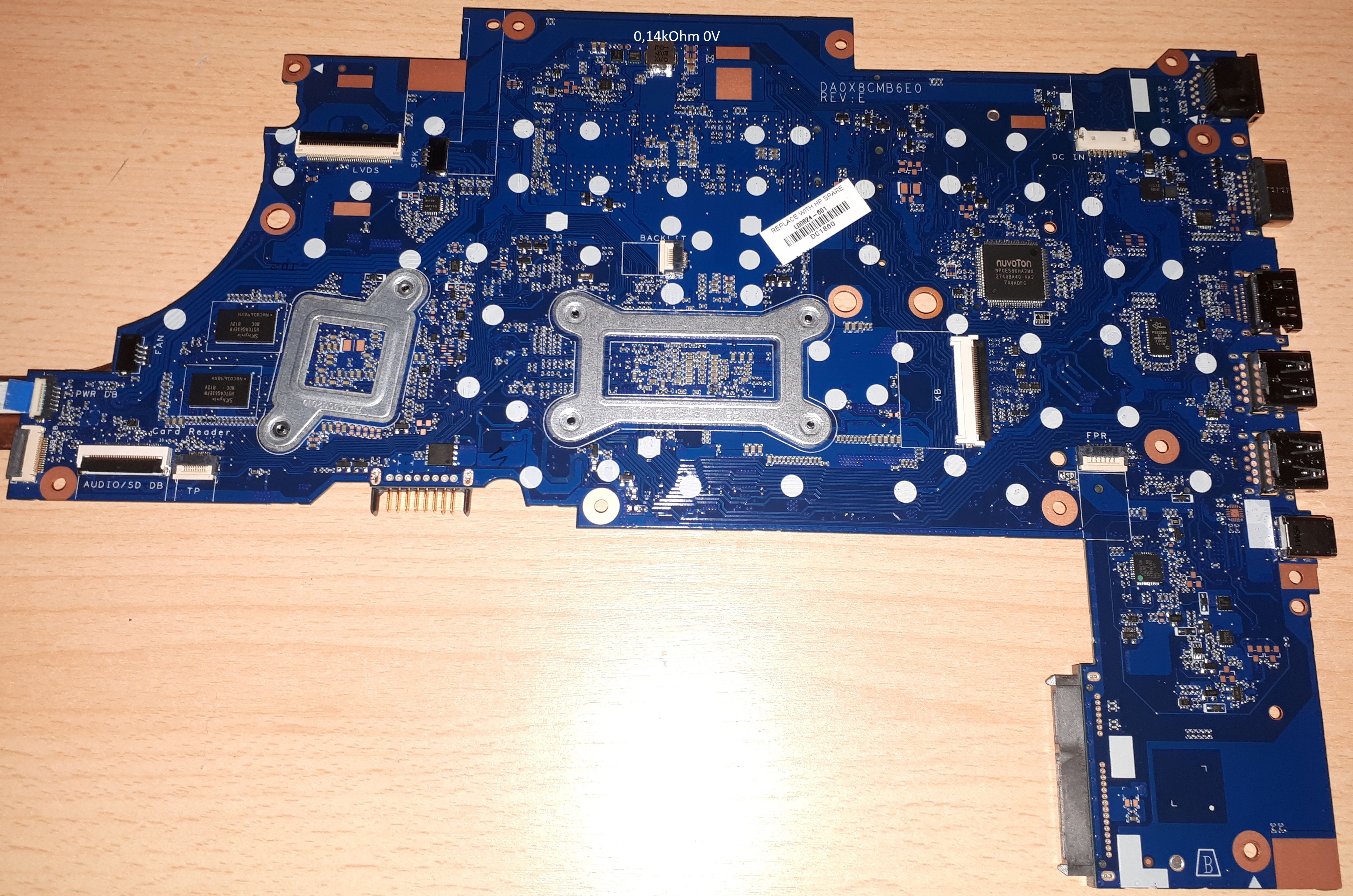

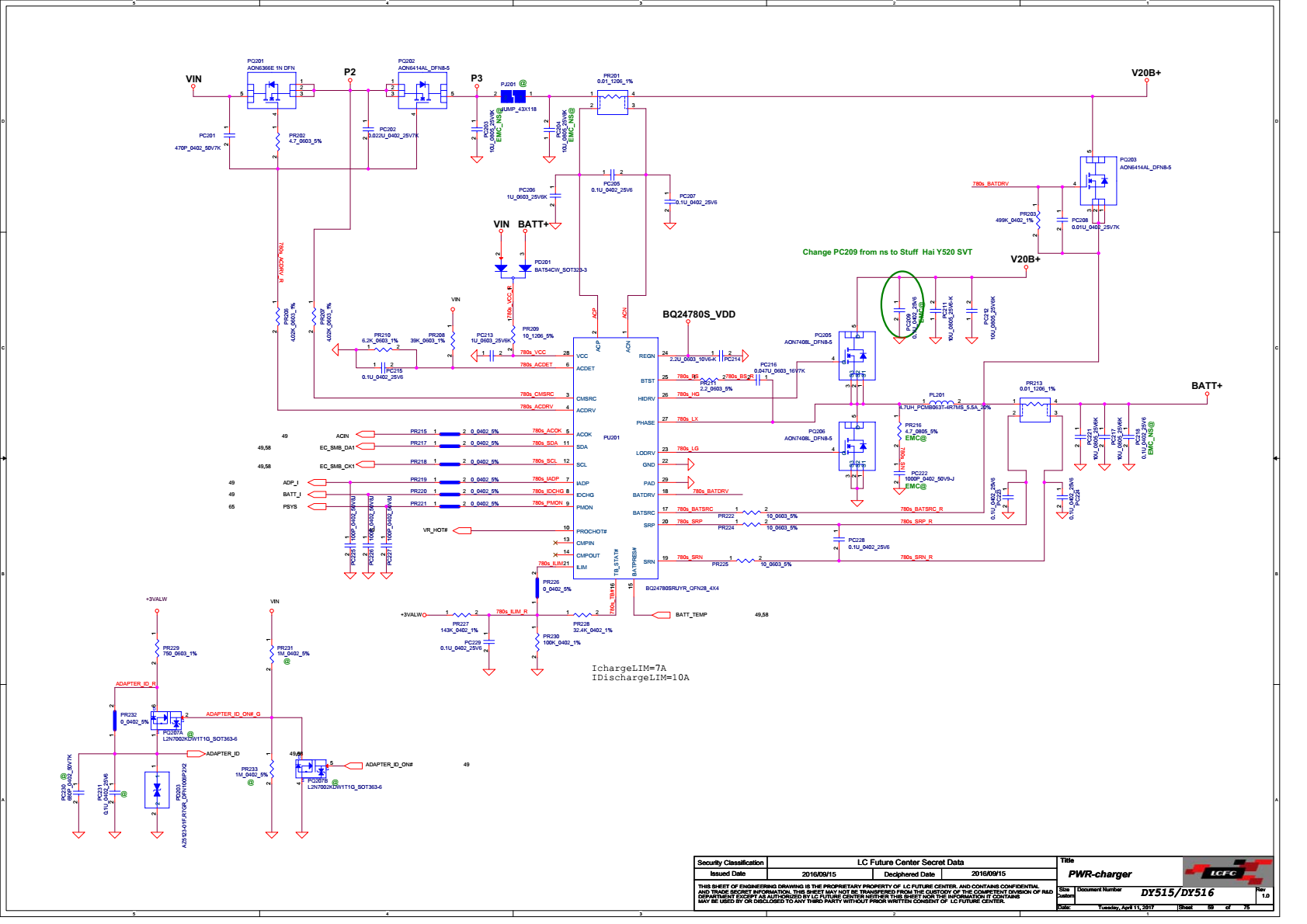

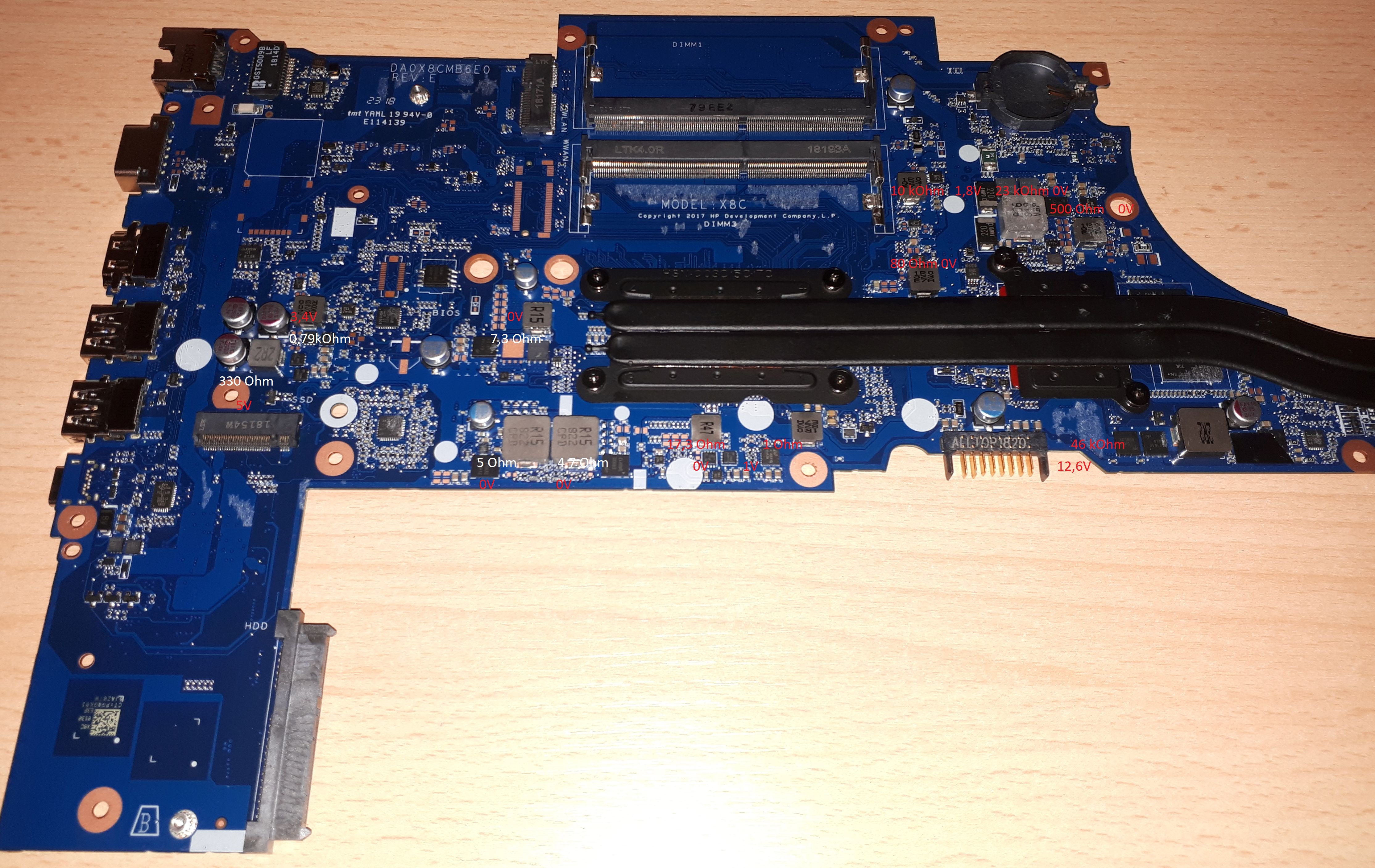

    Probook 450 G5
    board DA0X8CMB6E0 REV: E
    After connecting the power supply (tested on 2 original power supplies):
    -power LED flashes orange
    -does not respond to the power button
    -the processor heats up
    -voltage on pin id 19,18
    -after connecting to the board, the voltage on the ID pin is 1.3V
    -current consumption 0.66A
    After connecting a charged battery:
    I am attaching photos with measurements

    One of the 6 topics about this album gives a link to SM Link
    This is a board with 8th gen CPU
    HP ProBook 450 G5 15.6" , i5-8250U , MB: DA0X8CMB6E0
    ps
    HP PROBOOK 440 G4 MB: DA0X81MB6E0
    * Quanta Reilly 13"/Rourke 14" platform
    kbc NPCE586HA 0MX
    Flash Bios GD25B128CSIG
    charger PU1 BQ24 780S RUYR
    3/5V on PU25 RT6575AGQW
    MS similar Link_ probook-450-g3-quanta-x63-da0x63mb6h1

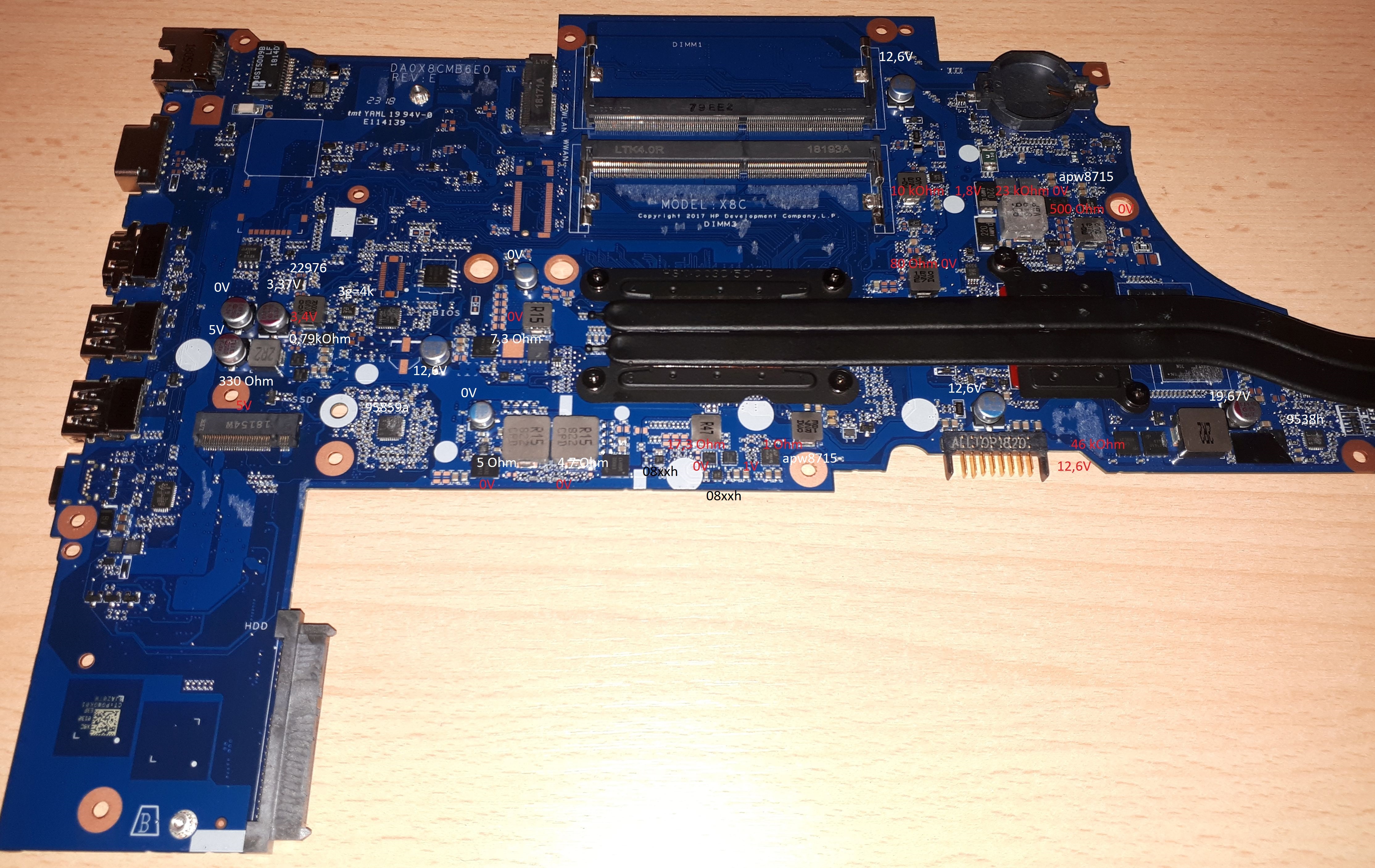

    RitterX wrote:
    xxl245 wrote:
    I don't have sms for this CD. Can you describe what I should measure based on the photos?
    From what is marked in the photo you have 3.3V/5V and 1.8V for RAM. There is no graphics converter voltage in the photo, the left photo is lower right corner. The voltages as you provided mean little because they do not concern the measurement points. Specifically on the advantages of electrolytic capacitors.
    Near the processor, all converters should have voltages higher than 0V, but this is probably not the case. KBC chip, right photo, large chip with Nuvoton written on it, is it warm, cold, hot?
    "left photo, lower right corner" is probably battery charging and I have 12.6V there.
    I have the second disc to compare.
    The only difference in the resistance of the coils is the coil at the processor where I have 1Ω 1V (after removing the coil, the resistance is on the processor side) and on the working board it is 80Ω 1V
    KBC room temperature
    I will post the voltage measurements on the capacitors tomorrow morning.

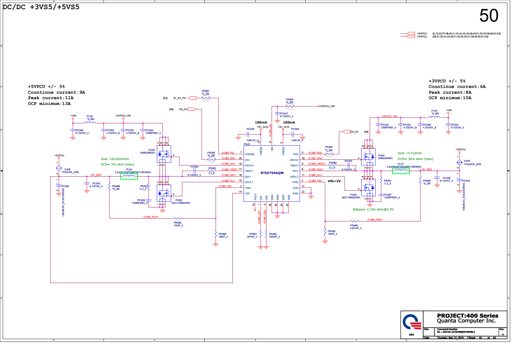

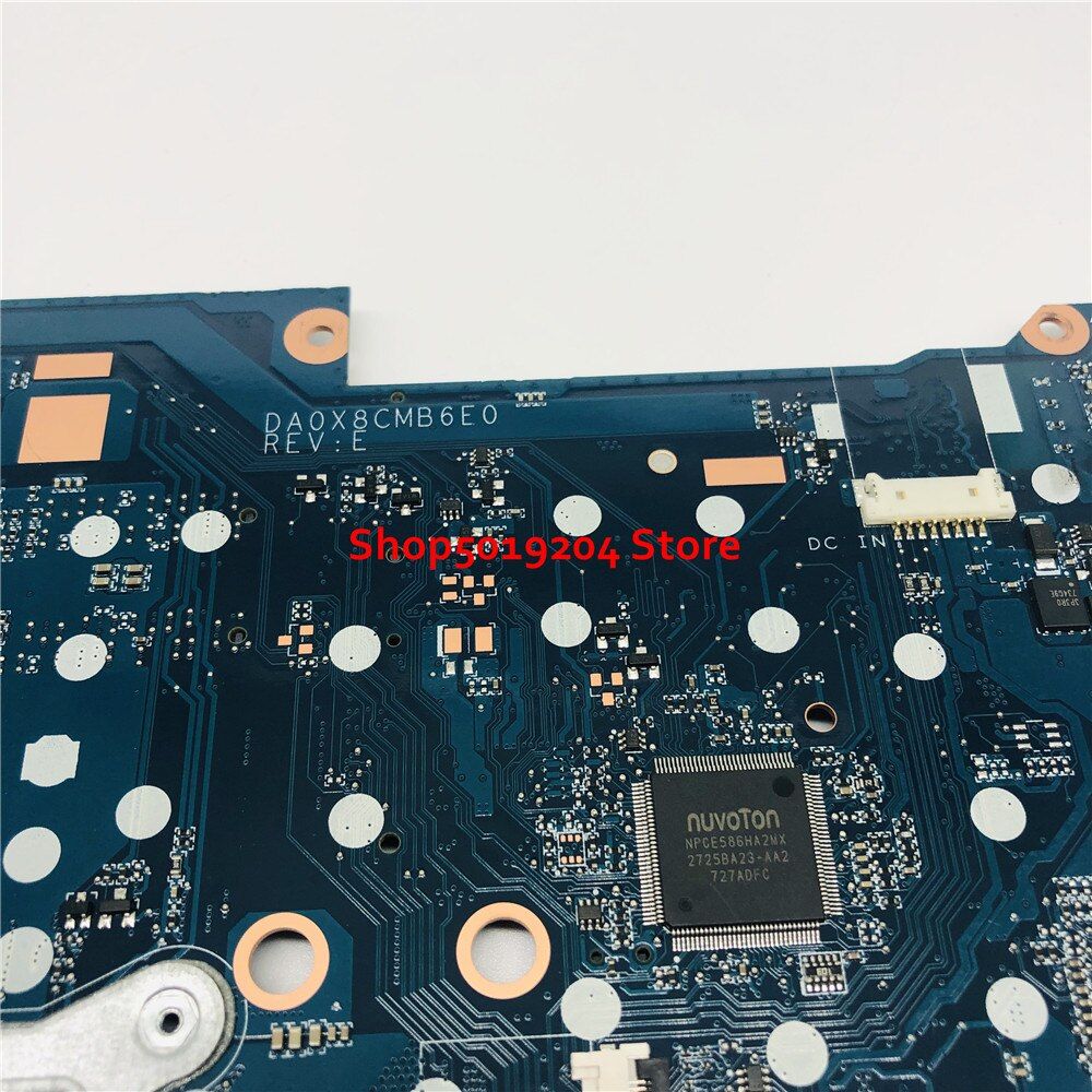

    If you have RT6575 for 3/5V, the charger must be, as I wrote, BQ24780S
    - HP Probook 470 G5 (DA0X8CMB6E0 Rev E) cpu e.g. SR3LC (i7-8550U)/ i5-8350U SR3LA
    * plus GeForce 930MX 2GB
    * kbc NPCE586ha2mx
    HP Probook 450 G5 Charging LED Issue: Orange Flash, Processor Overheat, Power Button Non-Responsive
    the one on the left is V_Core *code (08 xsd) i.e. ISL95808HRZ-T
    The one on the right... give a description
    ps
    It is still available in mb ISL95338 Link
    rev.F without add. graphics
    * kbc NPCE586ha2mx
    ps
    On the left, yellow arrow APW8715
    On the right, a green arrow, Intersil 9538h

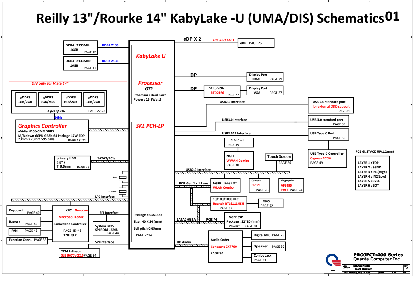

    Give descriptions of the remaining arrangements. integrated into QFN or WQFN objects
    In the photo I found:
    ISL95859A Multi-phase 1+2+1 Core Controller
    NCP81172 VRAM 3-phase per chip + one on memory
    APW8868B DDR3L Link
    RTD2166 DPort to VGA translator
    RT6575 WQFN-20L 3/5V

    RitterX wrote:
    If you have a significantly lower resistance value in the processor power supply branch, first check all MOSFETs of this converter. You measure both source-drain and source-gate on the diode range. You won't be able to go any further without the Hot Air station because at some stage you will have to desolder, for example, a suspicious transistor. You may have a short circuit, e.g. caused by a ceramic capacitor.
    However, after removing the coil, the resistance goes straight to the processor, so there is no point in checking the mosfets.
    I have hot air in stock.
  • #18 18518803
  • #19 18534674
    xxl245
    Posts: 397
    Help: 17
    Rate: 39
    RitterX wrote:
    If you have low resistance to ground in the branch, the first thing you check, or disassemble for testing, are the MOSFETs. Even if the line is almost 0R, a damaged MOSFET may have a transition not only on the SD connector but also on the SG connector.
    You don't measure the coil resistance in series, but with respect to ground. This is a good orientation point because, unlike capacitors, it is usually one per phase and has large leads that are easy to grasp with a probe.
    I checked the mosfets and they were not punctured.
    Finally, I replaced the disc, so the topic can be closed

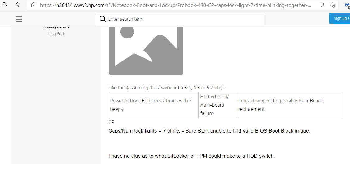

  • 7-flash caps lock fault persists after ME cleaning

    Now I also have such a laptop with the DA0X8CMB6E0 REV.E board
    The first symptom was the caps and num lock flashing 7 times, no reaction to power, even the fan did not spin. It was not very convenient because the codes on the HP website and everywhere are described for up to 6 flashes. After cleaning the ME, the symptom is the same as described here, i.e. the orange LED is flashing (tried on several power supplies) and there is no reaction to power. At the moment, after such a general inspection and measurements, including analyzing what was written here, it is not clear what to catch here.

    There is a video of 7x flashing, but HP does not describe where and what is damaged
    Link
    *from the HP forum Link

What is PU20 APW8715 (+1.5V_GFX) and should it be present at idle?
+1.5V_GFX is generated by PU20 APW8715 and supplies the graphics domain. It is a 1.5 V, ~4 A rail. Verify its enable and output near PU20 with the boardview. Presence depends on power state and platform configuration. [Elektroda, lisek, post #18511933]
Will cleaning Intel ME fix a 7‑blink or orange‑LED no‑boot on this board?
One case showed 7 blinks that persisted after ME cleaning. Afterward, the unit reverted to the orange‑LED, no‑power condition. This suggests power‑rail or hardware faults, not just firmware, so complete electrical checks are essential. [Elektroda, VVoSeba, post #19322337]
What does 7x Caps/Num Lock blink indicate on this platform?
7x blink has been observed on similar ProBooks, though HP’s standard tables often describe only up to 6. Treat it as a severe power or firmware signal and validate rails and VRM behavior before deeper firmware work. [Elektroda, lisek, post #19322544]
What other controllers should I know about on DA0X8CMB6E0?
Expect ISL95859A as a multi‑phase core controller on some revisions, NCP81172 for VRAM, APW8868B for DDR3L, RTD2166 for DP‑to‑VGA, and RT6575 for +3/5 V. Identifying each helps target probing points fast. [Elektroda, lisek, post #18517218]
How can I compare against a known‑good board to speed diagnosis?
Measure inductor‑to‑ground resistances and key rail voltages on both boards side by side. Large deviations point directly to the failing domain. Example: ~1 Ω vs ~80 Ω on the CPU inductor indicated a Vcore‑side defect. [Elektroda, xxl245, post #18515282]
Quick 3‑step triage for “orange LED, no power” on HP ProBook 450 G5?
  1. Verify VBAT/+V20B at the DC‑in path and charger output.
  2. Confirm +3.3 V/+5 V rails are present and stable.
  3. Check Vcore enable and voltage, then the RAM rail. Work methodically to isolate the failing stage. [Elektroda, Anonymous, post #18513280]
Is motherboard replacement a reasonable outcome for this fault?
Yes. After verifying MOSFETs and rails without a clear, repairable defect, replacing the board resolved the case discussed. This is practical when CPU‑side faults or multilayer shorts are suspected. [Elektroda, xxl245, post #18534674]
