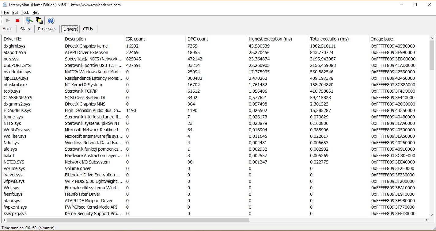

    Mam od jakiegoś czasu poważny problem z DPC latency. Próbowałem już wszystkiego od zmian ustawień zasilania, reinstalację sterowników aż po format dysku jednak bez widocznych sukcesów.
    Wyniki z LatencyMon:

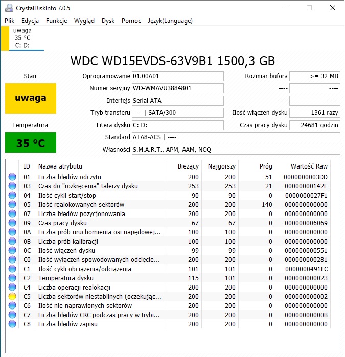

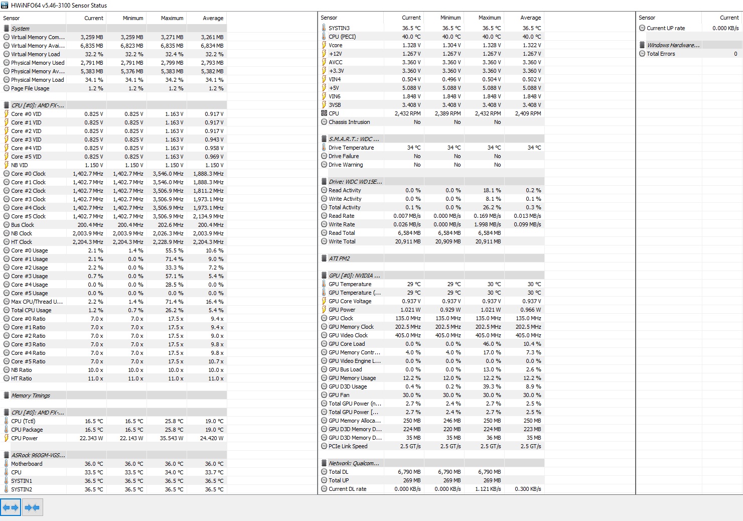

    Provide the rest of the required configuration. Insert SMART from crystaldiskinfo, insert screen from process explorer, screen from hwinfo sensors.
    Do you have a problem all the time or only in games / load?

    the problem mainly occurs in the Steam client and most of the games I own. I also add screenshots of dpclat idle and after maximizing the steam client window

    The disk has problems C5 you can see but 01 should also be 0 for the WD disk
  • #5 16384640
    Krakerus
    i.e. the disk to be replaced?
    Move the system to another disk to isolate latency issues

    Probably yes. It CAN still be used for the warehouse. Looks like she's having surface problems. First, try MHDD and check its access times in general. If there is no tragedy, you can try to reset and remap.
    But as I wrote, it is better to have the system on a functional disk and this one will probably not be like that.
    First, put the system on a different disk and see if that is the source of the problem.

    @Krakerus Replace the disk-to-board signal tape with a new one, as the C7 is communicating connection problems.
    The temperatures are ok, nothing to worry about.

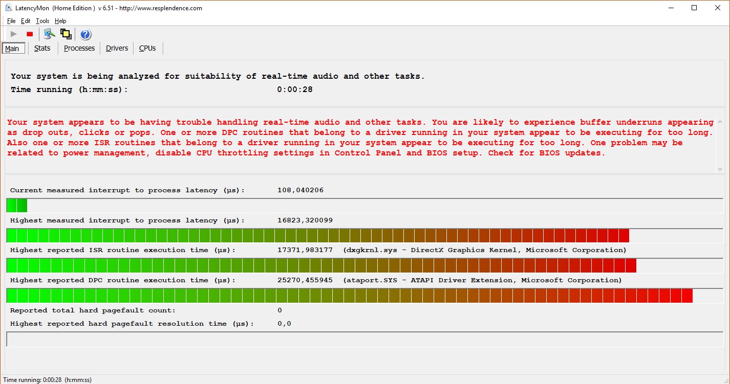

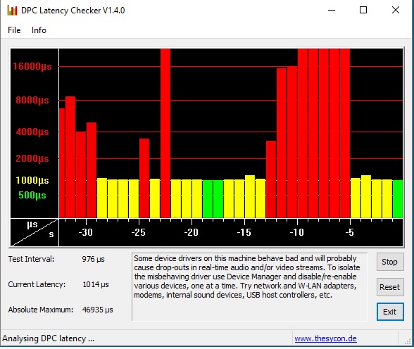

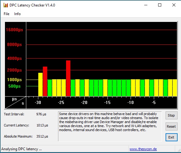

    Yesterday I installed a new drive. I installed the system and all the drivers, unfortunately the high latency and crackling sound problem remained. The rest of the configuration unchanged as in the opening post. I am throwing in the latest screenshots from LatencyMon.

    Let me tell you, I have doubts about this program. Out of curiosity, I installed it at home and also reports such problems to me. The values are actually lower, about 4000 second and fourth position and the third position 500, but the report is the same.
    I'm curious about it
    Measured CPU speed: 1 MHz (approx.) - obvious error CPU can't even work at 1MHz for my CPU shows more but 30MHz is still an unrealistic value ...
    The program suggests that you update the BIOS have you done? Overall, you could give some specifics of the graphics motherboard CPU power supply.
    Out of curiosity, tell me what the system shows you the nonpaged pool - task manager - performance - memory and there it is.
