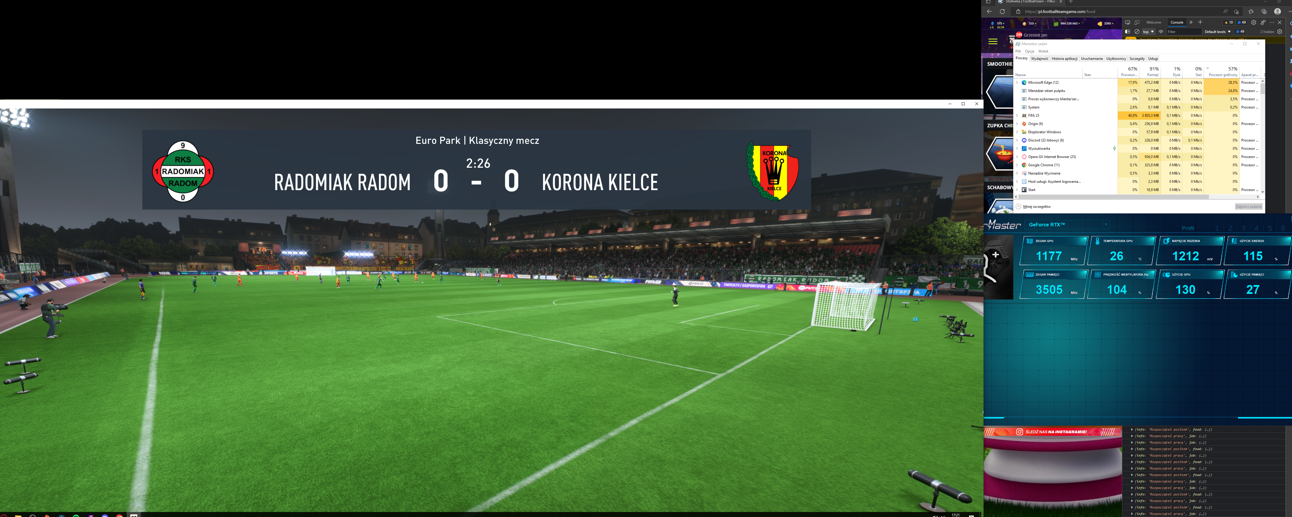

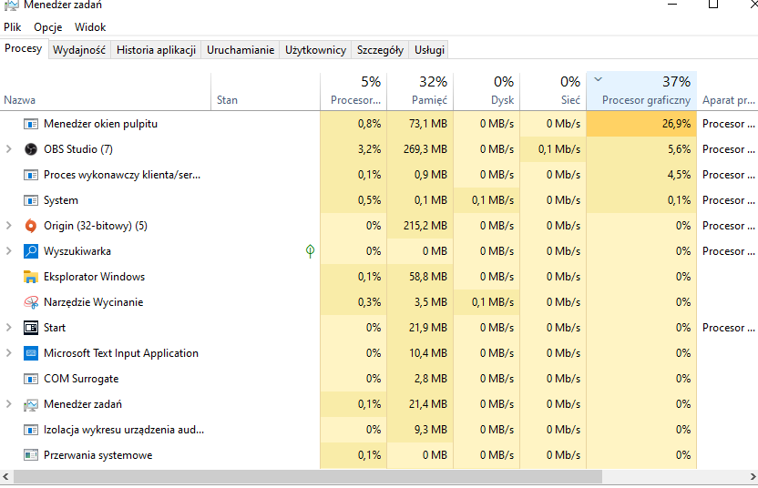

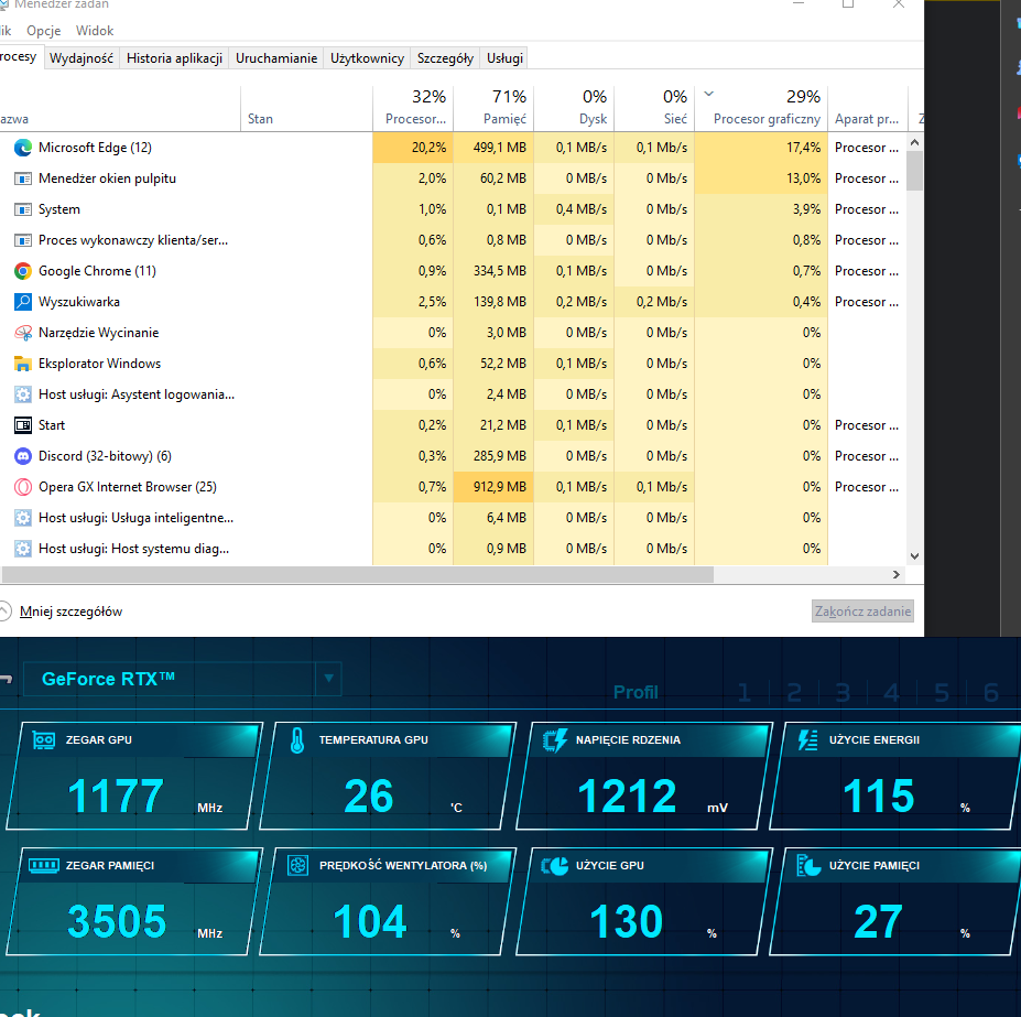

    I've noticed for a while now that the desktop window manager uses a lot of the graphics card, no matter if it's a GTX 1080 or an RTX 3060. I've been digging the internet for 2 days looking for a solution but nothing helps. Maybe someone here can help me?
    Attached a screenshot where at the time of taking it, the only things enabled were origin and obs.
    High GPU consumption by the desktop window manager .

    Run any game and show how it looks then

  • FIFA 23 and OBS trigger GPU usage spike
    #8 20222663
    grzegorz1805
    Posts: 33
    Rate: 9
    speedy9 wrote:
    Run any game and show what it looks like then
    Generally the funniest thing is that it all started probably with the release of FIFA 23 and when I just have it running suddenly the graphics consumption is supposedly 0% in other games like ets2 the graphics consumption is normal by the game the largest and this window manager does not go crazy. There in this link above someone also wrote about the high use of the GPU by OBS in me also occurs when I want to record FIFA 23 :( .

    In my opinion, there is nothing to worry about. Can you still check the GPU clocking when you have a high load through the manager and then when it is low?

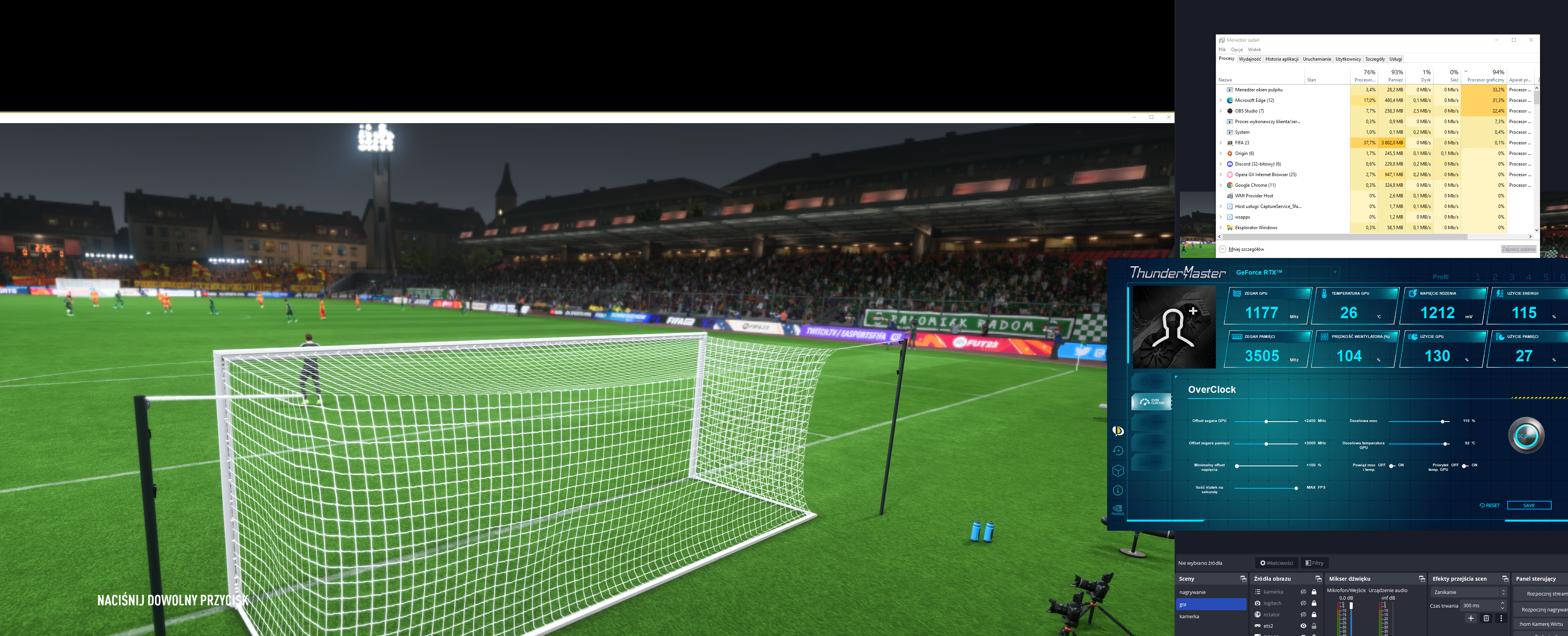

    Please screenshots of browser, FIFA 23 game itself and FIFA 23 enabled OBS
    High GPU consumption by the desktop window manager High GPU consumption by the desktop window manager High GPU consumption by the desktop window manager

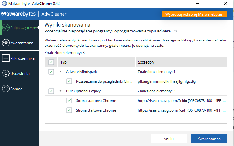

    I am also sending a picture of what Adwcleaner detected
  • #13 20223477
    Kolobos
    IT specialist
    Posts: 85178
    Help: 17171
    Rate: 10455
    Remove what it detects, it has no connection to the manager.

    And I'm surprised by the stuff in the screenshots. Don't you think the values indicated are strange to say the least?
    I'm not sure, but I think something this program from Palit refreshes poorly, yesterday I opened the performance tab in GeForce Experience and while just playing graphics consumption was jumping around 50-75% clocks 1750 temperature 60 a few degrees, when I opened anything else, even a browser then the window manager came into action graphics consumption under 100% and boosting the clock to 1950

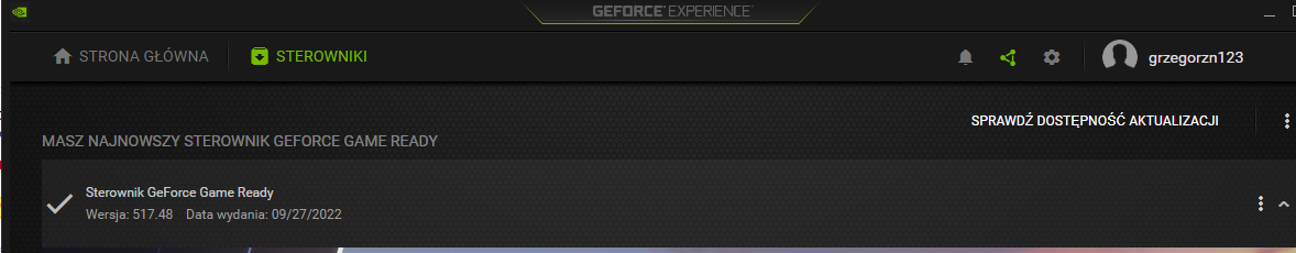

    As far as I'm concerned this is all strange. Are you sure you have the latest available drivers on Nvidia installed?
  • #18 20225182
    grzegorz1805
    Posts: 33
    Rate: 9
    That's what the Nvidia GeForce Experience tells me High GPU consumption by the desktop window manager .

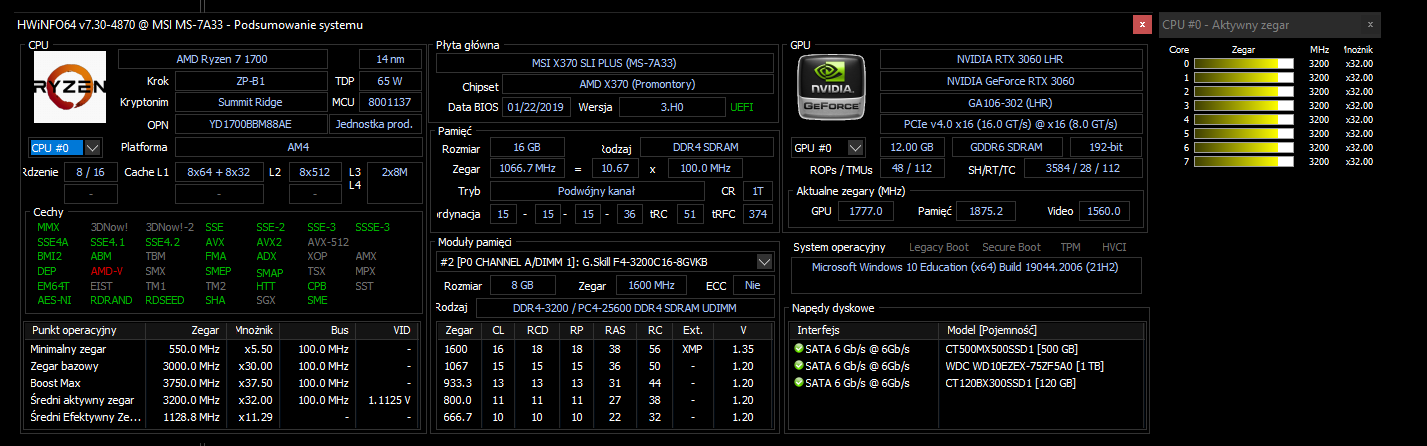

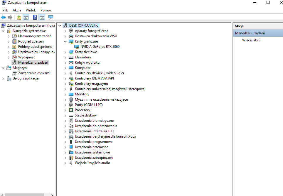

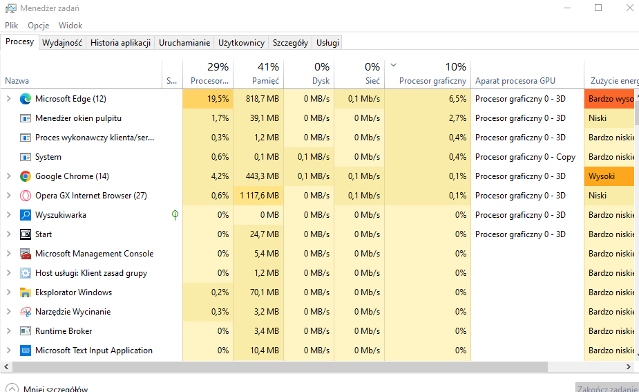

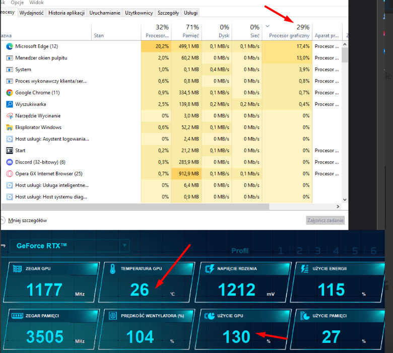

    And which GPU is this process using? Expand the tab in the task manager to see the details. Do you have any integrated graphics there? What do you have in the "Display adapters" tab in device manager?
    Give the full configuration of your computer. Also post a screenshot of the "Sensors" tab from HWinfo.
  • #20 20225643
    grzegorz1805
    Posts: 33
    Rate: 9
    Please, here are the screenshots
    Regarding the extension of the task manager, is this what you meant?

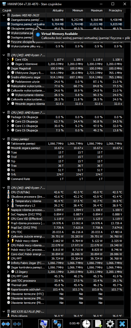

    Still a window of sensors from HWInfo, but we probably won't learn anything interesting
  • #22 20226503
    grzegorz1805
    Posts: 33
    Rate: 9
    Please
