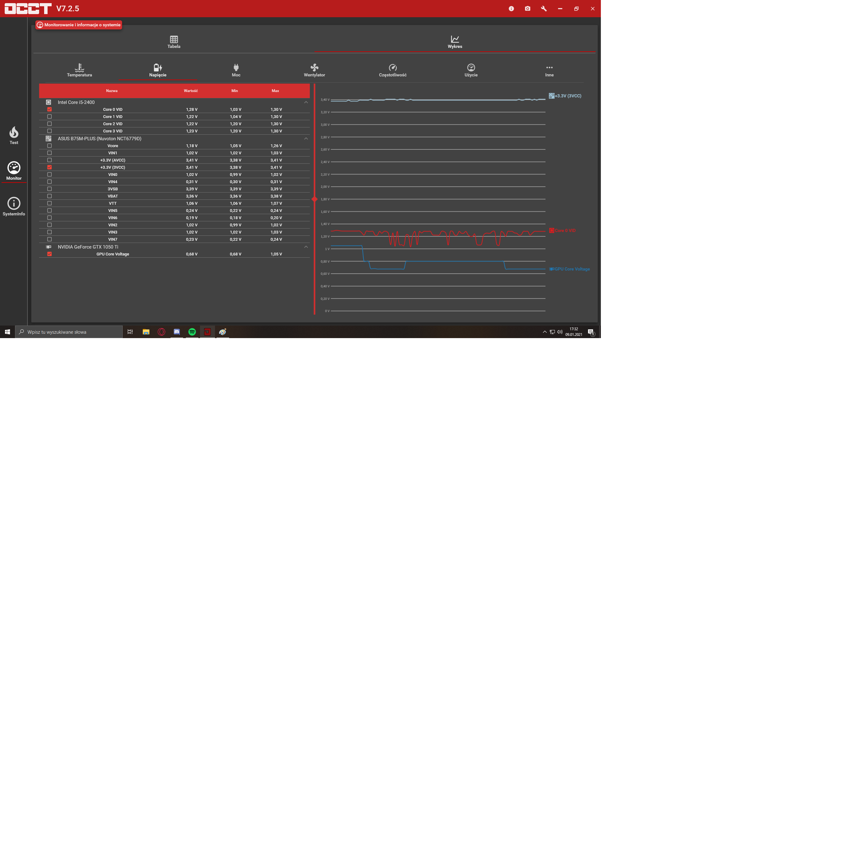

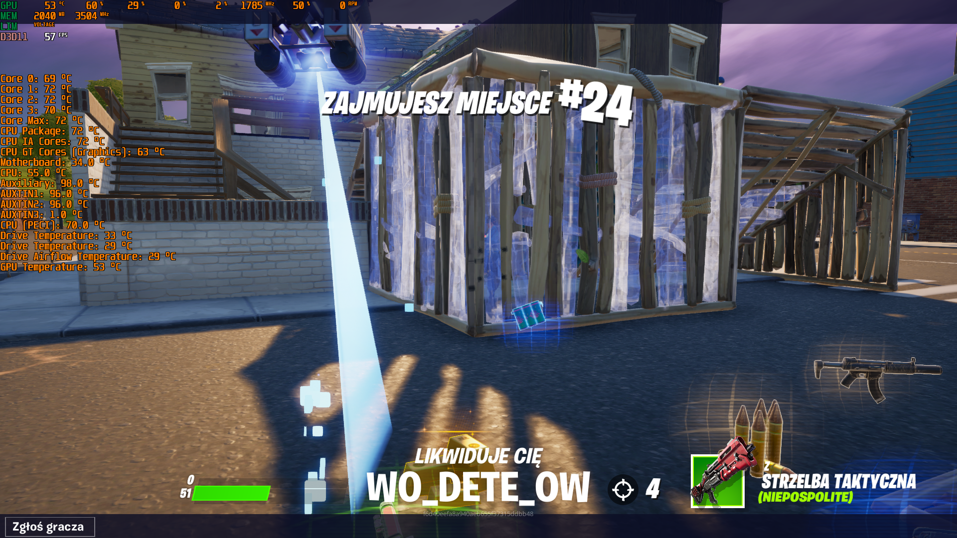

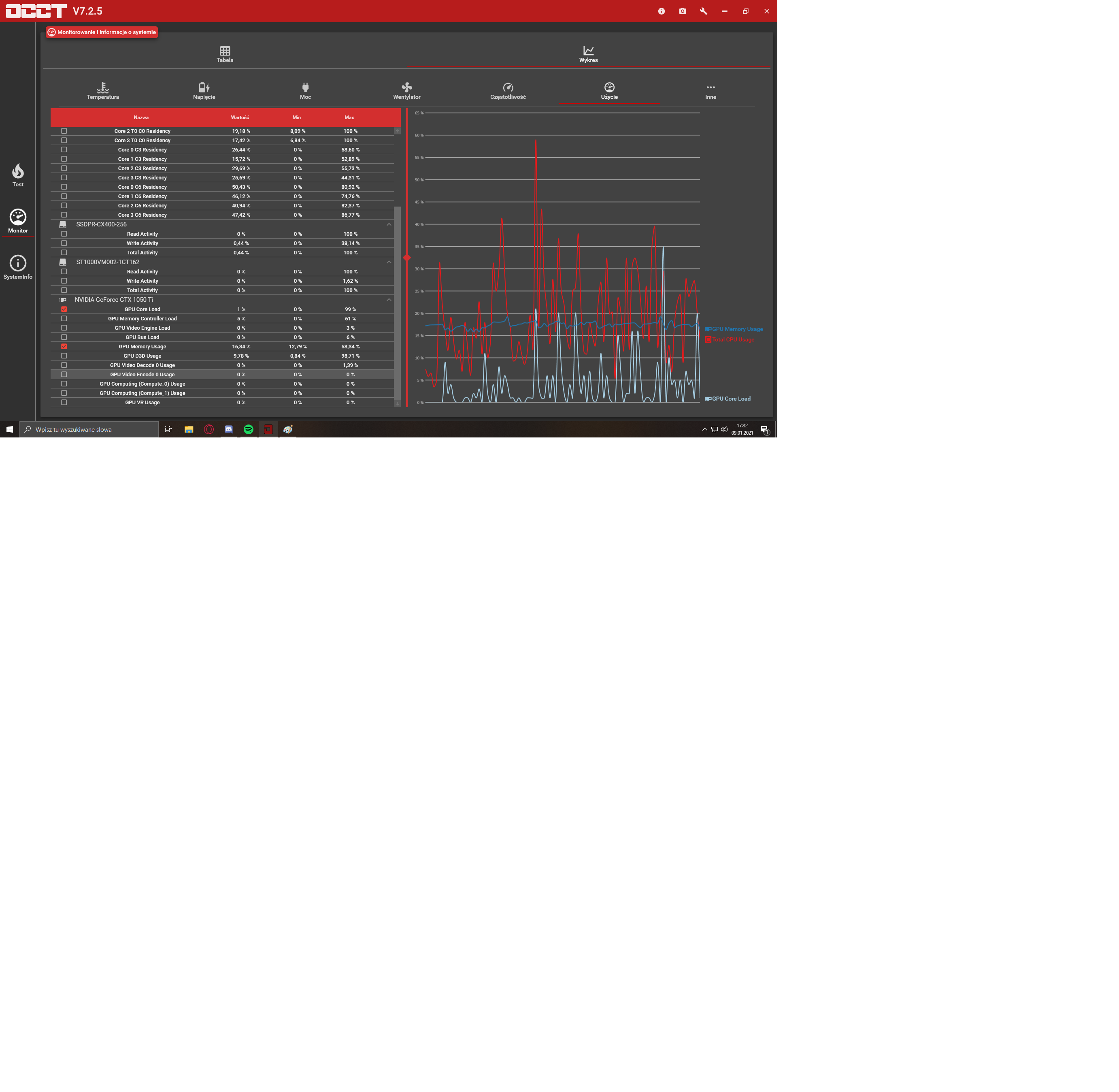

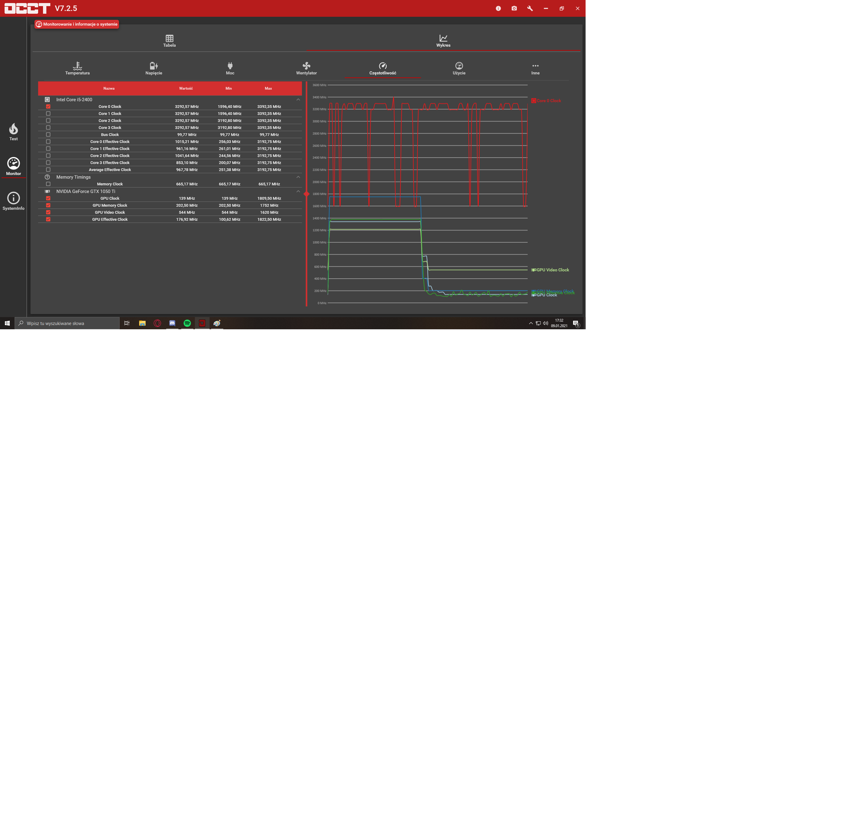

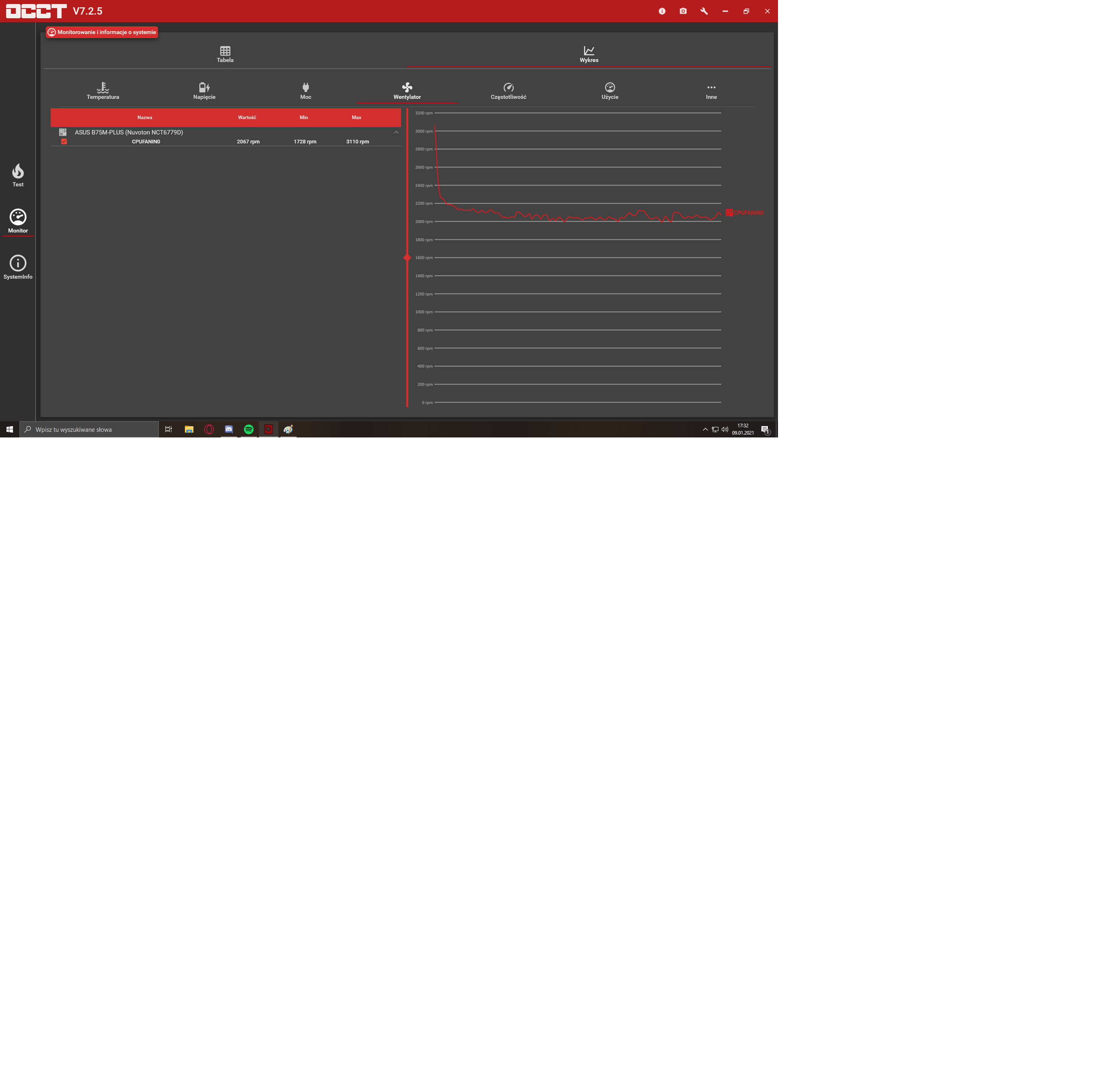

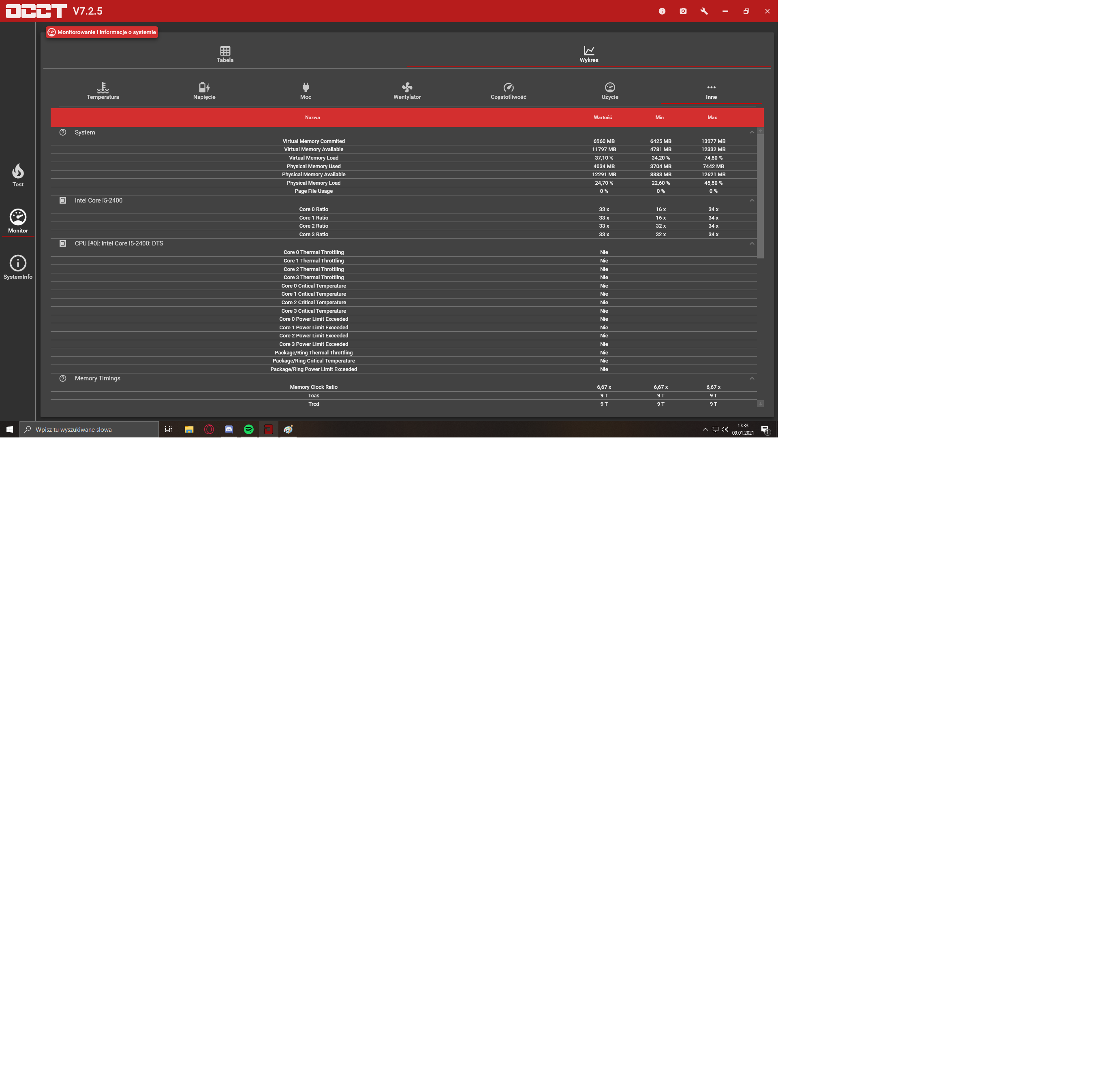

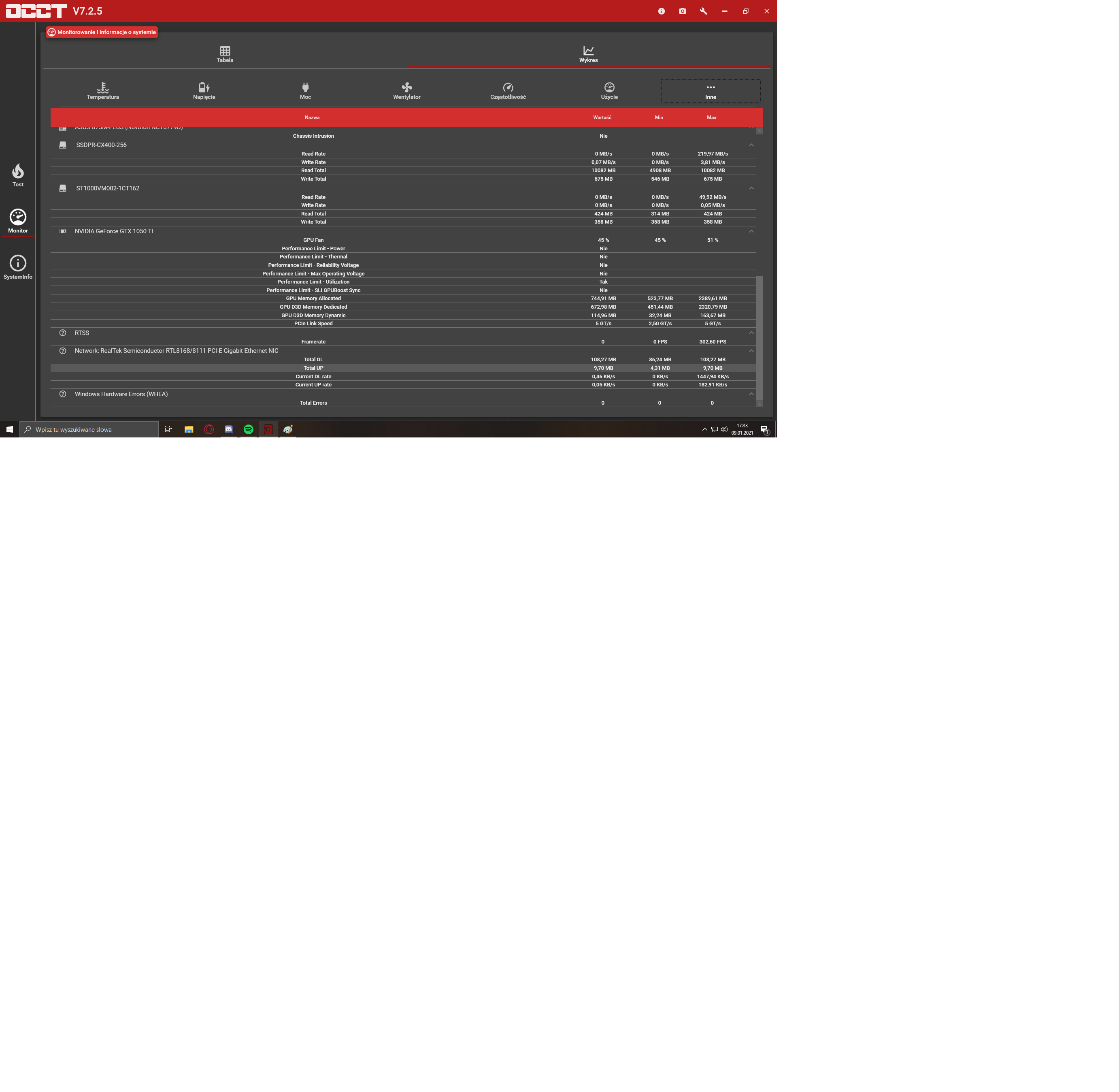

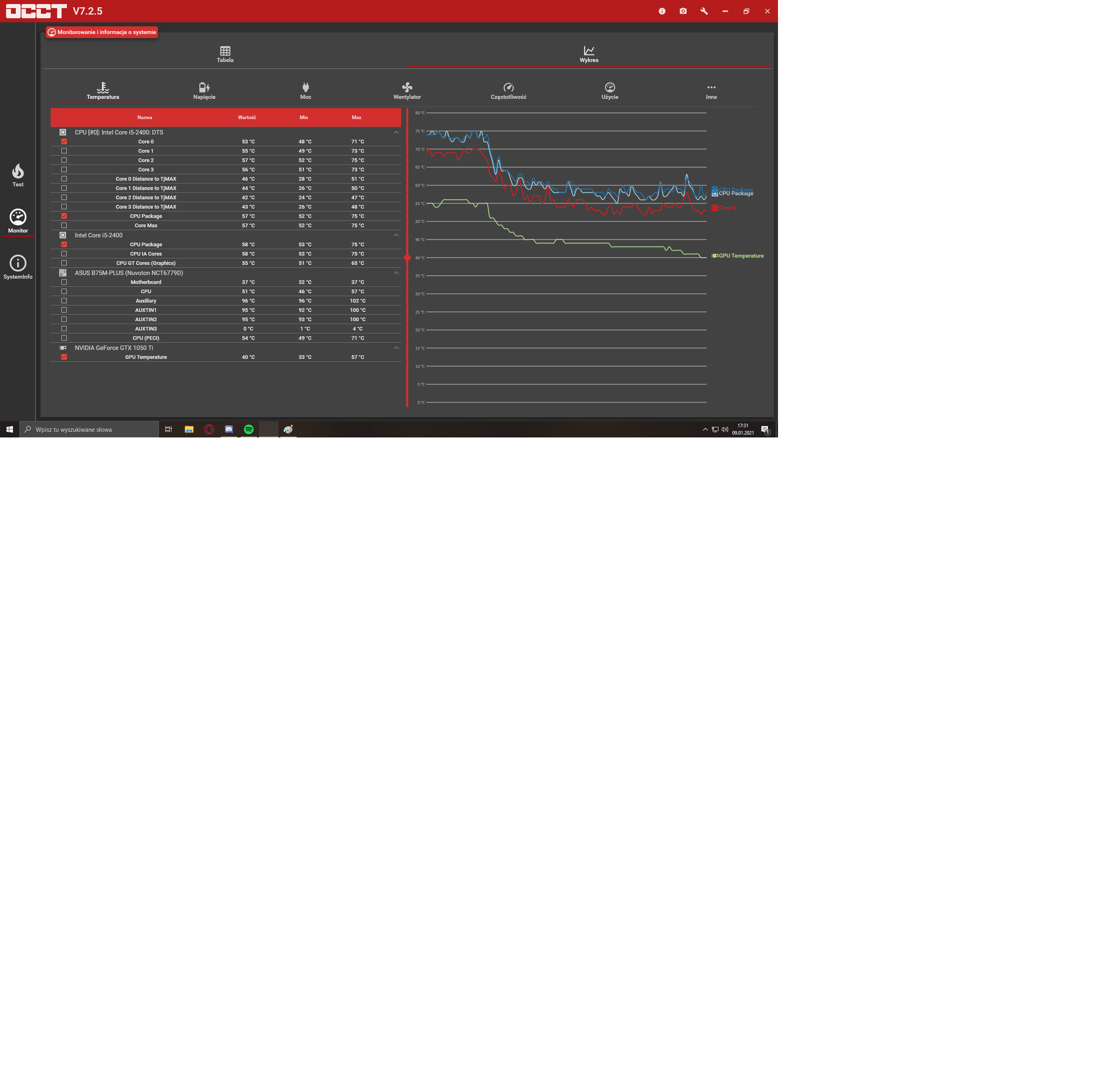

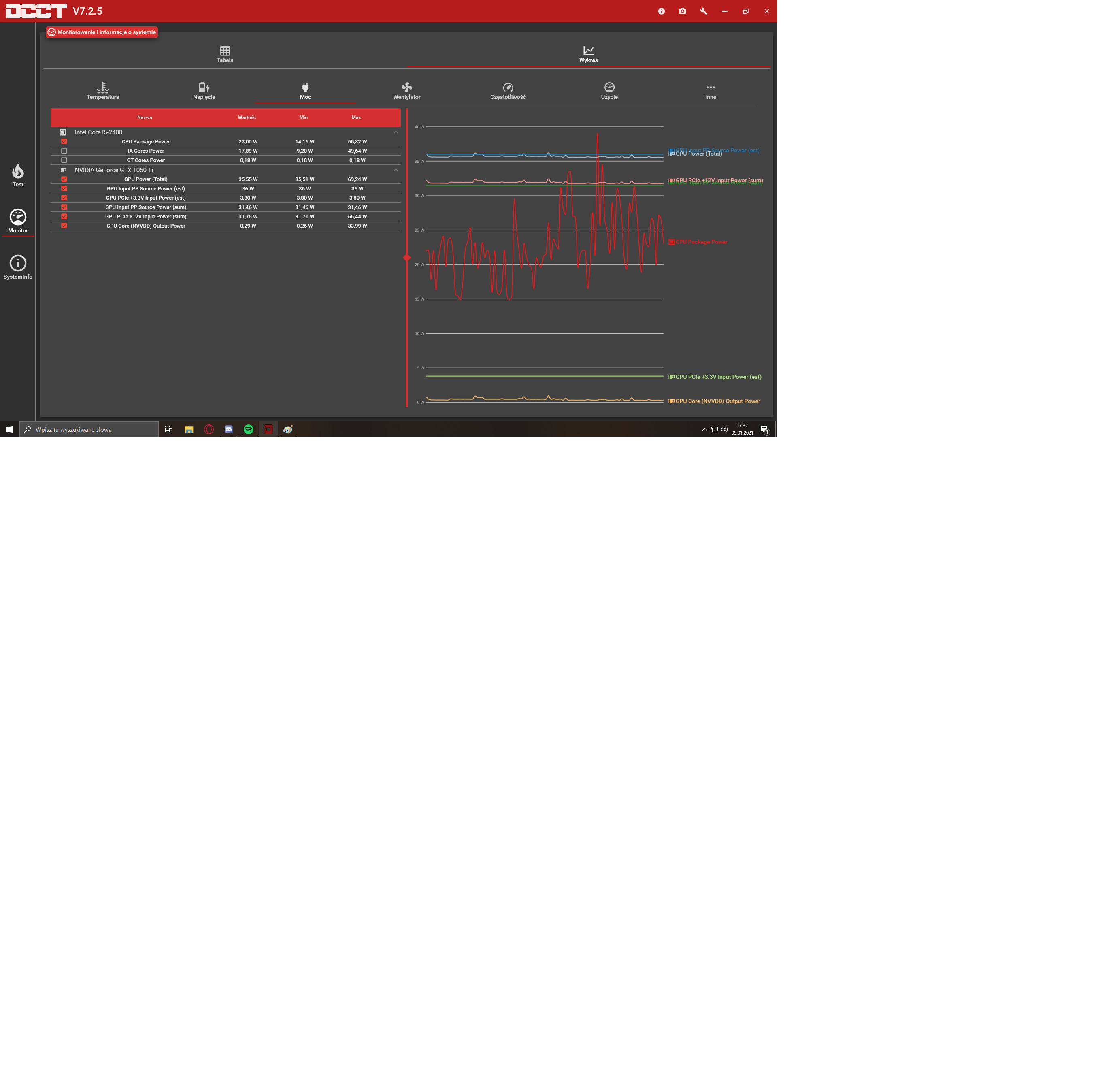

    I have a problem when I play I have 100 fps + but at some points it goes down to 15-20 for a moment and then it comes back again.
    In valorant and fortnite, the textures are lazy to load.
    Current drivers, RAM and disks checked - 100% functional.
    I am worried about the temperature of the motherboard, it hums terribly that it can be heard in the 2nd room.
    Can you fix it somehow?
    SS shows 5min from valorant and 5min from fortnite. It is the same in every game

    You do not have permission to attach to a post?
    And you were supposed to log drops - did you have these fps drops in this log?
    • FatalError2842.CSV (121.75 KB) You must be logged in to download this attachment.

    It was a short game, but so it went down to 15fps
  • Suggesting a BIOS update for CPU temperature issues
    #8 19170639
    enhanced
    Posts: 10442
    Help: 963
    Rate: 883
    Do you have the latest BIOS for your motherboard?
    https://www.asus.com/pl/Motherboards-Componen...therboards/All-series/B75MPLUS/HelpDesk_BIOS/
    Maybe these strange readings at 100C will improve
    In general, the CPU flies at 100% - when the drops are cut, it is not done by the CPU itself, I hope that the system is not cluttered because you did not fire the logo before starting the game, I can not see if something is already using the CPU before the game.
    Besides, maybe these temperatures on the CPU are quite big, but not throttling.
    https://ark.intel.com/content/www/pl/pl/ark/p...5-2400-processor-6m-cache-up-to-3-40-ghz.html
    This is admittedly the maximum temperature of this CPU, so there may also be something here despite the lack of throttling indication.
    But do the latest BIOSA first.

    Bios updated the temperature unchanged, in addition, it feels as if the computer "silted up" even more

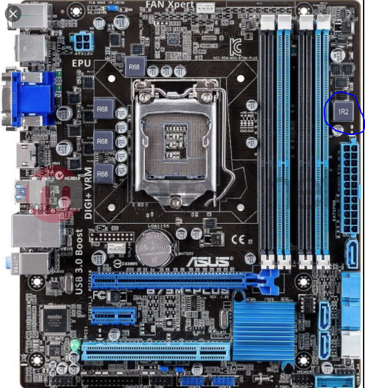

    Still those strange high readings from the onboard gauges?
    turn off the PC and check with your finger how hot the motherboard is, because maybe something is broken.
    CPU cooling is not dusty and the paste somehow changed not too long ago?

    I've done that before, it burns in some places
    And when it comes to the CPU, I changed the paste maybe a month ago, and I clean the PC on a regular basis

    You can show where because, apart from the power supply, something will be wrong with the disc.

    I do not have the possibility to check exactly where all the hot spots are, but here in the picture I have marked one place that I am sure is burning
    megawrzuta.pl/download/5c5714e88800aa0669bdb17b7e062cdd.html

    Sudden drops in FPS in games, what is the reason?
    RAM power supply and this should not be heated - the same parts next to the CPU are yes, but not here.
    And take out two RAM bones and see what changes.

    The album is a bit cooler here, but the indicators in the programs are still going crazy

  • Suggesting HWiNFO logging and timing of FPS drops
    #24 19171966
    enhanced
    Posts: 10442
    Help: 963
    Rate: 883
    I don't know if it's better to invest in a motherboard. You would have to test it live because remotely is a difficult matter.
    If you do logging in, set the hwinfo sensors options to log every 200ms from 2000ms which are too rare and then make the logos again to catch these drops.
    Are the drops right after the start or are they getting worse over time, of course with two RAM dice at the same time.
