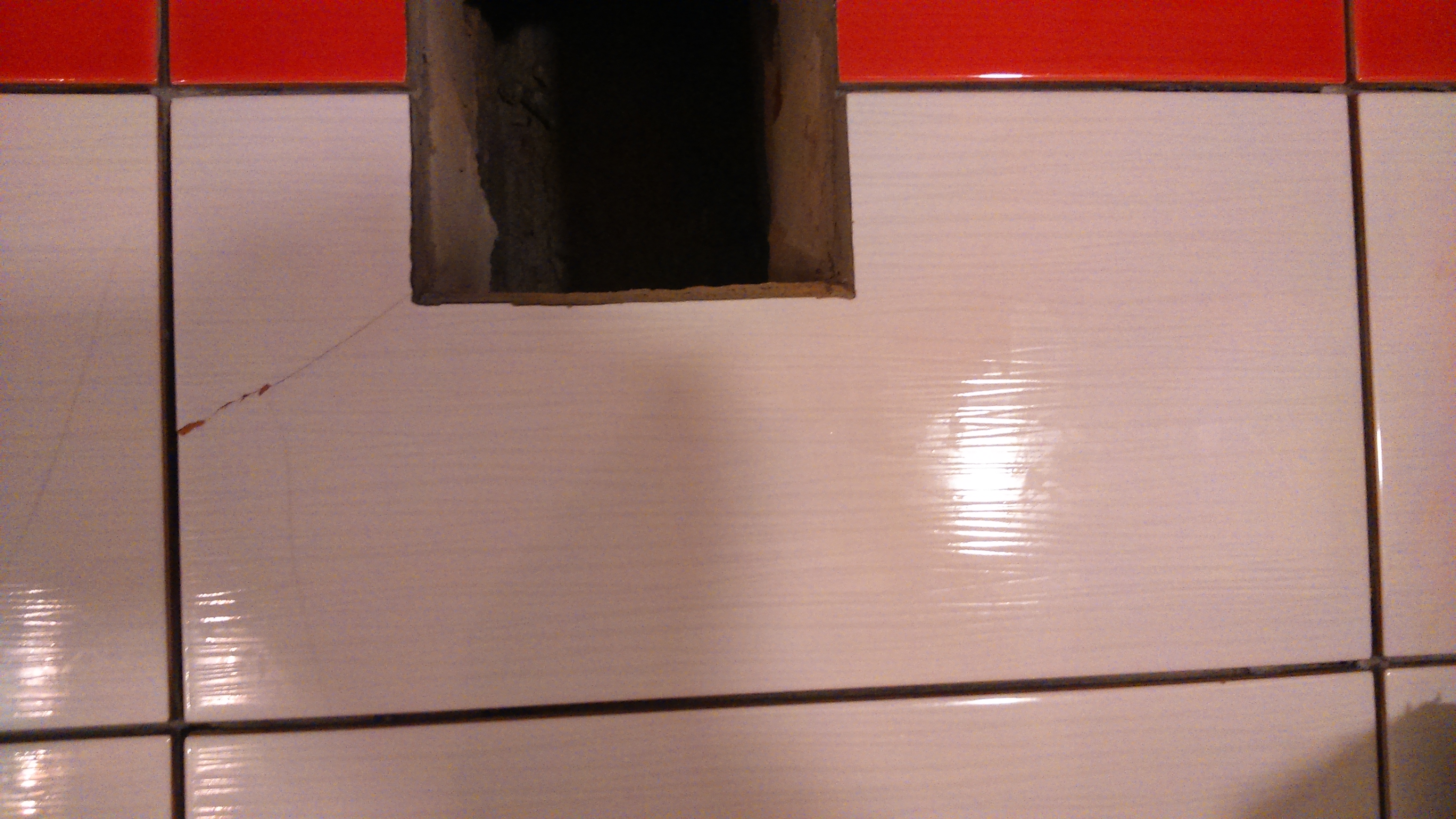

    Level 22  
    Posts: 955
    Help: 55
    Rate: 227
    Welcome.
    I'll add something from myself.
    There may be several reasons for this, the author mentioned that there are cracks where the board is primed, and where there are no cracks in the liquid foil.
    What we know - crap tiles, strong flexible glue, unequal thickness of this glue, unequal surface coating.
    Elastic adhesives are characterized by the fact that they like to shrink during setting and drying (the question is whether the glue was mixed twice? Was it mechanically mixed?), Let's add an unequal coating on the board. A primed gypsum board is much more adhesive with a tile adhesive than it is covered with a liquid foil, the liquid foil itself is relatively easy to remove from the board. Similarly, with glue, it is easier to remove it from the liquid foil than from a primed board.
    My theory:
    - the glue has slightly shrunk during setting,
    - in places where the board was primed, he held it tight enough that he pulled in a weak tile causing cracks,
    - in places where the plate was covered with a liquid foil, it has burned off the foil or together with the plate foil.
    The tiles themselves can also be to blame.
    The phrase "crap tiles" came to my mind after the information about the curvature of the plane of these tiles, I have already encountered such inventions. They are so soft that you can scrape them with a wallpaper knife and bend them in your hand.
    Sometimes I have the impression that under the influence of moisture they become even more flexible.
    As for tile adhesive and construction chemicals, I haven't used ceresite for ten years, maybe because it was absorbing, I don't remember. I use glue, grouts, silicones and liquid foil from Mapei.
    Mapei P9 glue, if I mix it by machine (the mixer rotation does not matter), I can put even 5 cm of glue under the tile and nothing will happen. If I mix it by hand (even if I mix it vigorously), it will pull the plate in with a thickness above about 5 mm.
    Regards

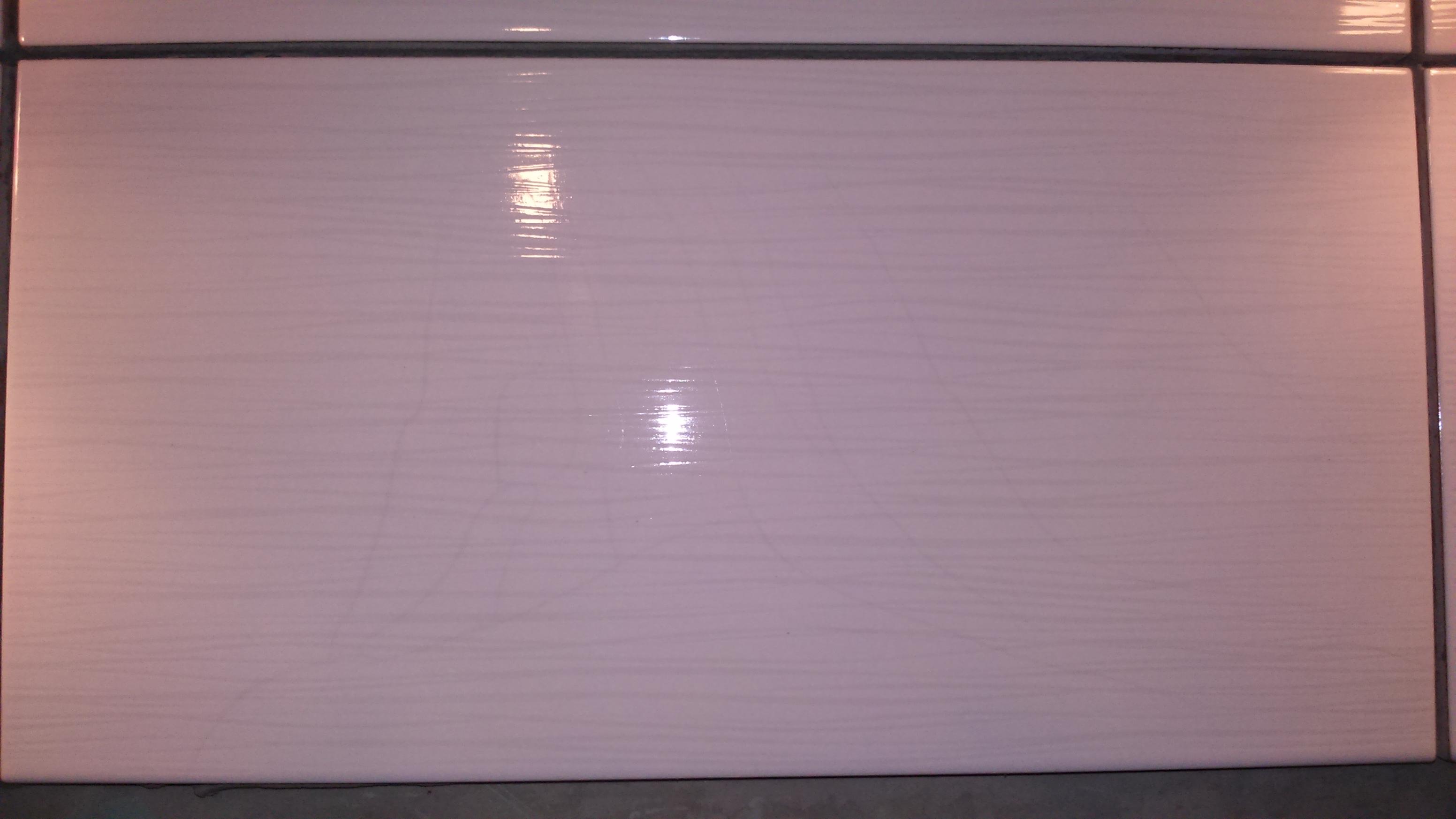

    Hello again, sorry for no reply but unfortunately I didn't have internet access. Green gypsum boards, one layer, additionally glue the boards and stick them to the wall (on a brick) because the walls are uneven. The board joints were only filled with gypsum board adhesive. Only so far I have noticed that the tiles are cracking where the uni primer was applied and after a short time the tiles were laid. I managed to reflect 2 tiles that had cracks and after reflecting them they are whole, but after soaking, you can see cracks.
    And this is something like this:
    Cracked Ceramic Tiles: Causes & Solutions for Opoczno 20x40 Tiles, Grout Delay, & Glue Thickness
    It's hard for me to take a picture of the entire bathroom because it is small and the floor is not yet made.
    Added after 5 [minutes]:
    My brother-in-law and I decided to replace the tiles on the wall where the uni primer was applied, but what next if it is not the fault of uni primer? Everything points to it, or maybe too strong glue.

    I noticed such cracking that it comes from the excess glue, but it is not about a thick layer, but about the fact that after pressing the plate the glue will come out sideways.
    The effect of such planting is such that the flail dries up first around the rim of the plate does not shrink, the middle part under the plate shrinks when drying up, but it cannot pull the entire plate, because the rim is already stiff because it is dry, therefore something like sucking the middle of the plate underneath it is created. impact, it bends inward and the glaze of the tile cracks.
    Accurate alignment of the wall plane and using a comb to apply the glue not only simplifies the work, but also prevents the glaze of the tiles from cracking, because the glue, having gaps from the comb, dries evenly over the entire surface of the tiles.
    You just can't press the glue so that the comb grooves disappear and the glue fuses into one mass under the tile. In the cross-section, even small, evenly spaced voids must remain.
