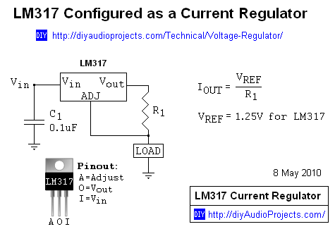

    Hey,
    In a word, I wanted to say, I go to the first class of electronic technical school and for a short time I learn to program the famous Arduino. I am still a beginner, so please take this into account when analyzing my idea and possible answer, so that I can understand what and how ;)
    I am a fanatic of the stage, all kinds of audio equipment and lighting. A few days ago I set myself a goal to make a moving head - so that I could practice the basics of electronics in practice, but also to improve my assessment of digital circuits and eie measurements at school.
    If you are not in the subject what the moving head is, then I am hurrying with the explanation that it is a reflector, whose "base" is rotating and the 2 arms that hold it allow you to move up and down. All together allows the light pole to move in almost all directions. In television programs such as "Jaka tym melodia" or in cabarets, you can often find them placed on the floor in the background, or at concerts as light poles moving.
    Will be controlled from a physical driver, which will also be made by me and will also be made on the basis of arduino (radio control will be up to about 1 kilometer).
    The mere movement of the "head" is not a problem for me, just the transfer of data. The biggest problem for me so far is to design a simple system, up to 90 watt RGB LED, which will change the voltage value depending on the level of PWM signal filling.
    On the internet, I can not find anything that helps me find it. I found only something like this:
    90W LED Moving Head Control: PWM & Arduino for Beginners, Stage Lighting & Audio Equipment
    I wonder if something like this will work. From my (beginner) point of view there is nothing to do, because the PWM signal is nothing but a change in the presence of voltage or its absence, i.e. the diode would simply flash quickly. The more that I do not know how the transistor itself would behave considering its propagation time. From the first lessons of arduino, I learned that by controlling a single diode, a capacitor must be connected, which will be the voltage "averaged"
    I see the scheme of this, so that three signals come out of arduino, which separately control each color of the RGB diode (3 * 30W), then go to the gates of the transistors, which control the voltage on the emitter.
    The auction number on the Allegro with the diode I plan to use (I can not add a link): 6679861262
    I know that these are very basic questions, but:
    1. At what value given on the gate the transistor will fully control the given voltage.
    2. Where it is best to insert a fuse / and other safety devices.
    I am asking for help and the best explanation for that. I know that these are the basics, but at school it is really hard to understand something exclusively from theory.

    A colleague makes one basic mistake. The PWM control itself is realizable and it works - fast rectangular pulses with variable filling give a change in power (and the person sees a flashing to just 24Hz, so when you give PWM 1kHz - you will not notice the LEDs flashing).
    What does the colleague not consider? The given diode requires constant current supply, not voltage. You need a power supply for it, which will have a task to maintain a constant current of 1A for each color - and you want between him and the LED to plug in the transistor PWM keying.
    Imagine that a DC power supply wants to keep 1A of the output current at any price when the diode is disconnected - it can not do it because it has a limited maximum voltage. If he had the possibility of giving 13.000V output, he would force the electric arc with such a high voltage just to keep 1A on the output - but of course it is not. It will be true that the unloaded power supply will give maximum voltage to the output. Theoretically, when you connect the diode to it (eg transistor), the power supply should limit the voltage so that the current flows 1 A. So much in theory - and in practice, the power supply has its own reaction time and thus, immediately after connecting it will not be able to limit current up to 1 A, reducing the voltage very quickly - it may turn out that the diode will blown with the full voltage of the PSU, because suddenly connected to an unloaded PSU will force it to momentarily reduce the voltage - which it is physically unable to do. Even if you do not damage the diode, you will probably pose consternation to the power supply ...

    And it is not better to give a current source on the channel on the LM317 / LM350 instead of a colleague to drive in building converters to discourage him to the end.

    IRLZ44N from the soil side, 100R per goal, 10k to ground and after the case. However, as someone has rightly noticed before, at the price of this LED it is worth to construct real-life drivers.

    For each led you will then apply the PT4115 driver system at 1.5pln per unit.
    http://www.micro-bridge.com/data/CRpowtech/PT4115E.pdf
    You will control it from Arduino to the DIM input.
    If everything works programmatically, you will add another driver if you need it and you will be much richer in knowledge.
