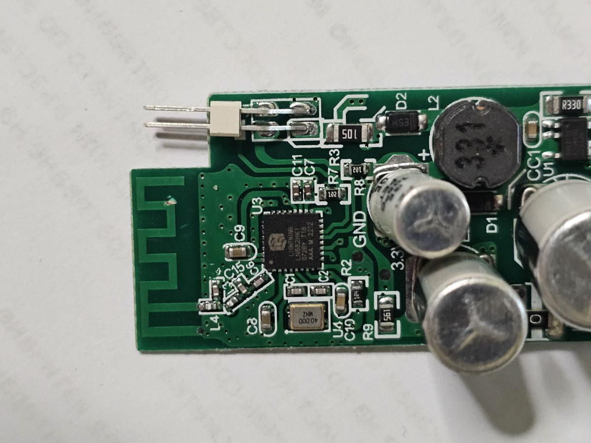

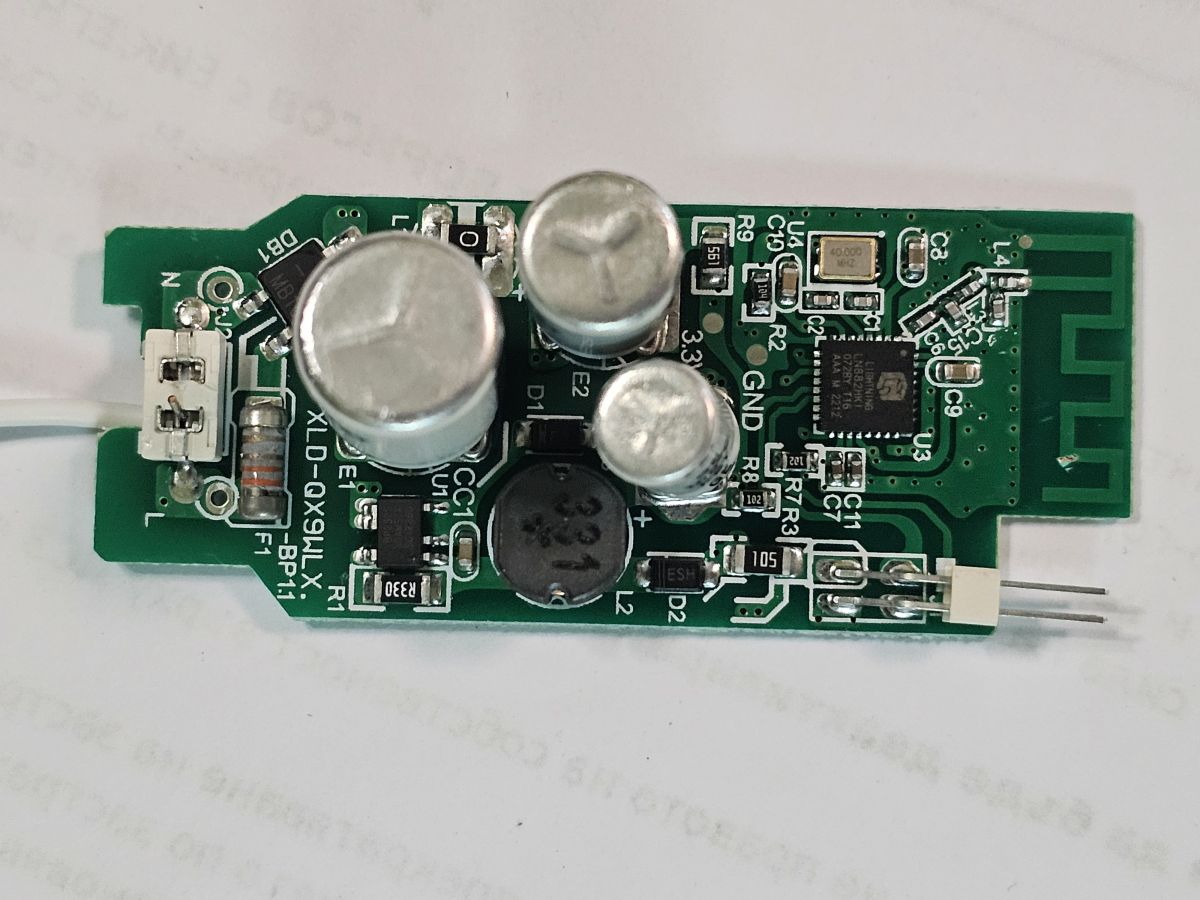

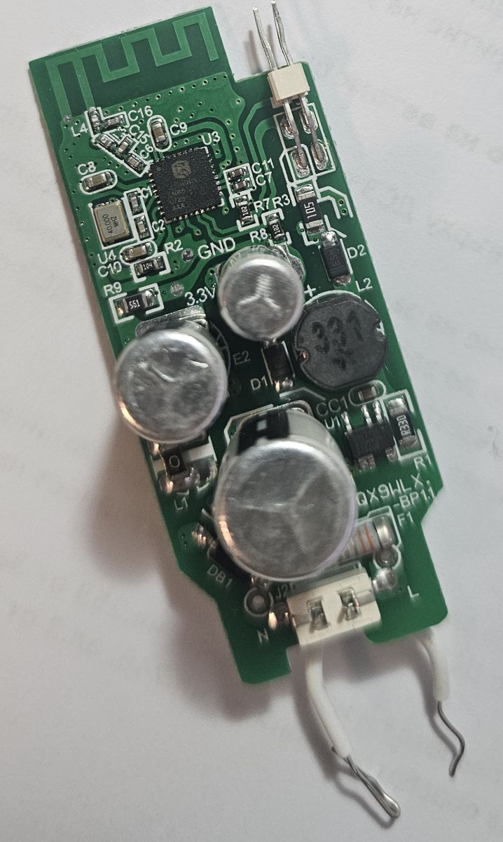

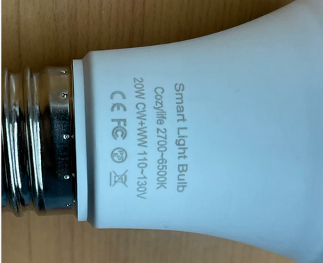

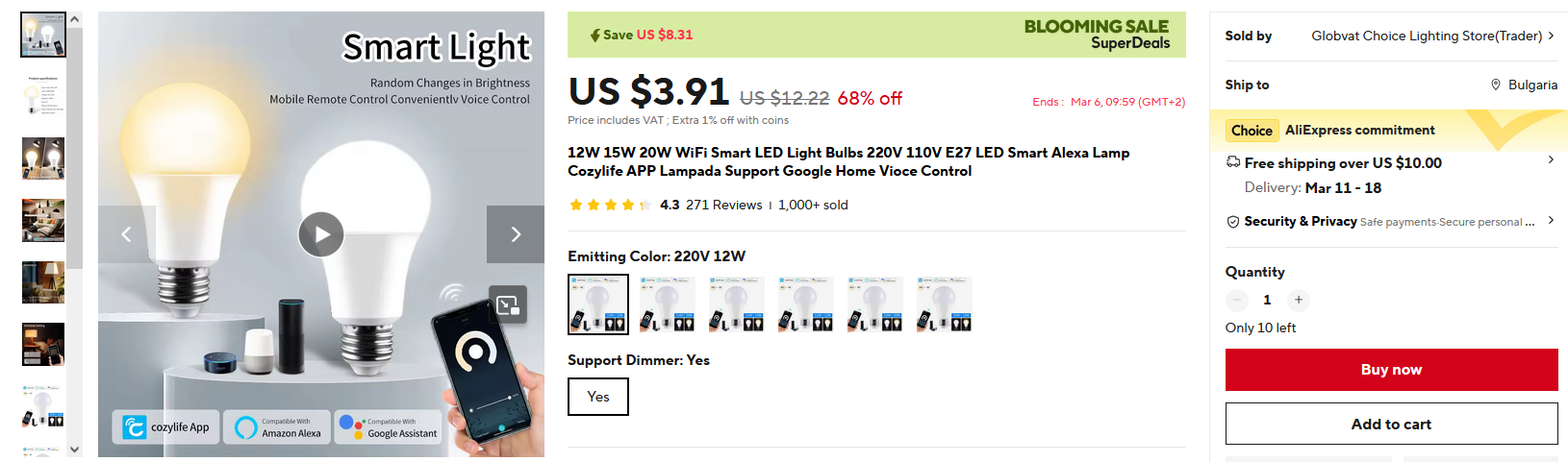

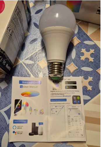

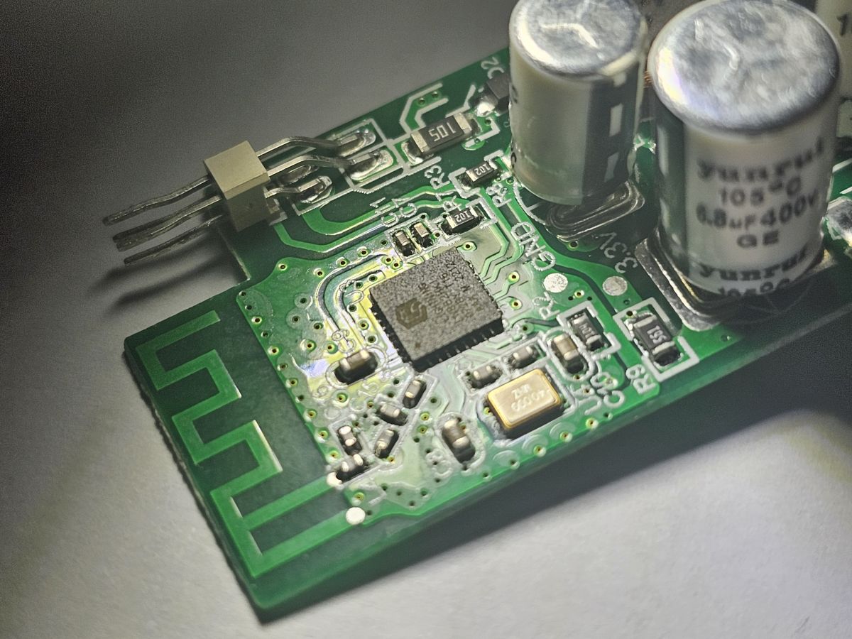

    I have bought some Aliexpress bulbs KA061B3-istb based on LN882H.
    Here is link:
    https://www.aliexpress.com/item/1005007195901....order_list.order_list_main.52.6cd81802ivIuiG
    Here are pictures
    Printed circuit board with green laminate and conductive traces.
    Close-up of a circuit board with various electronic components, such as capacitors, a chip, and conductive traces.
    Close-up of a circuit board with various components, including capacitors and a chip.
    Smart light bulb with visible technical markings on the socket.
    A smart LED bulb is on a table next to a user manual.
    Smart Bulb packaging with colorful graphics.
    Advertisement for a smart LED bulb with voice control and mobile app functionality.

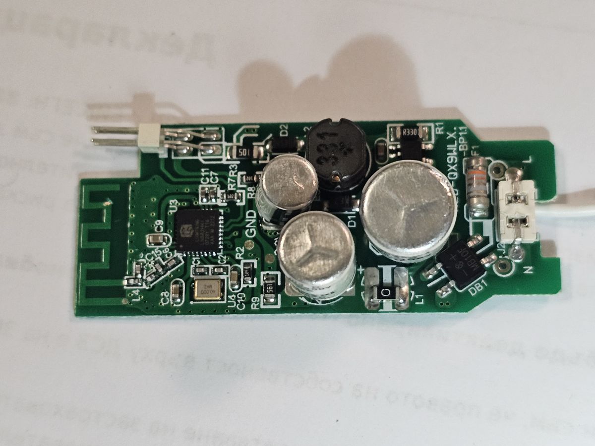

    LED circuit board :

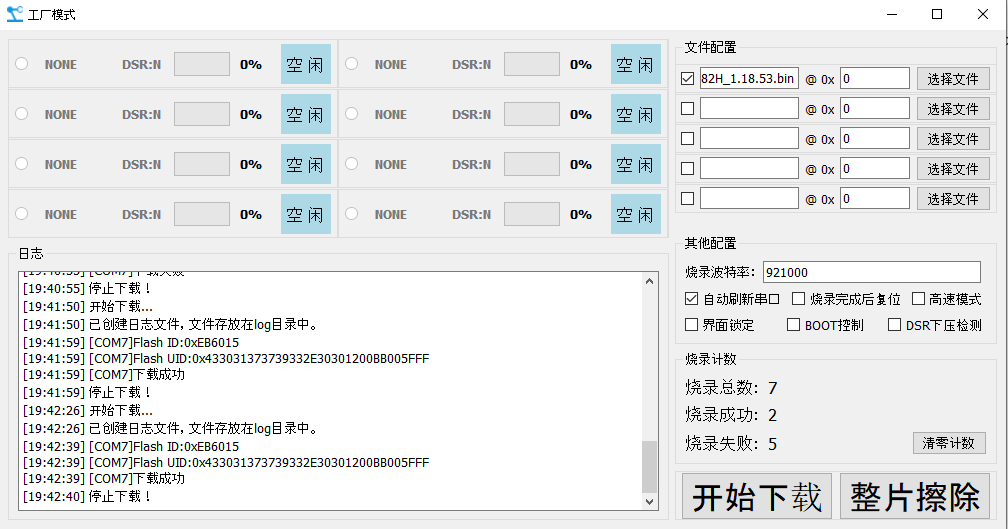

    After many re-solders /unstable 3.3V supply I believe/ I managed to flash them with this tool: https://www.elektroda.com/rtvforum/topic4045532.html
    I did some dumps following this guide, but they were partial and could not successfully flash: https://www.elektroda.com/rtvforum/topic4028087.html

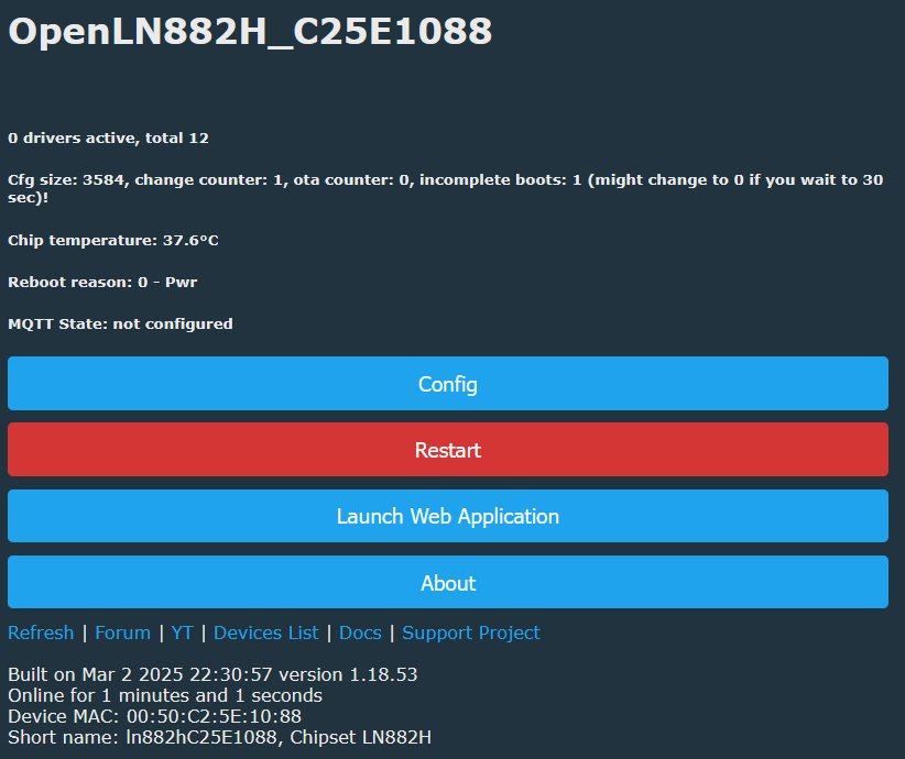

    Now I am here:
    Software interface in Chinese for device memory configuration.
    User interface with device information for OpenLN882H, configuration, restart, and web application launch options.

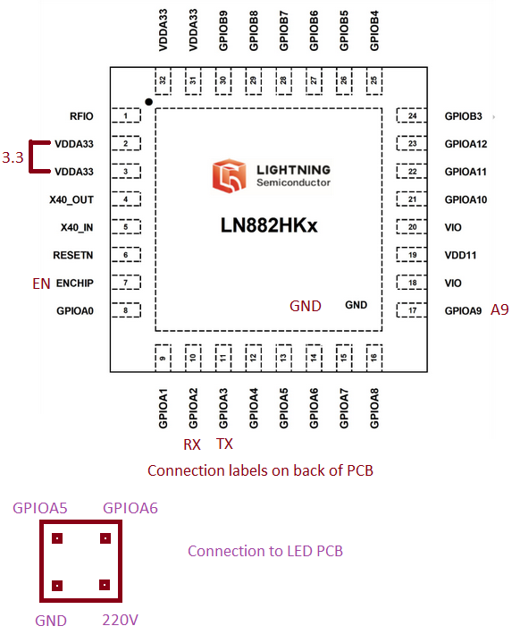

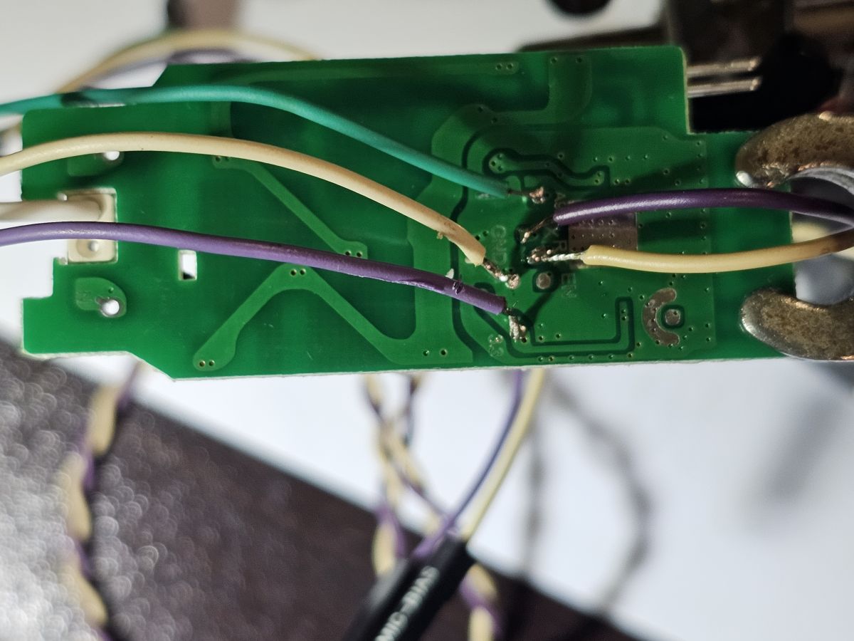

    Here ARE connections:
    Connection schematic of the LN882HKx integrated circuit with pin labels.
    If you need any dumps or tests - I now have stable 3.3V supply and 4 more bulbs.
    My intention for these ones is to use them with another driver not the original I2C BP5758, instead I want both PINS used for I2C to do PWM for Cold and warm white.
    Keeping that in mind if I can keep few lamps as-is with BP5758 - that be great.

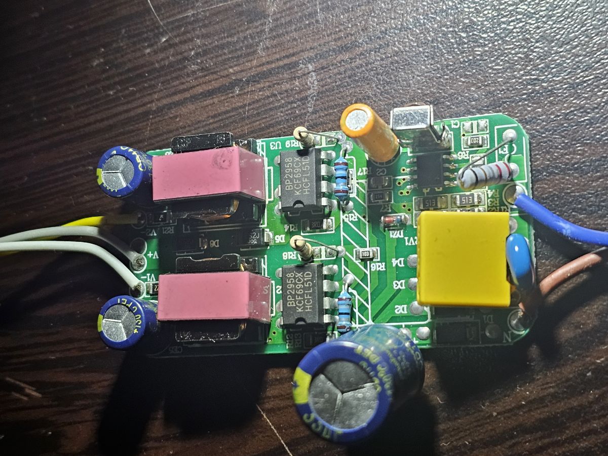

    >>21466419 I have another driver(s) from IR remote lamps using two separate Bright power PWM based drivers (dual BP2958 ) - one for CW and one for WW.
    Example:
    View of a circuit board with electronic components like capacitors and BP2958 drivers on a wooden background.
    I would like to use this board, as it has integrated AC to 3.3v supply , connect common ground, remove the chip from the original board and supply PWM from this one.
    This way i can get rid of the horrible function to change color and brightness on fast switch on/off
    Basically i do not want to use the LED board at all but control another driver designed for PWM
    Making non-smart 50+USD fixture in to a smart one - as i have 2 /got smart replacements already/ but i know people with such /allot/ and i will have 2 fixtures and 5 boards from these smart bulbs to play with.

    >>21466450 Well, you can try it. I did say that pwm is available on all pins.
    You would probably have to add some level shifter, since i doubt that those leds use 3.3v. And something to control how much power those leds receive, because i know bp5758 also controls that.
    3.3V PWM should directly drive BP2958

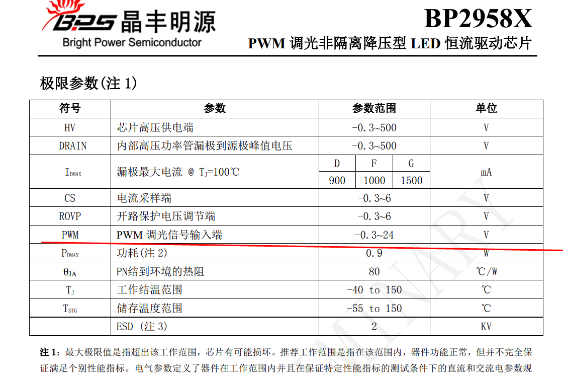

    So you're basically trying to ... use LN882H as Arduino replacement? Well, you can certainly do that, we have both PWM pins with predefined LED driver, and PWM_ScriptOnly role if you don't want to get auto LED controls as well.
    The remaining connection is not really related to OpenLN882H/OpenBeken itself, it's rather a generic question how would you drive your LED with PWMs?

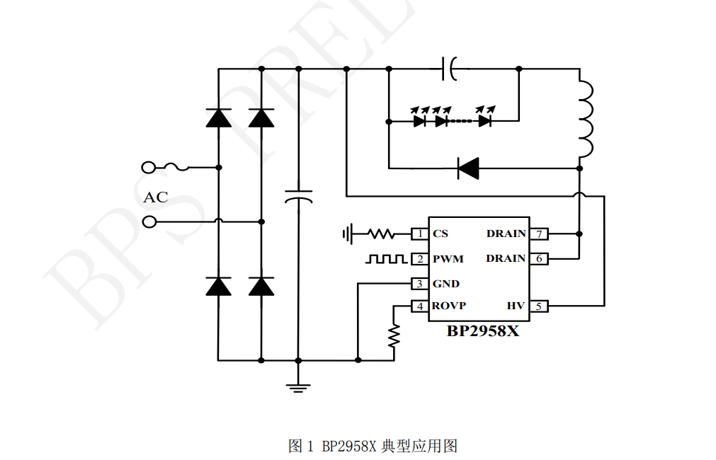

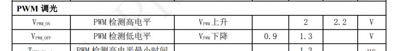

    But to answer your question more directly... I can see that your target board is using BP2958 drivers, right? There is some information on them in the web:
    Block diagram with BP2958X circuit for power and energy conversion.
    But will it work with 3.3V PWM?

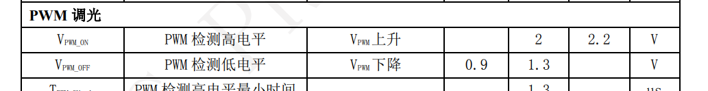

    Technical parameter table for the BP2958X chip with Chinese descriptions.
    Table fragment with PWM data, including voltage values in rows.
    Well, according to the datasheet, the high state on PWM pin is considered when the voltage is above 2V (typical), so I would say, yes, you can control it directly from LN882H.
    Of course, exercise extreme caution when connecting LN882H to your board, do not touch it unless it's disconnected from mains, remember that capacitors can still hold charge even after you disconnect it, and make sure to have common ground when connecting the WiFi module.
    Futhermore, what kind of 3.3V power supply is on your target board? Is it really 3.3V? Too high voltage can easily damage WiFi modules.

    Since you have already traced pins, set them up in config, one as BP5758D_CLK, other as BP5758D_DAT.
    Then experimentally adjust color map in console via BP5758D_Map (usually it is BP5758D_Map 2 1 0 3 4), you can also adjust current via BP5758D_Current (first arg is for RGB, second is for CW, default is 13mA).

    Here is the best I have so far, not sure it is complete, but the best I managed out of 10's of attempts:
    https://nas.mode-x.org/s/oJ6TDpRANiznFix

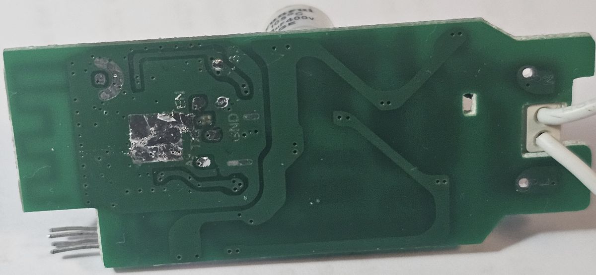

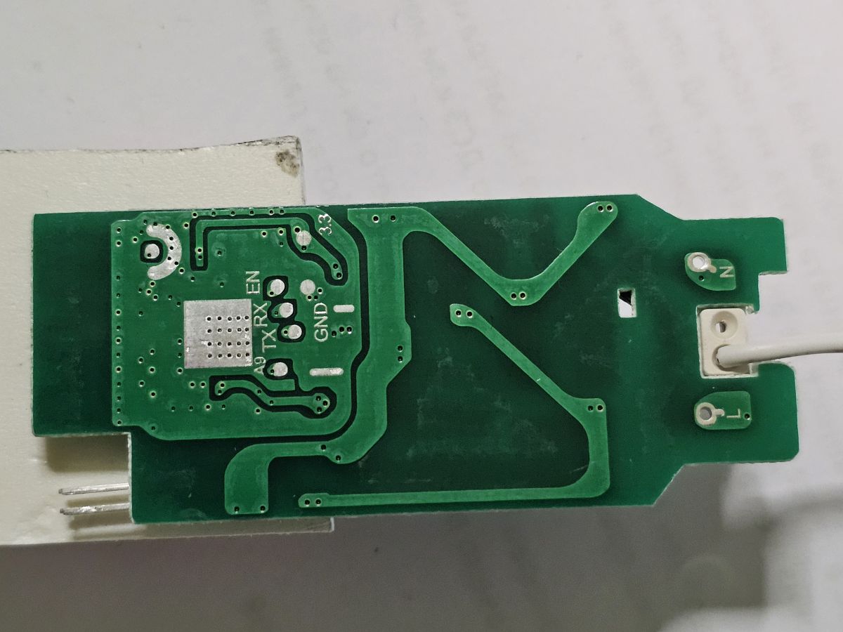

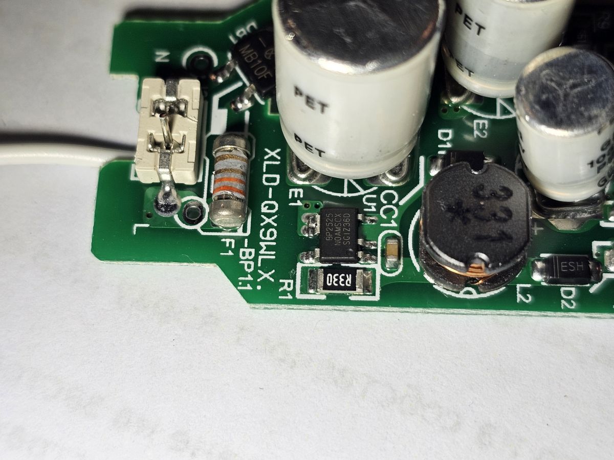

    Here are more board pics:
    Circuit board with various electronic components, including capacitors and a coil.
    Close-up of a green PCB with soldered wires in various colors.
    Close-up of a circuit board with markings such as TX, RX, EN, and GND.
    Close-up of a green printed circuit board with electronic components.
    Close-up of a circuit board with visible capacitors and other electronic components.
    Printed circuit board with various electronic components.
    Added after 17 [minutes]:
    >>21466799 Any guide on how to configure for PWM on pins GPIO5 and GPIO6 or I2C communications on same pins ?
    I mean how to configure the chip itself to know and if possible report what it is - this is what I need.
    - I got it!

    #17 21468812
    apsis
    Posts: 26
    >>21467756 It's not the wires for sure, even tested wires less than 2cm.
    Could still be a power thing, but I doubt that as programming with this https://www.elektroda.com/rtvforum/topic4028087.html never worked.
    Only this tool did the job : https://www.elektroda.com/rtvforum/topic4045532.html
    Thinking of another ways however if a better dump tool is available, one that can tolerate some errors - let me know

Yes. The BP2958 PWM input considers high above ~2.0 V (typical), so 3.3 V MCU PWM works. Keep grounds common between the LN882H board and the LED driver. Verify the target board’s regulator is truly 3.3 V. Use safe handling; disconnect mains and discharge capacitors before touching. This enables CW/WW dimming without the original I2C chip. [Elektroda, p.kaczmarek2, post #21466579]
Do I need a level shifter for BP2958 PWM?
In most cases, no. BP2958’s PWM input reads high at ~2.0 V (typical), so 3.3 V logic is sufficient. If you use a different driver with unclear thresholds, consider a level shifter. Confirm input specs before wiring. Keep PWM wiring short and routed away from AC traces. Stable reference and clean grounds improve dimming linearity. [Elektroda, p.kaczmarek2, post #21466579]
How do I switch from BP5758 I2C to pure PWM on GPIO5/GPIO6?
Map those pins to PWM roles in OpenBeken, then drive CW and WW separately. “PWM is available on all pins,” so choose any convenient GPIO pair. You can use the PWM_ScriptOnly role if you want manual script control. Set frequency and duty limits to match your LED driver. Test with low duty first, then ramp up. [Elektroda, insmod, post #21466517]
