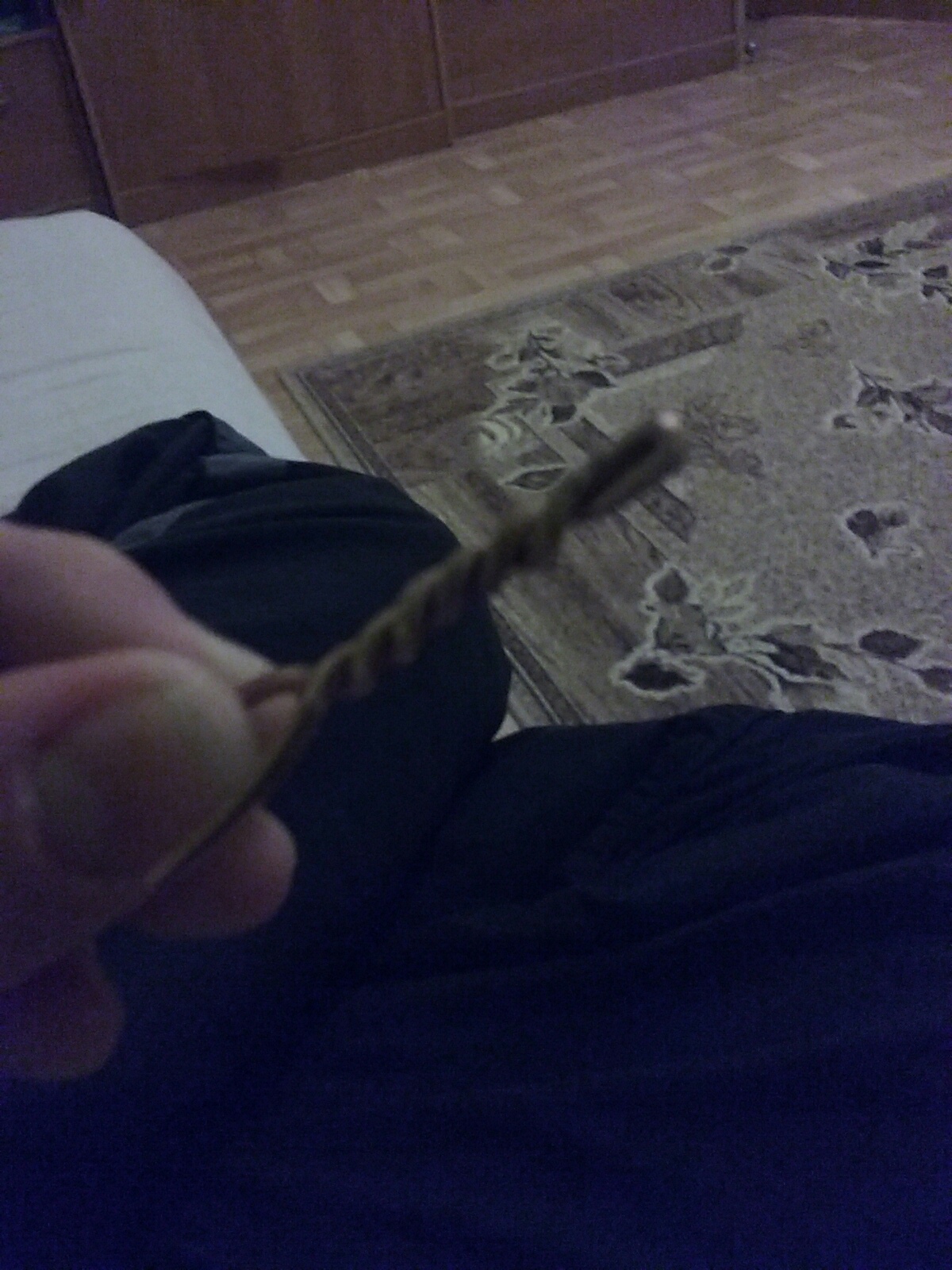

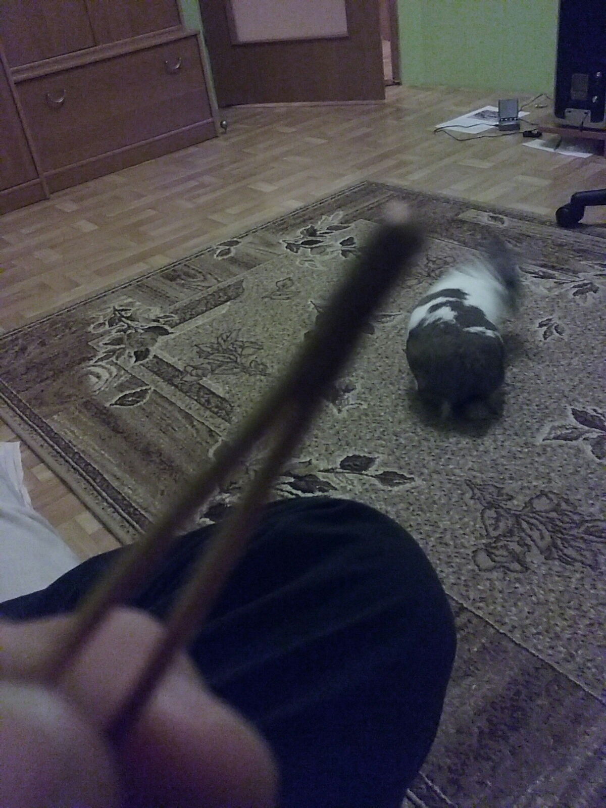

  • #15 16394383
    mateusz2015_5102
    Pupil
    Posts: 542
    Rate: 81
    Twisted spearhead Creating a Durable Tip for a Transformer Soldering Iron: A Comprehensive Guide
    Broken spearhead
    Will both the two spearheads I made last longer than the regular one?
  • #16 16394418
    brofran
    Posts: 6652
    Help: 650
    Rate: 1406
    mateusz2015_5102 wrote:
    Twisted arrowhead
    Slightly too long twisted .
    Marian B wrote:
    The "twist" should be a little less than 10 mm.
    This should be .
  • #17 16394423
    398216 Usunięty
    Posts: 34318
    Help: 3925
    Rate: 9447
    You went a little crazy with this twist.... I don't know if the end of such a long twist will ever get hot enough before it cools down.... :)
