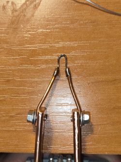

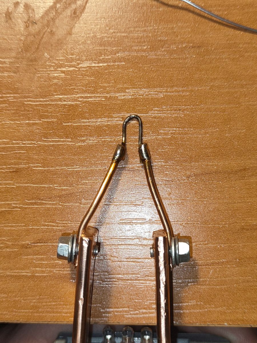

    I used to really like the rechargeable soldering iron from this post: https://www.elektroda.pl/rtvforum/topic3303762.html and recently stated that I would attempt my own build. I already had all the parts recycled, the only thing missing was a flat bar for the secondary winding but this was found. The first prototype was according to the diagram from the link, but it didn't work very well, the zener diode (in my case a B-E transistor) got very hot and there was a lot of power loss. Well, but since I had a tl494 from an old ATX I figured I'd do it again only push-pull this time. It worked much better, the heatsink from the transistors is cold, the power is not missing.
    The operating frequency is 4Khz. The transformer is from an atx power supply and is probably ~1.2cm2 in cross section. The transformer generates its own power for the controller, the push-pull topology doubles the voltage on the primary side so it works great for us if the supply voltage is low. We have about 9-12V on the controller. The whole circuit requires at least 7V to start, below this something works, but the keys do not open fully and it is not able to generate a higher voltage to start. The trip threshold can be lowered by replacing silicon diodes with schottky diodes and/or transistors with a lower opening voltage. In theory the tl494 has undervoltage protection but something this piece of mine works even at <6V just produces some impaired waveform. But once it fires it works and even goes below 6V. There is a hole on the back of the case to adjust the power by changing the PWM fill. The blade is 0.75mm wire. The flat bar is 15x3mm, 12cm long. Because of the size and the material, the loss from conduction is negligibly small, but the loss from heat removal from the mainsail is already quite considerable and it heats up with continuous operation. If I were to make a second one, I would rather aim for an aluminium flat bar, I would make it longer and it would be even lighter and wouldn't pick up heat from the mainsail as much.
    I made the winding from the kind of wire I had, the primary atx I think, a bit too thin but that's hard, it works. I measured twice 15 turns and at the output I have ~0.5V and all in all this is still too much, the mains only has 0.25V. And as you know twice the voltage requires 4 times less resistance to get the same power. So the blade needs to be quite thin, the one I have now is still a bit too thick and I need to have the power twisted. But too thin a blade will be too soft so it's not so easy to adjust. The problem with a heavy load(read thick/short arrowhead) is big voltage spikes on the transistors, up to 70V. For higher power you would need to improve the snubber network , you can add zeners to the transistors.
    The current on the secondary is between 50 and 80A. The power supply is cells from a stripped Bosch hoover battery, they still have 1.8ah and a resistance of 35mR. The final weight is 300g. I still plan to add a power switch and a module to charge the battery when the stuff arrives from china. In the picture with the oscilloscope is the waveform on the flat iron at partial power. In the video he is testing the soldering iron at full power on a small heatsink.
    Circuit diagram of a battery-powered transformer soldering iron. .
    Prototype battery-powered soldering iron on a desk DIY battery-powered soldering iron on a workbench. Oscilloscope screen displaying a waveform with a frequency of about 8.113 kHz. Interior of soldering iron housing with visible two battery cells. View of the interior of a DIY battery-powered soldering iron with electronics and a tip. View of the interior of a DIY battery-powered soldering iron with electronics and a tip. .

    How does the soldering iron perform with the thicker wire as a tip?
    zgierzman wrote:
    I couldn't even manage to watch this short video without turning off the sound - the screeching immediately causes me pain somewhere behind my eyes.
    Do you hear any squeaks?
  • 4 kHz squeal and 3 A steel mainsail load
    #5 21343047
    Sentox
    Posts: 46
    Help: 5
    Rate: 36
    The circuit squeaks in 4 kHz, you can definitely hear it, you would have to glue the transformer or something, but it doesn't bother me so far. To control the temperature of the mainsail, I don't even need a proxy, because the controller has operational amplifiers, but I need to measure the temperature of the mainsail somehow, but with what? Of copper thicker can not be, too high currents on the secondary, too large voltage pins. Too bad I don't have aluminium wires of any kind. But now I have a mainsail from two paper clips, steel, and even that works. About ~3 A it draws on this mainsheet. For the steel wires you would have to reduce the gearing to make it higher voltage.

    Sentox wrote:
    Copper thicker can't be, too much current on secondary, too much voltage pins. Pity I don't have aluminium wires of any kind. But now I have a spearhead made of two paper clips, steel, and even that works. About ~3 A it draws on this mainsheet. For steel wires, you would have to reduce the gearing to make it higher voltage.
    Steel has several times the resistance compared to copper. The advantage is that iron does not dissolve in tin, so the blade will have a long life. With a precision current source of 5-20 A and a suitable millivoltmeter, the resistance of the arrowhead can be measured using the technical method.

    At 4 kHz the penetration is at 1 mm... for 20 kHz 0.46 mm
    Like replacing the flat bar with sheet metal it would work better and wind up easier....
    The secondary current is not 15 times the primary current - this trafo has poor magnetic coupling - there is only one, and poorly wound, coil.

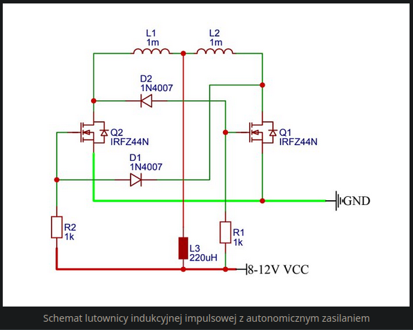

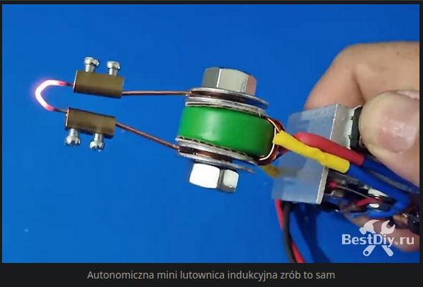

    Eastern DIYers also had ideas for an electronically controlled induction soldering iron.
    This is one such article:
    Autonomous DIY mini induction soldering iron. .
    An induction soldering iron is a pretty good tool in terms of performance, it heats up instantly, which is why it's called an "instant-heat pulse soldering iron", it has a lot of power and can heat up pretty massive components and pads on PCBs, but it does have drawbacks, they are that it needs 220V mains power and it's large in size.
    But you shouldn't fret because you can still make your own compact and simple induction soldering iron, you can power it with a battery and take it with you to places where there's no socket nearby, and it's also quite compact.
    Circuit diagram of an autonomous power supply impulse induction soldering iron. .
    Autonomous mini induction soldering iron with a glowing tip. .

    Here an example using an electronic transformer used to power 12-volt halogen lamps as a soldering iron:
    Simple pulse soldering iron based on an electronic transformer.
    Direct DIY pulse soldering iron.

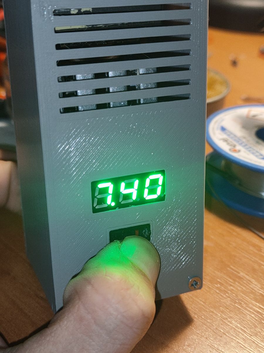

    Do you know any estimate of this power? How much does it draw from the power supply?
  • Measured 1.5–1.8 A draw with voltmeter/ammeter added

    jarek_lnx wrote:
    @Sentox haven't you considered the Mazzielli circuit? the waveform is sinusoidal it's less harmonics both audible and those that the radio will pick up.
    A bit off topic when it comes to such designs, I like this design of mine because you can control the fill. But a self-excited design like this would work well too.
    jarek_lnx wrote:
    Do you know any estimate of this power? How much it draws from the power supply?
    At the time it was probably something around 5A going.
    I made such a tip out of copper wire and a steel paper clip, works pretty well, heats up instantly. You can even solder at 1A. At full power it draws 1.5-1.8A during operation. Surprisingly I soldered with lead tin and it doesn't come off during operation.
    I also added a voltmeter/ammeter. I made a 1A/1V transformer out of the lm358, you use the tie bar to select the voltage.
    DIY soldering iron made from copper wire and a paperclip. Close-up of a device housing with a display showing the value 3.48. .
