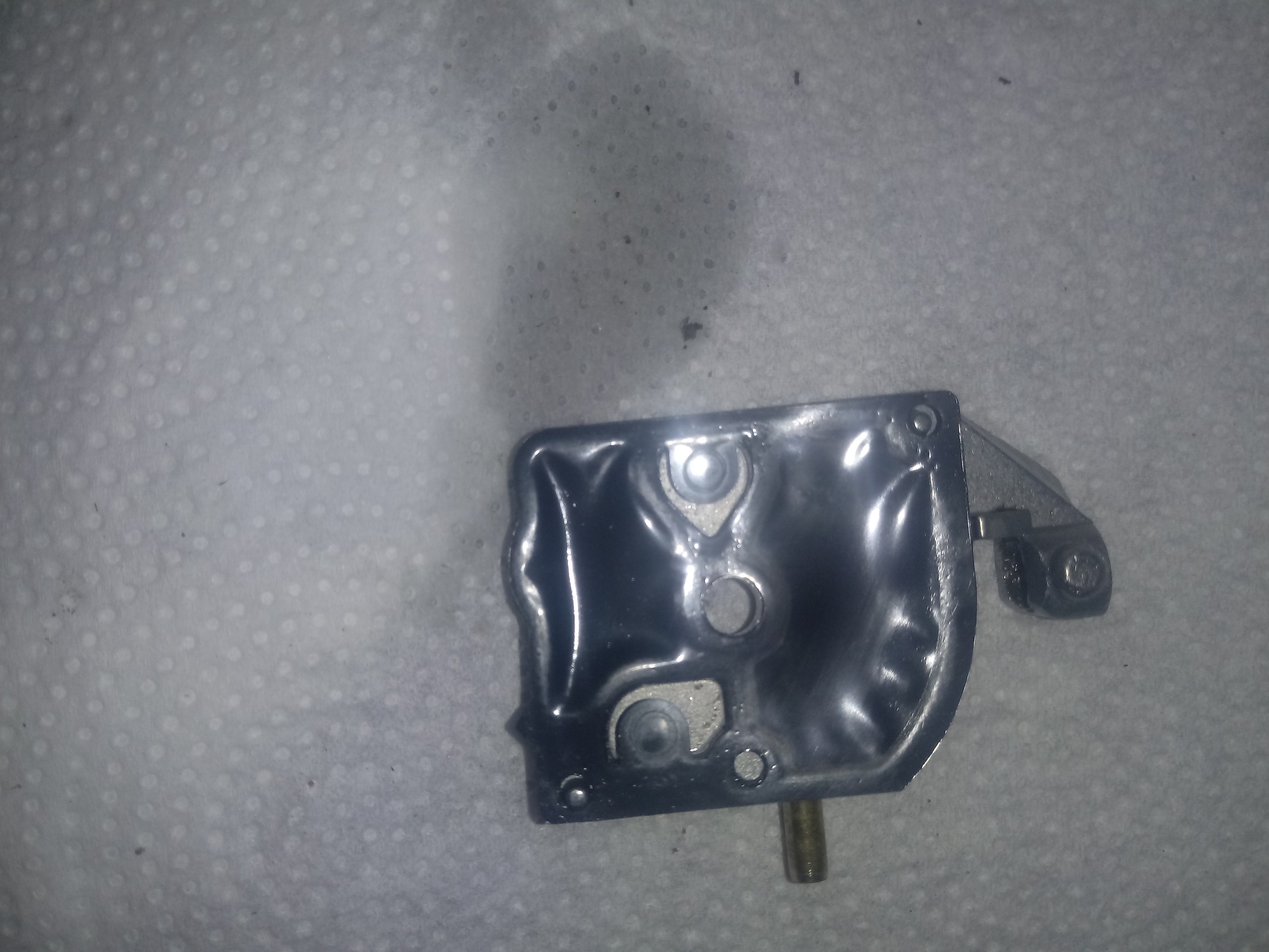

    Hey.
    I became the owner of a used Husqvarna 445 saw. Unfortunately, the saw is ready to stand.
    The saw does not fire properly and does not work. After 20 puffs and a few jerks, it fires for a moment, jumps into high speed and goes out.
    In the button we pump the fuel you can see the air, but it is not leaking. Can you somehow diagnose it?
    How do you go about it first? Unscrew the carburetor for cleaning first?
    Greetings.

    There is no advice, you need to check everything in turn.

    Put some fuel onto the piston, e.g. 1 cm 3, and try to start the engine without suction. If the engine starts, look for a fault, among others carburetor, shaft seals, damaged fuel pump hoses and also check the cylinder pressure. You can also view the condition of the piston, cylinder and rings, after removing the muffler, if you suspect that the engine "chafing".

    I started working with a saw. I quickly found one frayed fuel line, unfortunately after the exchange virtually unchanged. The needle valve and the needle itself have been discolored.
    Pumping membrane quite bulged. What's more, the T adjustment screw is missing. Can it be adjusted / bought?
    I saw a piston under the carburetor connector and it looks good from this side.

    You will find parts by number in the catalog or under the name Husqvarna 445.
    The membrane is in poor condition.
