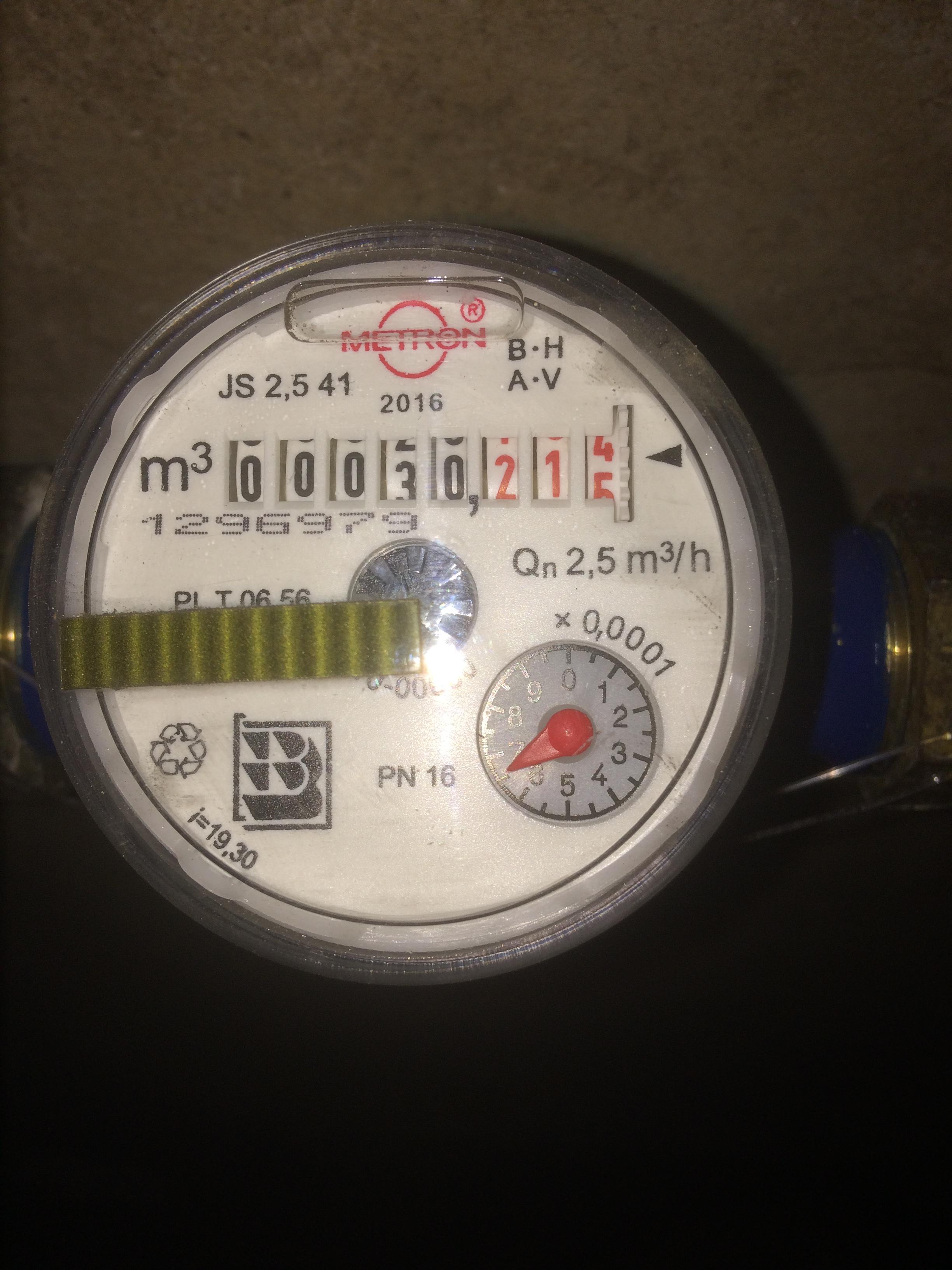

    I have a problem with water meters, and I noticed that sometimes the smallest shield revolves. One way and one way back.
    I was in the administration but found that checking the water meter is 500 PLN if it turns out to be working.
    Should I get a document confirming the legalization of the device during the exchange by the administrator?
    I attach a video:

    A check valve should be mounted on the pipe in front of the water meter.

    There was once a similar topic. There it turned out that there is a hydrophore in the block and the activation of the pumps caused pressure jumps. If it does not "fill" you with a water meter, do not worry.

    Normal phenomenon when fluctuating the pressure in the network. Traces of air in the installation behind the water meter, or even rubber hoses work under the influence of pressure changes, hence the water movements in the installation. There is nothing to worry about.

    It's just that while no one was there for 5h, this movement shot almost 3 liters of water.
    The valve before the water meter is.

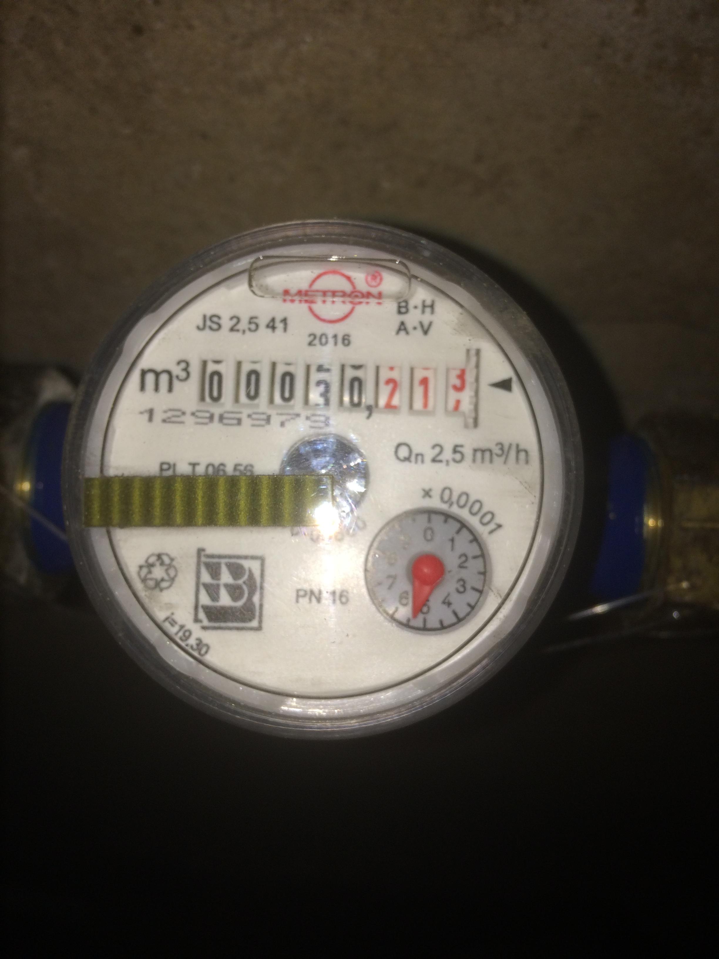

    I made a test with a liter of water. I just got a graduation bottle.
    Before pouring a liter of water
    Water Meter Functionality: Smallest Shield Rotation, Document Legalization & Exchange Costs
    Here, after pouring a liter of water into the bottle.

    It comes from the fact that it distorts 100ml per liter.

    xury wrote:
    It's 1000 liters on the subway.
    Rather 100 liters. The error is 10% and not 100% ;-)
    The test per liter of water is not good. Smaller errors may result in larger measurement errors. Using 10 liters, it may suddenly turn out that the measurement error is 1% and not 10%. But you have to check it out. You could start pouring water at a lower water pressure in the network. After pouring a liter of water into the bottle, the pressure grew slightly. And that caused a measurement error.

    Differences in the indications of old and new water meters may result from a different threshold from which they start to count. The meter for individual settlements, according to the standard (I have read so) should start at 20 liters / hour. For me, for example, the old meter moved at a flow of 10 liters, and the new one at a flow of 17-18 liters. The ingenious tenants use it for saving differently and hence large water shortages result later.
    Counters with a lower threshold will also be more sensitive to rapid fluctuations in water pressure (forward and reverse movements shown in the film).
