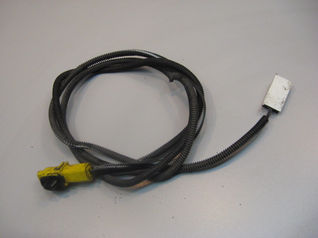

    I warmly welcome :) The problem as in the topic, the car signals the error of the lack of the fuel filler cap, probably a damaged contractor (the diagnostics showed a sensor error). The easiest way would be to replace the harness, but the price of these two cables is shocking PLN 510 (only the original code 1503CZ is needed for the car). the Peugeot 207 harness with the same engine from a similar year (1.6hdi fap 109ps 2008) will fit and the second question .. if not, because the length of the cables or a different ankle, can I replace (re-sell) the contractton itself? .. maybe someone knows where to buy a stimulant ??? Any advice included, thank you :) [/ b [b]

    I was looking around, but it's hard for the 308, so I would buy it from another model, e.g. from 307 or 407 hdi, because they are, but I don't know if it will fit. I have the option to buy for a cheap 207, as I wrote above, but I also do not know if it will work or if not, whether I can replace this contractor .. or the same .. :)

    That's what I replaced, or actually my mechanic replaced it :) I bought the whole bunch from 207 on the Allegro for PLN 50 !!! it had the same 1.6hdi fap engine as my 308. Everything fit, and most importantly, it works :) ... I don't know if they are the same for all models, although the contracts themselves have different shapes and colors of the housing, the shape is probably important because it is mounted in the fuel filler (there is magnesium in the plug). Mine was like in the picture, from 307 it looks similar, but from 407 and 807 it is different !!! Surely fits 207 to 308 1.6hdi fap :) )))
