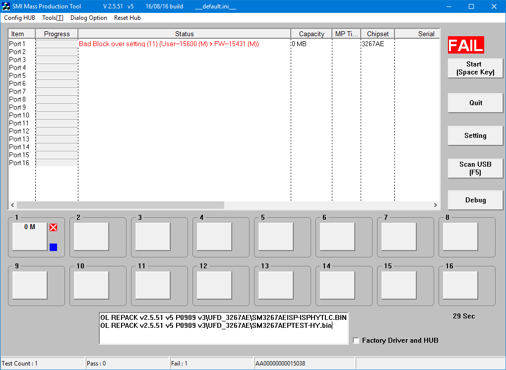

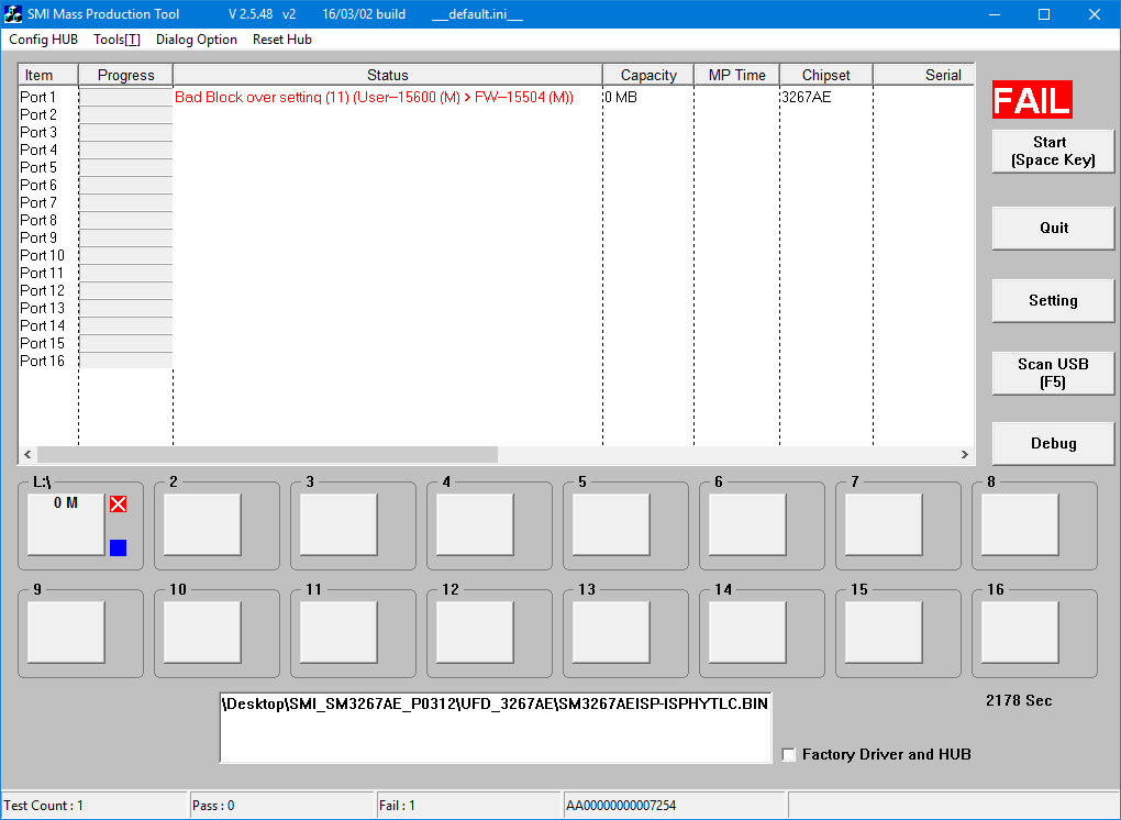

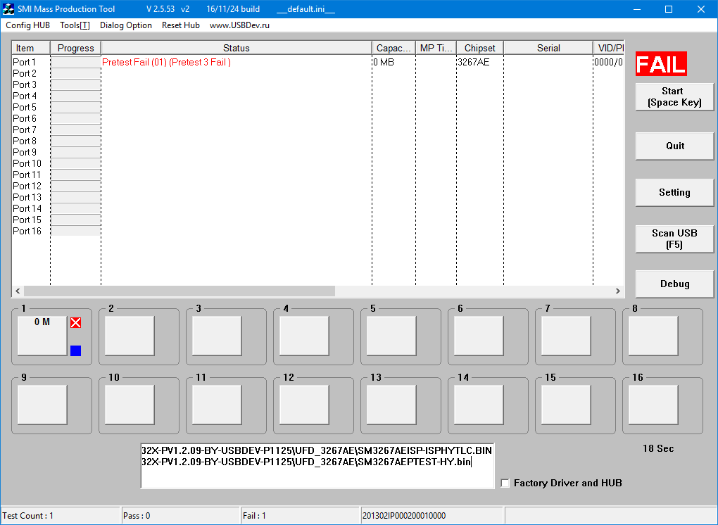

    I tried to use different versions of SMI MPTool.
    Some of them did not detect the device at all, others displayed fail, below screenshots.
    GoodRam CL! CK 16GB USB3.0 Pendrive: Unstable Connection and Low Write Speed Issues

    To be tested SMIMPTOOL REPACK v2.5.51 v5 P0909 v3 :

    Unfortunately it didn't

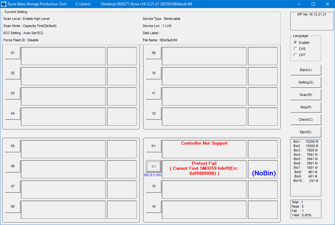

    Locked controller identified with Dyna Mass Storage MPTool

    Let's check it in Dyna Mass Storage MPTool v16.12.21.21 Q0105 :

    Here too fail
    Some hard case :(
