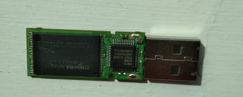

    Good morning,
    The time has come that I decided not only to use the already existing vast resources of knowledge on this worthy Forum, but also to actively ask for help.
    I bought a GoodRam 32GB flash drive less than a year ago and it worked flawlessly until I tried to install macOS on it. After a routine reboot, the bootloader stopped seeing partitions.
    MacOs - like Gparted (lsblk) - does not see the device at all. Windows XP assigns a drive letter, but access and format are not possible (capacity = 0). (Photo of "bare bones" attached)
    Interestingly enough: ChipGenius mainly gives this result:
    Spoiler:
    Description: [G:]USB Mass Storage Device(GENERIC USB Mass Storage)
    Device Type: Mass Storage Device
    Protocol Version: USB 2.00
    Current Speed: High Speed
    Max Current: 100mA
    USB Device ID: VID=0C76 PID=0005
    Device Vendor: GENERIC
    Device Name: USB Mass Storage
    Device Revision: 0100
    Manufacturer: GENERIC
    Product Model: USB Mass Storage
    Product Revision: 1.00
    Controller Vendor: Solid State Systems
    Controller Part-Number: Unknown - 0xBE
    Flash ID code: 983C98B3 - Toshiba - 1CE/Single Channel [TLC] -> Total Capacity = 32GB

    Looking for help, I found, among other things:
    https://www.elektroda.pl/rtvforum/topic1808445.html
    Unfortunately, the link from the key post #7 in my opinion does not work
    MPTOOL_v2159, which google suggested to me as the right one for this memory, throws out:
    Spoiler:
    Disk-G (0xBE)
    Error 255
    Cardinfo:
    ---------------- Device 1------------------
    Get Bad/total block error!
    report:
    Error: This chip(0xBE) is not supported.
    Unfortunately, my ideas and skills are running out.
    Maybe Monsieur @pidar would have any idea? :)
    About two years ago, I managed to save a Kingston 64GB flash drive and, encouraged by that success, I would like to try it with this GoodRam as well.
    I am asking for help, even in the form of information, whether it makes sense to do something about it, or is it just a waste of time.
    Greetings and have a nice time during quarantine :)
