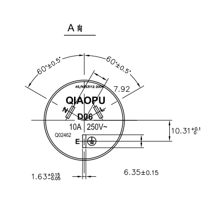

    Can anyone identify the nest as in the picture? I need to buy a suitable plug for it. The socket is installed in the generator and is used to charge the battery.

    And here you cannot agree completely with your friend.
    Australian sockets are made for currents up to 10 A-30 A with tests for direct and alternating current (for example 492/32 - 32V / 15 A plug).
    Europe is not everywhere in the world. The attached photo clearly shows the description of 12V / 10A.
    Anyway, no one claims that it is exactly the same socket, we only indicate the similarity, perhaps the standards of performance according to which to look.
    • Australia-AS-NZS-3112-Plug-Drawing.pdf (31.09 KB) You must be logged in to download this attachment.

    Thanks for the answers. Socket dimensions as in the picture. Identify Nest in Picture: Suitable Plug for 12V Socket with Flat Angled Pins in Generator
    I analyzed in terms of the compliance of the angle between the pins (from the pdf from the "aaanteka" column, thank you) Identify Nest in Picture: Suitable Plug for 12V Socket with Flat Angled Pins in Generator
    and between mine there is no 120 degrees. I did not measure exactly, but after drawing the axis, you can see that the angles are not equal, so it is not 120 degrees.
