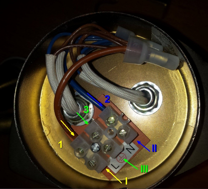

    three cables come out of the ceiling, a two-button wall switch.
    I checked with a test tube, one cable is without voltage, two with voltage (in one the light of the test tube shines brighter in the other, and vice versa, depending on how the wall switch switches).
    How to Wire a 4-Bulb LED Chandelier with a 3-Wire Network and Two-Button Wall Switch?

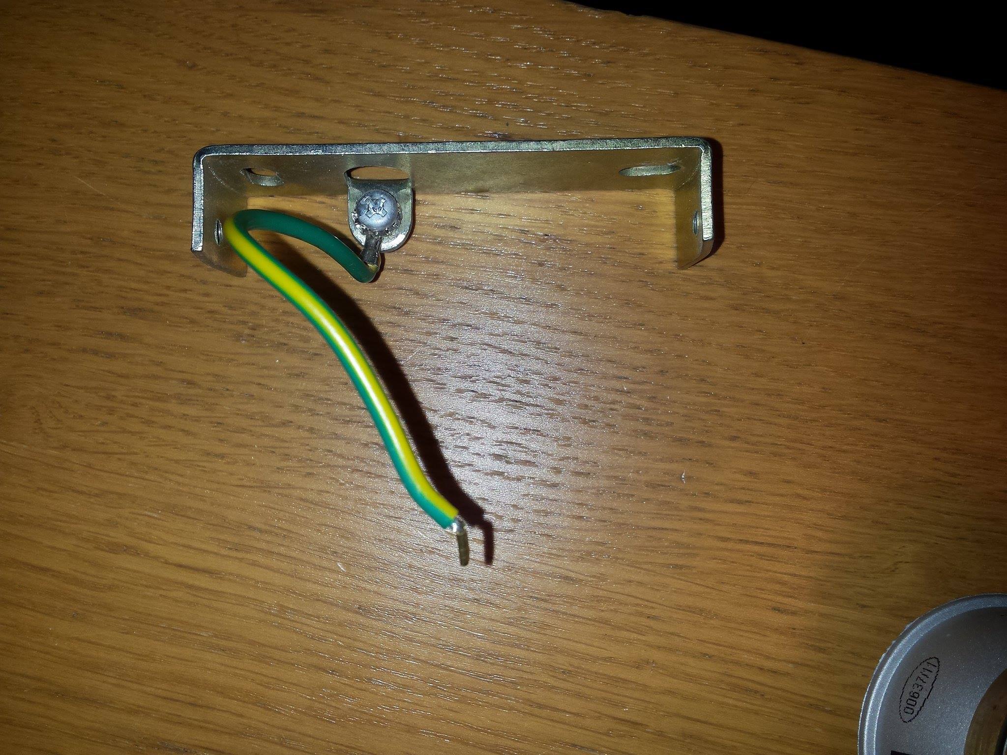

    in addition to the chandelier set, I got a grounding element that is screwed to the chandelier
    The question of how to connect the cables?
    1. power supply from the ceiling under I and II - no matter what configuration and grounding under III or 3? (The 3 in the cube has a metal rod connected to the chandelier housing)
    2. wash the cables 1,2 and connect another cube to the power supply from the ceiling, and the green-yellow one (additional part of the chandelier) to the third one, and III with the one that has no tension from the ceiling?

    No offense, but you have no idea about the basics of electrical engineering. Call a specialist who will connect it within a minute.
    After 1. The chandelier is not factory-adapted to the candlestick (ie two-button) switch. Retrofitting is possible, but requires proper wiring.
    2. Yellow-green, ie the protective one, do not connect anywhere, because only the neutral wire (N) and two phase wires come out of the ceiling.

    Zero (the one without voltage) to N, phase (that is, with voltage) to L. Nothing else. Also secure the second phase wire protruding from the ceiling so that it does not accidentally touch the chandelier's "cup".

    Buddy, this luminaire is made in protection class I, so it requires a protective conductor. So invite a kumaty electrician who will know how to connect it, not only that it shines, but that it is not a threat above all.

    The chandelier can still be reset if the installation is properly made (the switch breaks L).
