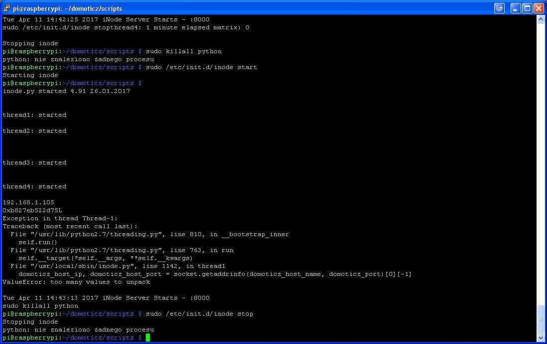

    I have become the 'lucky' owner of a couple of iNode sensors, and an iNodelan. From the browser everything works nicely. Taking it a step further I owned a raspberry pi 3. I booted up raspbian, installed domoticz, and loaded the iNode python scripts. I messed around in the domoticz configuration files. I can't see the sensor in domoticz for any reason. I actually have no idea what is wrong. Running the script manually gives errors as shown in the picture.
    iNode and Raspberry Pi 3 - sensors not visible in Domoticz, Python script errors .
    The pages on the web didn't predict problems so everything there fired up perfectly and works. Please give me a hint as to what could be the cause.
    Raspberry pi 3, raspbian jessie with pixel. System freshly set up nothing combined.

    TvWidget
    Posts: 4406
    Help: 472
    Rate: 697
    The problem may be in the way the local IP address is specified. Sometimes it should be localhost and other times 127.0.0.1
  • #3 16407332
    tprzemko
    Level 22  
    Posts: 413
    Help: 54
    Rate: 21
    You are Great.
