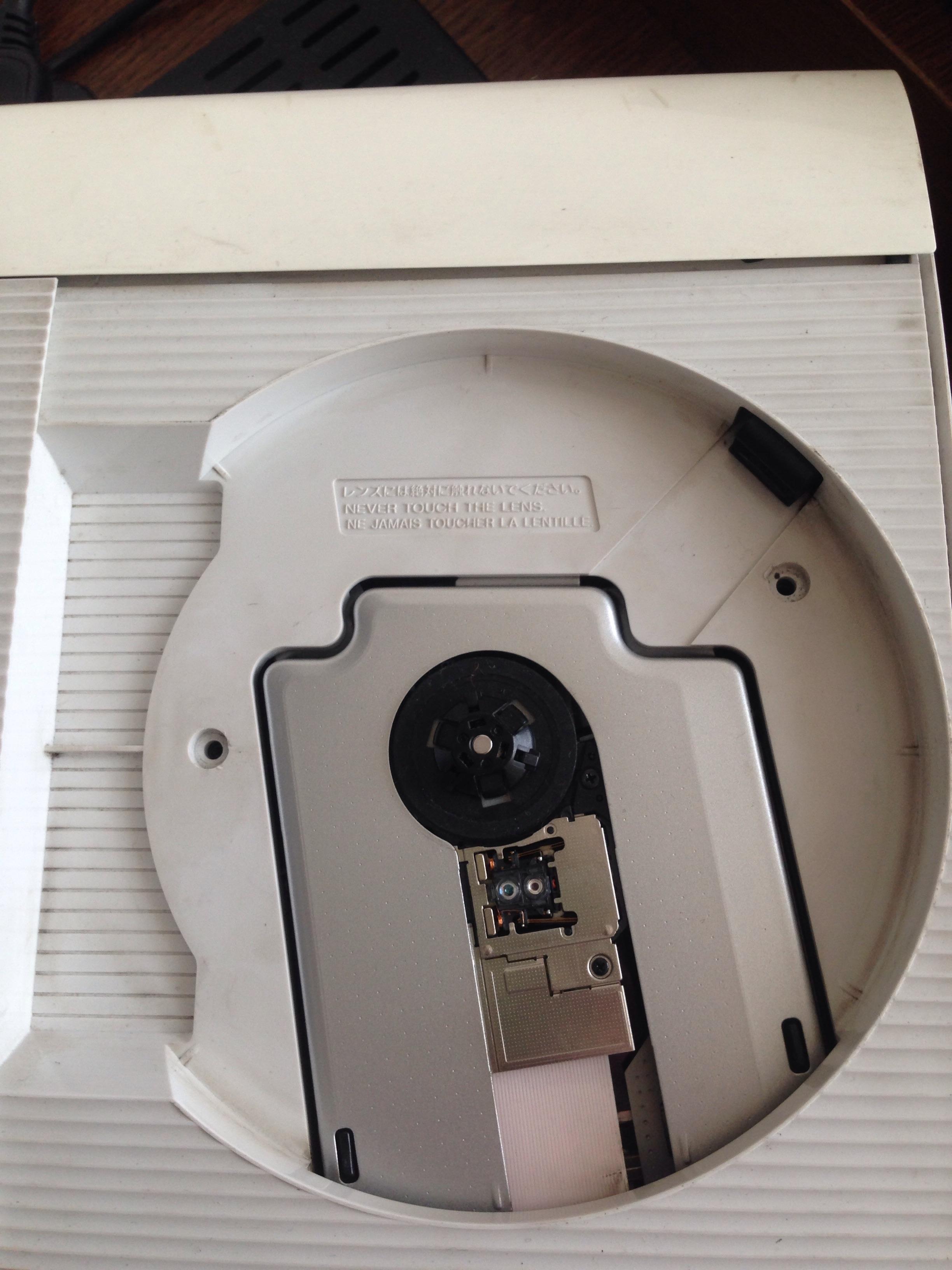

    Hello. I have a problem with the above mentioned ps3 console. After inserting the disc and closing the flap, the drive tries to read it for sure, because there is a hum but as if it is summoned, i.e. the moments will rumble and the pause will rumble again and pause, so three times shortly 3 the longest, then 4 times longer so that you could think that it would finally read but nothing. in the upper right corner it spins until you stop trying to read the CD, then it stops.
    I have already bought consoles with this problem with the intention to repair it, but I would like to rule out any minor faults before I start replacing the drive / laser.
    Ps. The console has probably already been dismantled because the two screws are missing under the plate (they are probably on the cushions, but their absence should probably not result in such an action). The flap opens and closes lame and it was rather dirty, because the 3 broken pads that I got with it after cleaning roast normally.
    Best regards and thanks in advance for any helpful information.

  • Manual check confirms laser movement and disc rotation on PS3 SuperSlim
    #5 16407526
    BleBleBleps3
    Posts: 10
    Ta how to check it? Honestly, I have never repaired ss and I'm green .. Faty happened to me and the power supply in the slimie was repaired after the instructions from the net ao super slimie not much written ..
    Added after 6 [minutes]:
    OK, I figured out how to check it :) I took off the bottom and top trim and pressed the latch from closing the flap and the disc gripper. The laser head moves up and down the plate also turns well for my eye .. If I succeed, I will post a video of how it goes

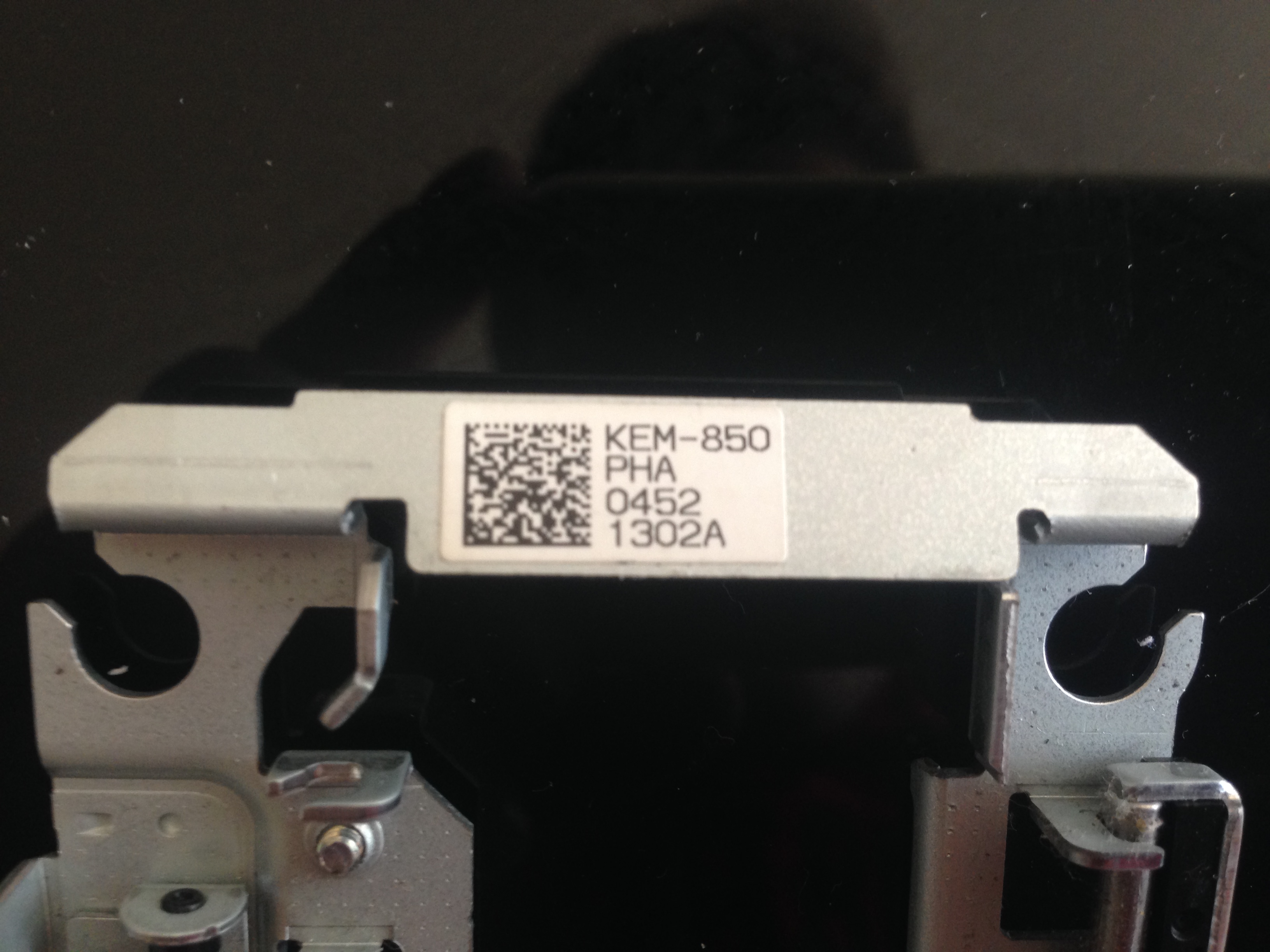

    #13 16410089
    sylweksylwina
    Posts: 13216
    Help: 1882
    Rate: 2355
    I do not know if it will come up, compare the markings of the laser mechanism / head.

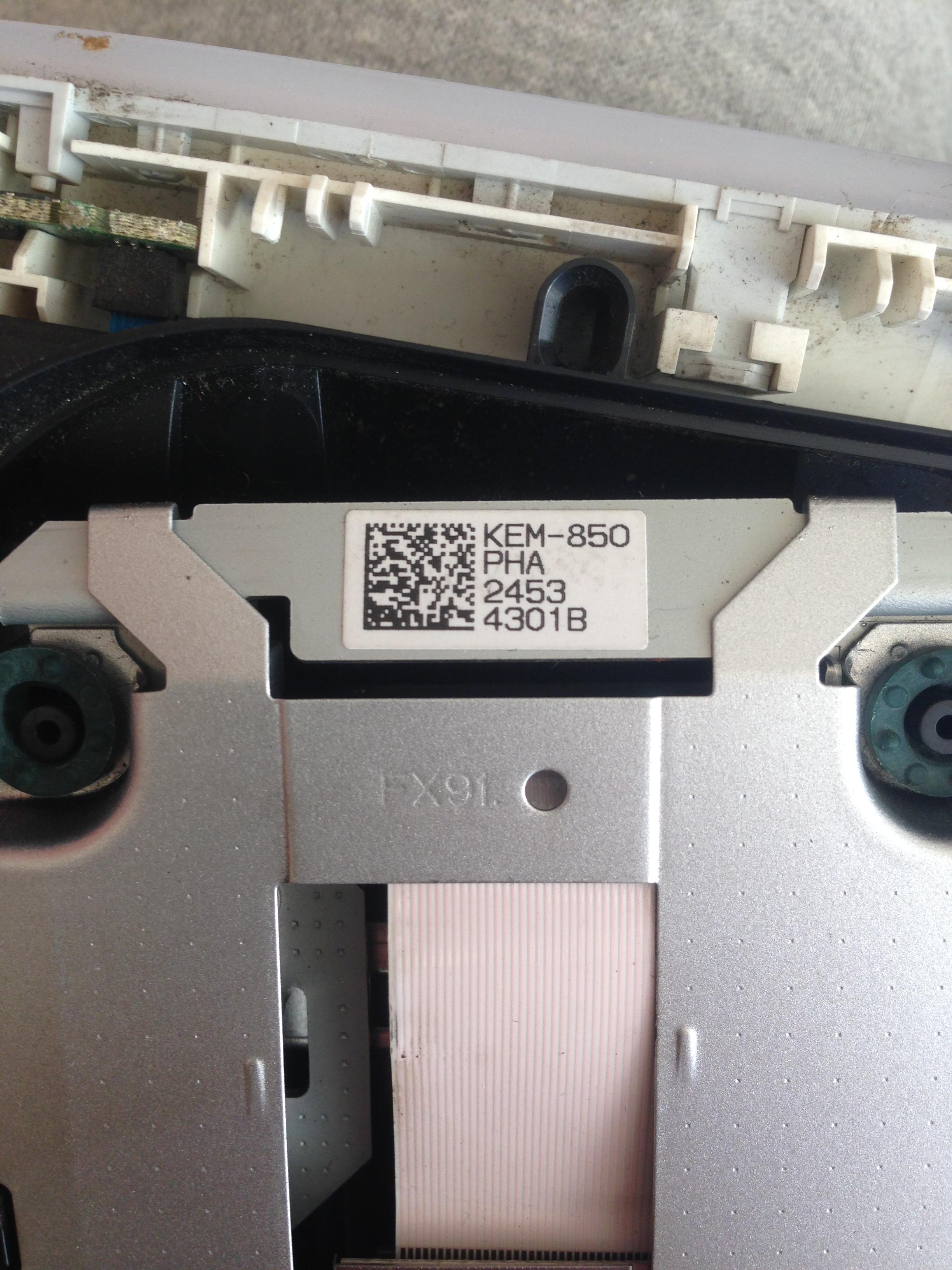

  • #14 16410101
    BleBleBleps3
    Posts: 10
    I am about to disassemble mine and check because I have a drive for a good price.
    Ps. I have now uploaded the movie on DVD and it is reading from the arrow
    Added after 22 [minutes]:
    Hell, it has a little different markings .. Better not to risk it, right?

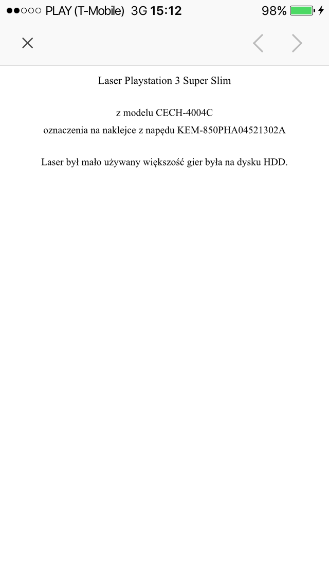

  • #15 16410171
    BleBleBleps3
    Posts: 10
    From what I read at auctions with lasers, they sell lasers with the designation kem-850 .. So the laser, at most, the same drive can be different, then I will switch it. Once a goat's death for PLN 70 I can buy the entire drive.
  • #16 16410922
    sylweksylwina
    Posts: 13216
    Help: 1882
    Rate: 2355
    KEM-850PHA is like the same designation.

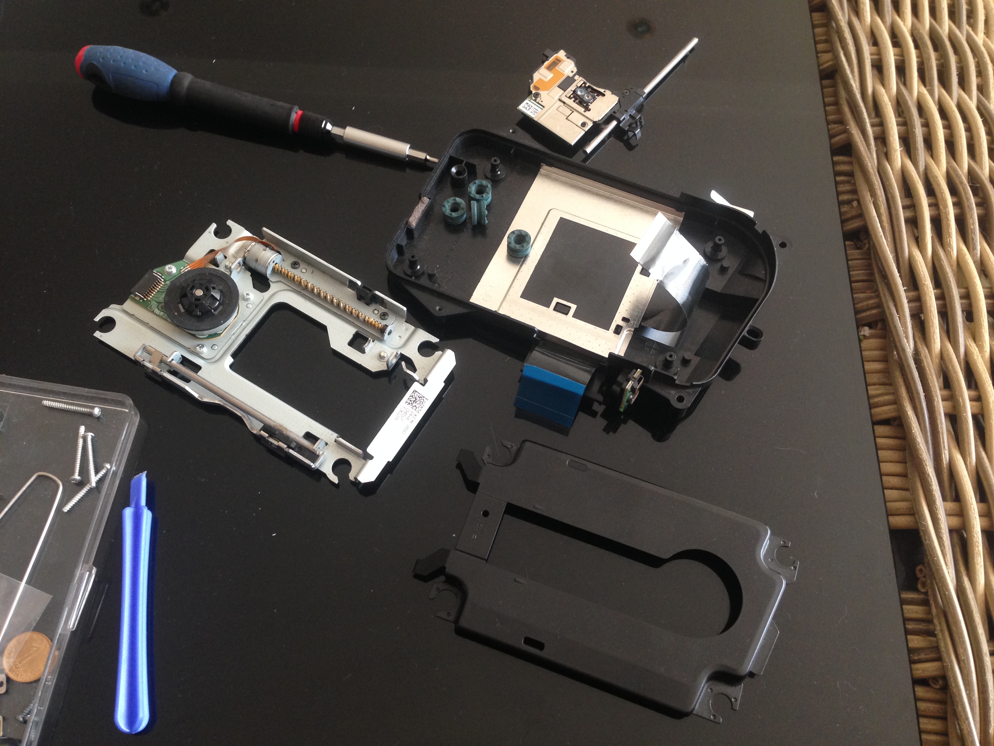

  • #17 16426534
    BleBleBleps3
    Posts: 10
    Hello forum colleagues. If I do not praise it, it is as if the end of the topic is missing, so I write. The drive has reached me today, according to the photo the markings were a bit different but the laser model itself was the same.
    So first I put the entire purchased drive for a test, but the system did not start it (the same situation as in facie when you insert a drive from another console model because I have already processed).
    I assumed that this is how it may be, so I opened the console once again, I threw the laser from the drive I bought to mine and the console is like bad :) So successful investment!
    If someone, for example, needed a drive marked as in the picture or some part of this drive, feel free to write, I will give it back for a small amount of money. The 99% drive is Ok because it was bought from a person who had a console with a dead gba. Dumpster laser (only reads DVD) but put in place.
