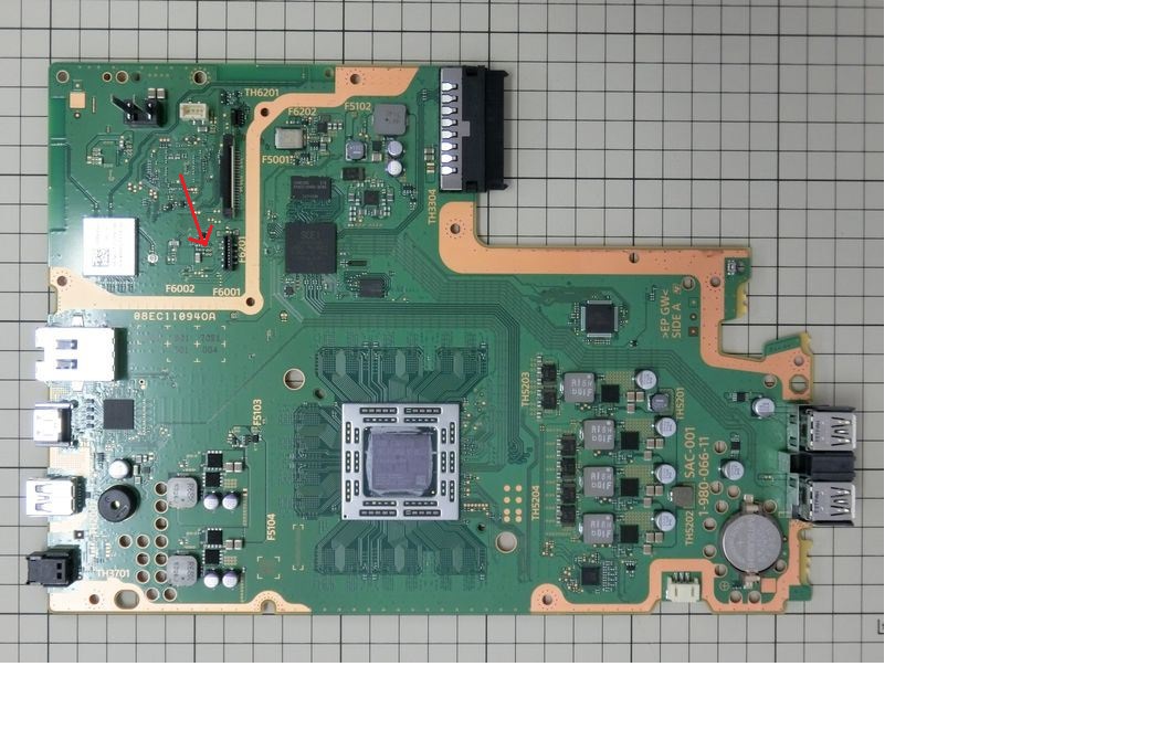

    I have a problem with the PS4 model 1216, as you know, the drive has no logic, it is paired with the motherboard and the problem is that there is no reaction to inserting the disc, etc., only 3 beeps when pressing the EJECT button.
    Besides, no reaction - dead.
    Does anyone know what is causing this?

    Hello! To check the drive motor and the BD7764MUV driver on the motherboard, see R330 next to it and the fuse on the other side of the board.

    Hello, the drive motors are definitely working, when the console came, the drive was strange, it had problems with going full speed and did not want to read games, I checked on 3 lasers because I thought it was laser wine ... in the laser
    I will check and let you know
    Added after 1 [hours] 17 [minutes]:
    I replaced the fuse and I still do not suspect that: BD7764MUV is damaged or the drive nand itself

    Hello. If the fuse was blown, the BD7764MUV may be damaged.

    I already know what it is, the fault was; the fuse on the motherboard is damaged, check the fuses for this type of fault.

    Does anyone have a diagram or photos where to look for these fuses from the drive?

    This is the 1216 cuch model? Because if, as in the topic, you have fuses here and check before inserting the Renaissance chip (drive logic) whether it is hot or not, insert the disc and check if it sometimes does not get hot?

    Unscrew the black cover that is and under it you will have the chips from the drive control and then check how I wrote to you if they are not warm before inserting the disc and when inserting, but first check the fuses

    The fuses are operational, the tapes have a transition, the systems are not heating up.

  • #16 19241399
    SolderStation112
    Posts: 8
    Hello, already solved, the fuse f6202 turned out to be wrong at the beginning and it shunted me
    best regards
