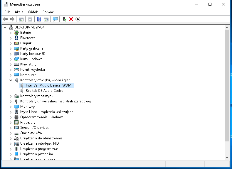

    I have a 2-in-1 laptop, more precisely Acre Switch 10E, unfortunately I had to reinstall it (the system restore option was damaged) after installing the system, uploading updates and drivers, there is a complete lack of sound. Device manager shows the installed driver on the bar there is an icon with volume control when I turn on "playback devices" in the speaker properties after clicking test there is no sound and it is not possible to change the frequency
    What system?
    Post a screen from the device manager.
  • #3 16407664
    blobek5
    Posts: 8
    System Windows 10 Home 32-bit

    Which device do you have set as your default audio output device?
  • #5 16408328
    blobek5
    Posts: 8
    Intel SST Audio Device (WDM)
    And that's all I can choose from

    Where did you download the drivers? From Intel and Realtek?
    You have (Platform Drivers Intel_1.0.0.1064_W10x86_A.zip) installed -> http://global-download.acer.com/GDFiles/Drive...=63578054280859&Stacerid=6357805428085=3899&T = ASPIRE% 20SWITCH% 2010 & Step3 = SW5-012 & OS = ALL & LC = en & BC = ACER & SC = PA_6?
  • #7 16408587
    blobek5
    Posts: 8
    I downloaded the drivers from the website with drivers for this particular model. It did nothing.
    Now I installed what you sent and it works.
    Thanks for the help.
