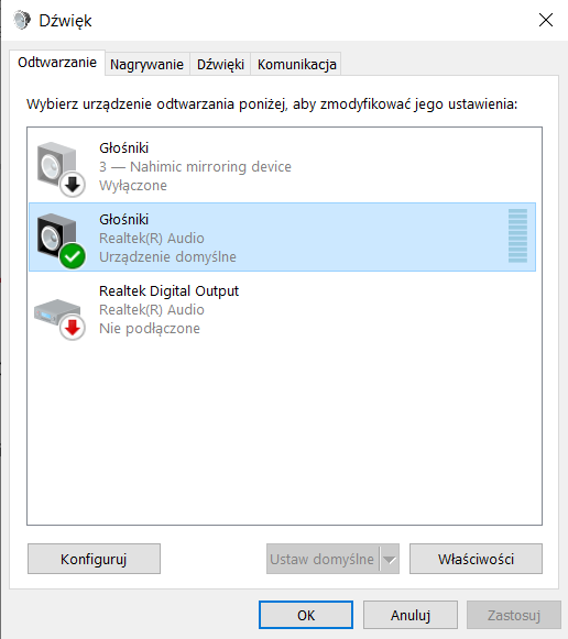

    I have a problem with the sound on my laptop. Well, something like a Nahimic mirror device appeared for me, which was not there before. Only it captures the sound but does not play that sound on the speakers. The problem appeared suddenly - yesterday everything was working fine. I tried uninstalling the mirror device but that didn't help. Realtek doesn't play sound at all. I tried to download drivers, nothing helped. I read on the forums that it could be a bios problem. What could be the solutions to this problem?
    I am a layman in these matters, so I would like to ask for understanding and clear steps to solve this problem.
    Recently I started using usb headphones but I don't know if it has any effect. There is sound on the headphones.
    Please help me quickly.

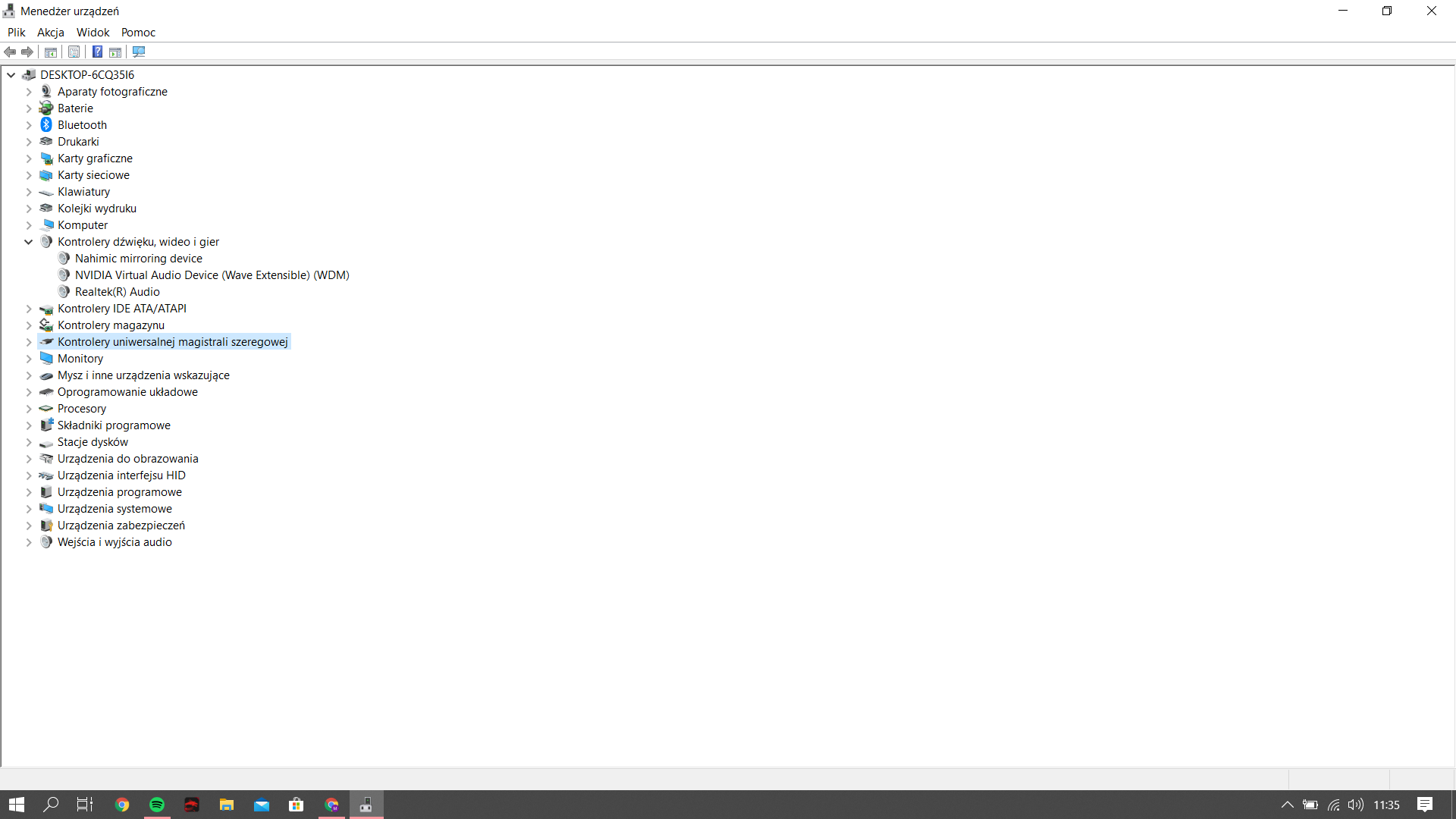

    First, show a screenshot of device manager.
  • #3 18590477
    Kucu123
    Posts: 14
    Rate: 8
    MSI GV62 8RE Laptop: Sudden Loss of Sound, Nahimic Mirror Device & Realtek Driver Issues
    Every restart of the computer Nahimic mirror device appears despite uninstalling it before.

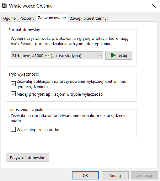

  • #7 18590512
    Kucu123
    Posts: 14
    Rate: 8
    I think I found a solution to the problem
    Sound enhancement was on, I hadn't noticed it before. The sound came back and realtek started picking up the sound. I do not know how it turned on and where the Nahimic mirror device came from. I've been using the headphones for over a week now and nothing like this has happened.

  • #9 18594015
    Kucu123
    Posts: 14
    Rate: 8
    Hello, in the properties of the speakers from the Sound Control Panel, the Advanced tab, sound enhancement was turned on.
    In the device manager, I turned off the nahimic mirror device or uninstalled it (but it reappeared every time the laptop was restarted), I also uploaded the latest realtek drivers.
    At the very end I noticed what I wrote above about "sound enhancement" and the sound automatically came back. I don't know if this effect was caused by just that, that's why I wrote you everything I did.

    saszul
    It's already done for me. I was a bit confused because I didn't have this "signal improvement" option. There was no option in the window at all. I don't know exactly what helped. I definitely updated windows via windows update, I removed the realtek and nahimic drivers (control panel->applications->programs and functions). I removed the nahimic and realtek audio console from the programs. I installed the realtek drivers. I still have no sound. Next, I took the audio troubleshooting. I was asked if I should go into sound enhancements to turn it off. I went into it and this time the option showed up like my friend Kucu123 (as in the photo he attached. I unchecked this option and the sound came back. I also had a problem because this option was not there. I do not know exactly what I did to make it appear. thanks to Kucu123 because unchecking this option was crucial. I would like to add that I stopped installing nahimic. Previously, after each reboot, the driver was installing itself. Regards
