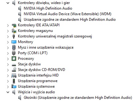

    Hello, I suddenly had a problem with the sound on my system because on some pages after maximizing the movie screen or in the games menu, the sound creaks and cuts. Suddenly there were two the same installed sound system drivers, if I remove them they install themselves as one of them turns off it also doesn't change anything. I also installed motherboard sound drivers (Realtek) also some sound driver from the Nividia graphics card and it still doesn't change anything. I have no idea what could have happened ...
    Sound Problem with Windows 10: Creaks & Cuts in Movies/Games - Realtek, NVIDIA, ASUS M5A78L-M LX3
    My computer:
    - Windows 10 Pro 64 bit
    - ASUS M5A78L-M LX3 motherboard
    - ASUS GEFORCE 950 GTX Strix graphics card
    - Goodram RAM 8GB DDR3 1600MHz CL11 memory
    - AMD FX-4300 Quad Core 3.8 GHz AM3 + processor
    - Thermaltake Smart 530 W Modular power supply
    - Gigabyte Poseidon Chassis housing (3 fans 120mm front rear side)
    - Toshiba 1 TB drive
    Nothing installs itself. You don't agree and that's it.
    Delete these drivers. Both. Reset the computer and do not agree to the automatic installation.
    Install the Audio driver:
    https://www.asus.com/pl/Motherboards/M5A78LM_LX3/HelpDesk_Download/
    If they still crash, use bootable linux.
    Clicks under linux will mean that the audio system is damaged.

  • Realtek ALC887 driver reinstall did not fix crackling
    #6 16645673
    haslo14
    Posts: 88
    Rate: 10
    The sound card is integrated into the motherboard Realtek ALC887 . Unfortunately, I only have a CD with drivers for Windows 7, the manufacturer's website for Windows 10 is just an audio driver (Realtek). But as I wrote above, I installed it, but still the same. It still occurs as in the picture above "The device complies with the High Definition Audio standard" and double, even if it uninstalls it appears by itself. By installing the Realtek or Nvidi audio driver, it replaces one of these two, i.e. Sound Problem with Windows 10: Creaks & Cuts in Movies/Games - Realtek, NVIDIA, ASUS M5A78L-M LX3 and then nothing changes in improving the sound :|

  • Realtek and Nvidia drivers did not fix audio cuts
    #12 16646482
    haslo14
    Posts: 88
    Rate: 10
    @ safbot1st I was also checking the registry using the command line sfc / scannow . And what about booting Linux I don't know much about it. I will also think about removing the last update. Maybe it's the fault of the new version of Adobe Flash Player?
    @witoj I installed the Realtek and Nvidia drivers simultaneously, the High Definition Audio compliant device has disappeared Sound Problem with Windows 10: Creaks & Cuts in Movies/Games - Realtek, NVIDIA, ASUS M5A78L-M LX3 but the sound problem remained.

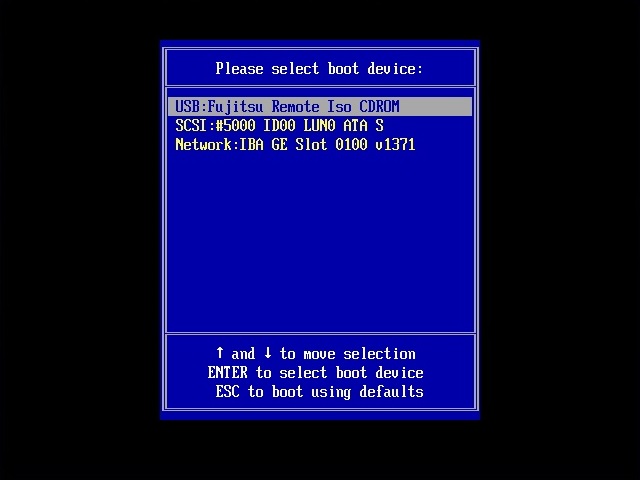

  • Boot Linux from USB to test for crackling audio
    #13 16646596
    safbot1st
    Posts: 21951
    Help: 2719
    Rate: 1585
    Download Rufus:
    http://www.programosy.pl/download/pobierz,rufus,2.html
    Download linux puppy image, it's only 250MB:
    http://distro.ibiblio.org/puppylinux/puppy-tahr/iso/tahrpup%20-6.0-CE/tahr-6.0.5_noPAE.iso
    Turn on Rufus, point the linux ISO image under the ISO button, click Start.
    Finally, all you need to do is restart your PC and press F8 to start to bring up the Boot Menu:
    and choose a flash drive from the list:
    Check e.g. on youtube, or play some MP3 / AVI.
    Record a sample of "crackling" sound and sweep it.
  • #14 16646781
    haslo14
    Posts: 88
    Rate: 10
    It doesn't creak on Linux. And this is how it looks on Windows only when it maximizes the movie window or in the games menu. http://www12.zippyshare.com/v/wjzMcNL6/file.html maybe it's something with a flash? For example, youtube, only games or mp3, mp4, avi normally plays for me.
