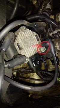

    The coil looks like this: (I will add that when I sprayed the windscreen liquid around the coil and cables, you could see the spark that jumped from the cable to the coil in the marked place. Before replacing the cables there was also sparking even as I put other cables in. Only it was in a larger or to a lesser extent) - this refers to cylinder no. 4 (rightmost engine viewed from the front of the car)
    VW Polo 3 1.4 MPI - The engine works on 3 cylinders (Check engine mryga)

    Poor quality cables.
    You have an open circuit between the coil and the engine control unit.
    Check the wires and plug to the coil.
    The motor driver pins that control the coil are 57 and 71. Check their continuity using a 55W bulb.

    Coil rather for replacement in a set with branded cables. If it strikes directly from the spark exit terminal, it will always be there, the discharge leaves a burnt path on the surface of the coil and it will shoot like this.

    Replacing the set is effective.
