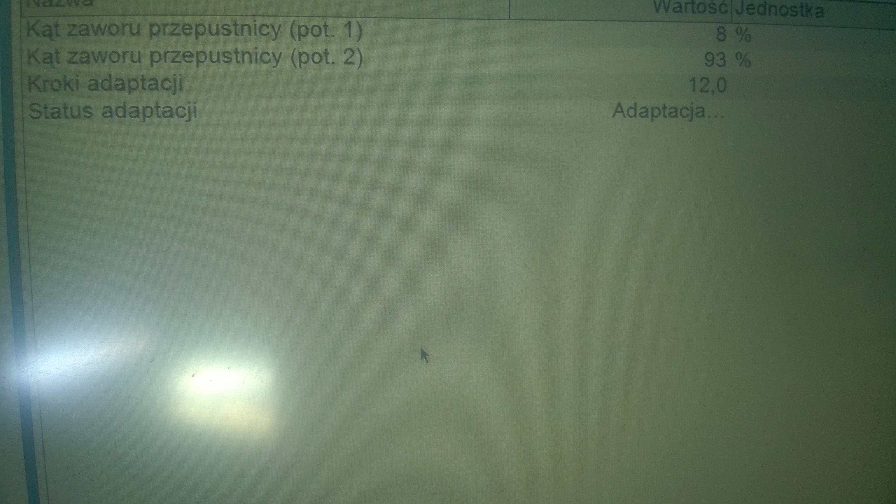

    VW Polo 1.4 16V 2002 74ps.
    ECU was detachable, now the engine does not start the starter turns.
    There are no errors in the immobilizer.
    EPC error and engine error are displayed.
    The engine controller throws error 17812 - exhaust gas recirculation system, no basic settings have been made.
    The adaptation of EGR and EGR system fails with Autocom.
    I tried to do the throttle adaptation but it stands still in the picture and nothing goes on.
    What can be the reason for not starting the engine, because without EGR adaptation the engine should start? ...

    Check what is missing, injections give fuel, the spark is there?

    I removed the candles and from what I see there is no fuel and no electricity on the candles.

    Have you checked the fuses? The term "there is no electricity" makes little difference. The question is whether there is no power or injection or coil?

    The problem was on the immobilizer side, although the error was not displayed.
    I mean, it displayed an error but only after a long starter shooting.
    I had to read the PIN and adjust the ECU.

    Everything is described on the VCDS manufacturer's website.
