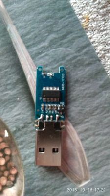

    Hello, my flash drive does not work - it has write protection, and now it does not detect it at all:

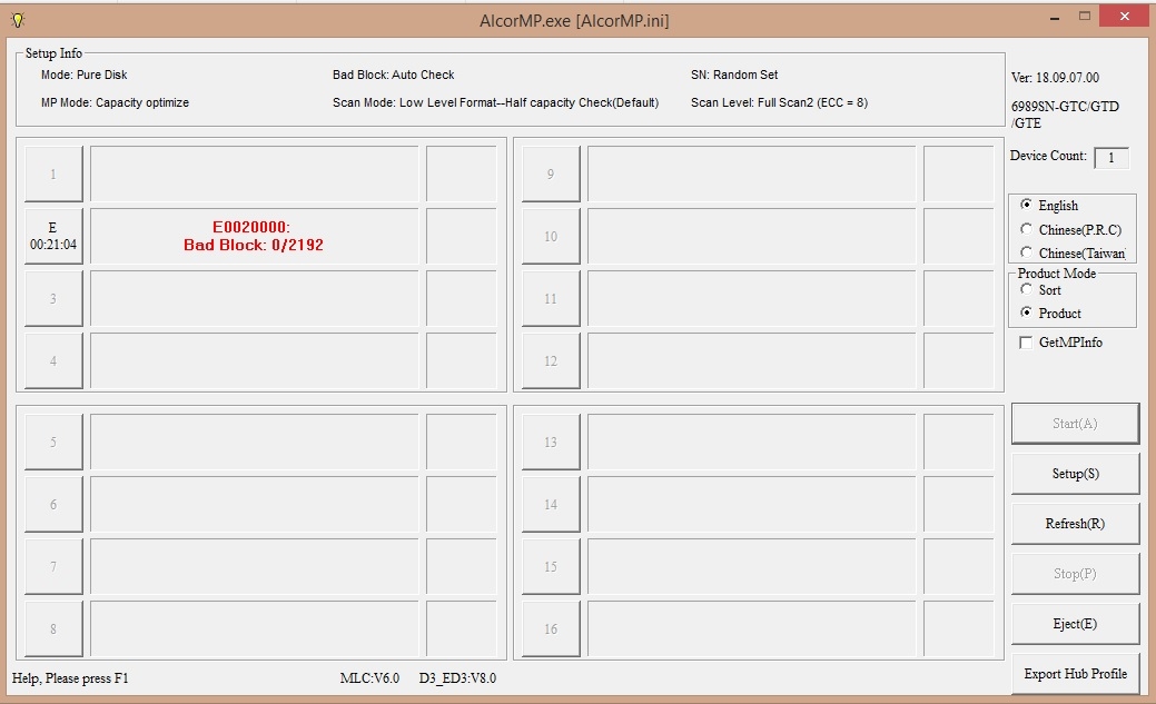

    Most alcor programs don't see it at all - only the version saw it
    ALCOR_U2_MP_v17.07.11.00_L06B
    AlcorDSMP_18.06.13.01
    ALCOR_U2_MP_v18.09.07.00
    However, any actions in this program end with an error - here are the standard settings:

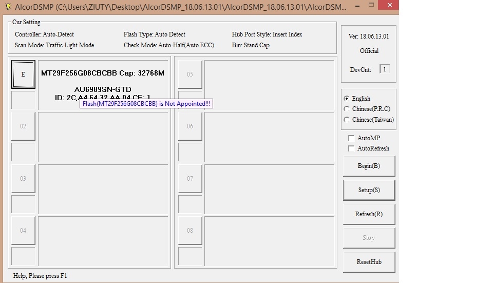

    on AlcorDSMP_18.06.13.01 it does not throw an error but it does not give anything

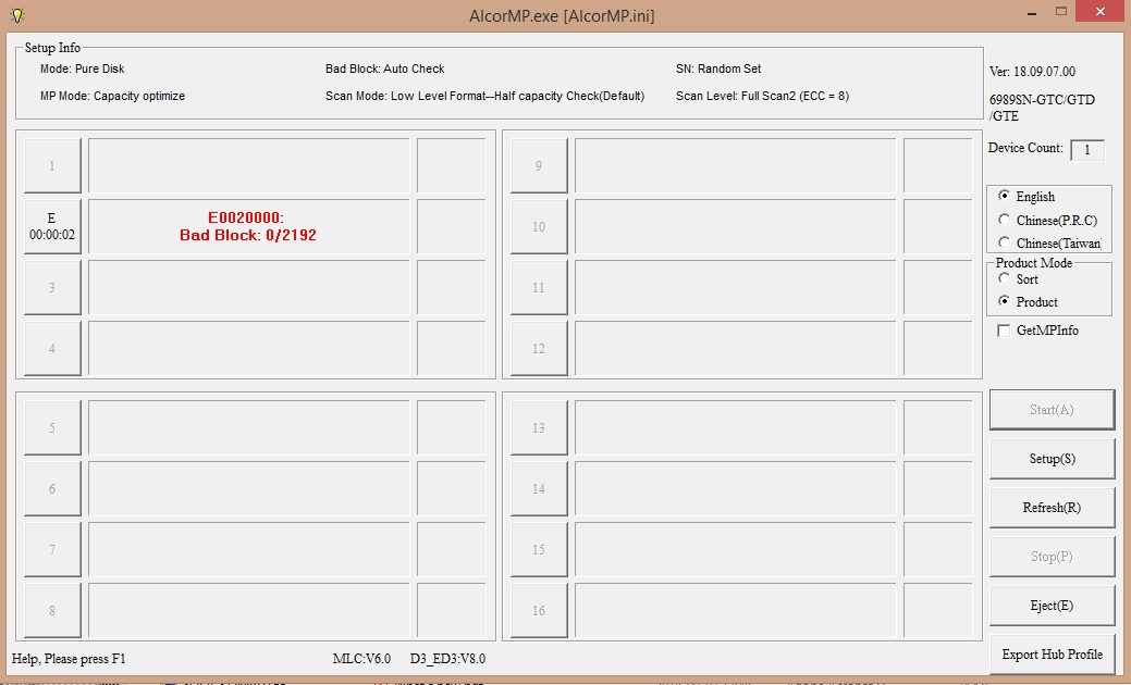

    Added after 29 [minutes]:
    With other settings, for example, it showed this error:
    Alcor 32GB Flash Drive: Write Protection, Undetected, USB Mass Storage Device, F700 Firmware
    In general, as I noticed, probably every error somewhere is related to an error on the firmware .... because there are stages where it works, something does, goes on and crashes the firmware error

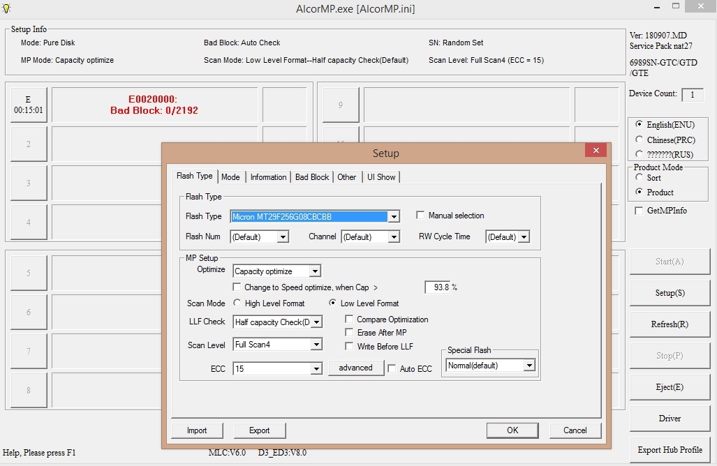

  • #6 17498971
    pidar
    Posts: 11363
    Help: 1569
    Rate: 3590

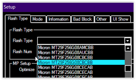

    Well, there is indeed a problem with the appropriate configuration of these tools for this memory (?) -> " Micron MLC 32G MT29F256G08CBCBB L06B 3D 1 ". :|
    This flash drive is in a metal case, non-detachable?
    Test again (?) by selecting this memory in settings, these tools (first the one from the attachment, possibly later the earlier version from the link):

  • #8 17505606
    melanchel
    Posts: 1317
    Help: 154
    Rate: 380
    Ustaw LLF na Half capacity Check(Default), ECC – 15 i Full Scan 4.
  • #9 17505887
    ziuty3570
    Rate: 24
    the same ... in every setting, which I would not set to low level format, it ends with the same error as on the screen, on HLV a different error pops up on earlier screens and ends with a strange capacity of the pendrive after removing and reinserting it into the usb port - then the disk is active (it goes online in disk management but you can't do anything with it because write protection errors also pop up.
