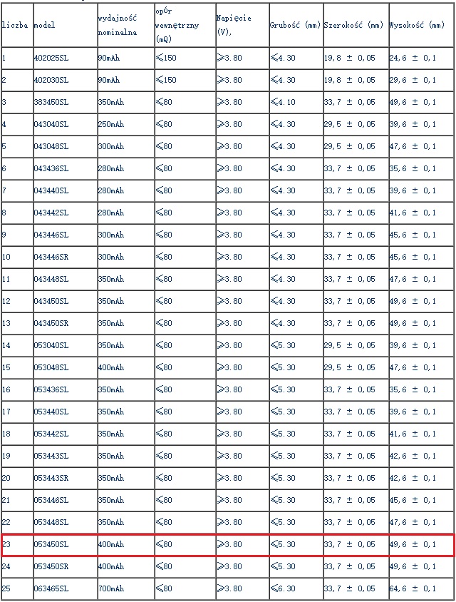

    This is the only thing that I managed to extract from the Chinese sites.
     Replacing Li-ion Battery in Forever BS-330 BT Speaker Clone - Using Siemens C75 Battery?
    I keep wondering about this voltage difference for both batteries, should I put a suitable resistor there, which will reduce my charging by 0.1V? I guess it would not work, because how to notify the system that it is to charge the battery until it encounters a lower maximum voltage, and not what is set.

    @sebuli. I have not yet come across a 3.8V Li-ion battery. From what I could find it " Model Number: 053450sr; Type: li-ion; Nominal Voltage: 3.7v "so the same tension.
    Greetings.

    sebuli
    Posts: 20
    Hmm, I understand, I am only surprised that in google you can find these 3.8V batteries, e.g. some Samsung, although maybe fakes. Yesterday I tried to measure the current flowing from the cable that charges the battery to the battery plus, here I just plugged in with a multimeter and I do not know why, but the circuit did not work, so that my multimeter gave such resistance ...
