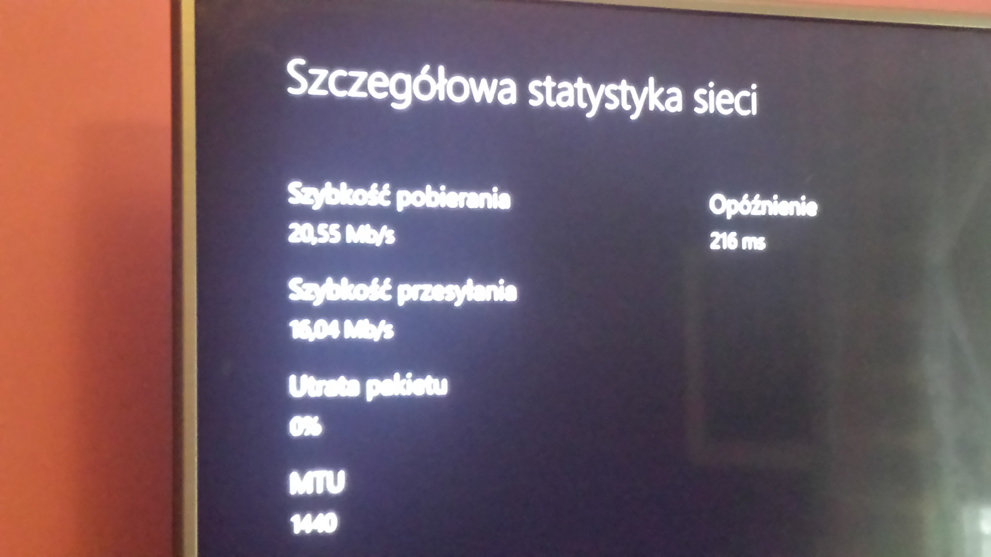

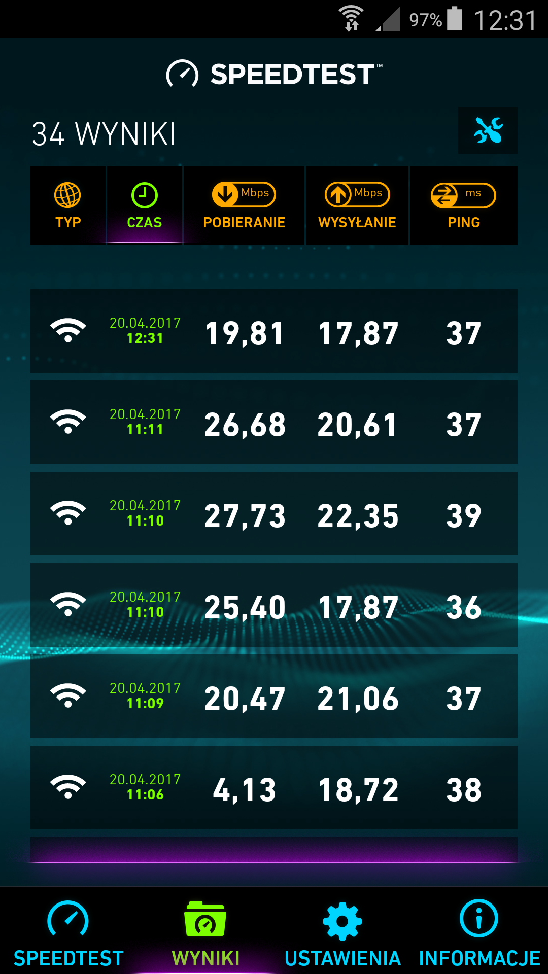

    Hello, I have such a problem "I think it is from the console" so yes, I have lte plus internet with a huawei b315 router tests for speedtest is DL 23mb / UL 20 / s ping 35. When I do tests on xbox in the network settings, I have similar parameters when it comes to downloading, but the delay is 210ms ..
    When playing online, the delay bar is 2 red lines sometimes 3 but the lag during the game is tragic. Anyone have an idea what to set or how to fix it? Screenshots of the tests are attached

  • #6 16424910
    Hoshi_Inu
    The ping displayed on the console is a ping from a server located in the US. (you will have a different ping on the console than in games). Try with other games if they have online as this is most likely a problem with EA servers.

    Sure, and there is some truth in this, they may have problems with the servers but my friend has a similar net lte and there is no lag, the game runs smoothly and after pressing the application there is lag and gives later. I even checked it offline and it's not very smooth game either. Now I don't know, it's probably partly the net-server or console's fault.
